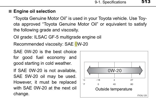

    The manual for my 5.7 FFV says 5,000 miles.
    It also says 0W20, with a clearly stated restriction:
    My Toyota Master Mechanic family member also says use what the manual states.
    I also live in the hot south west, and I think thicker oil would be better when it's 110 on the highway. But 0W20 works it seems.
