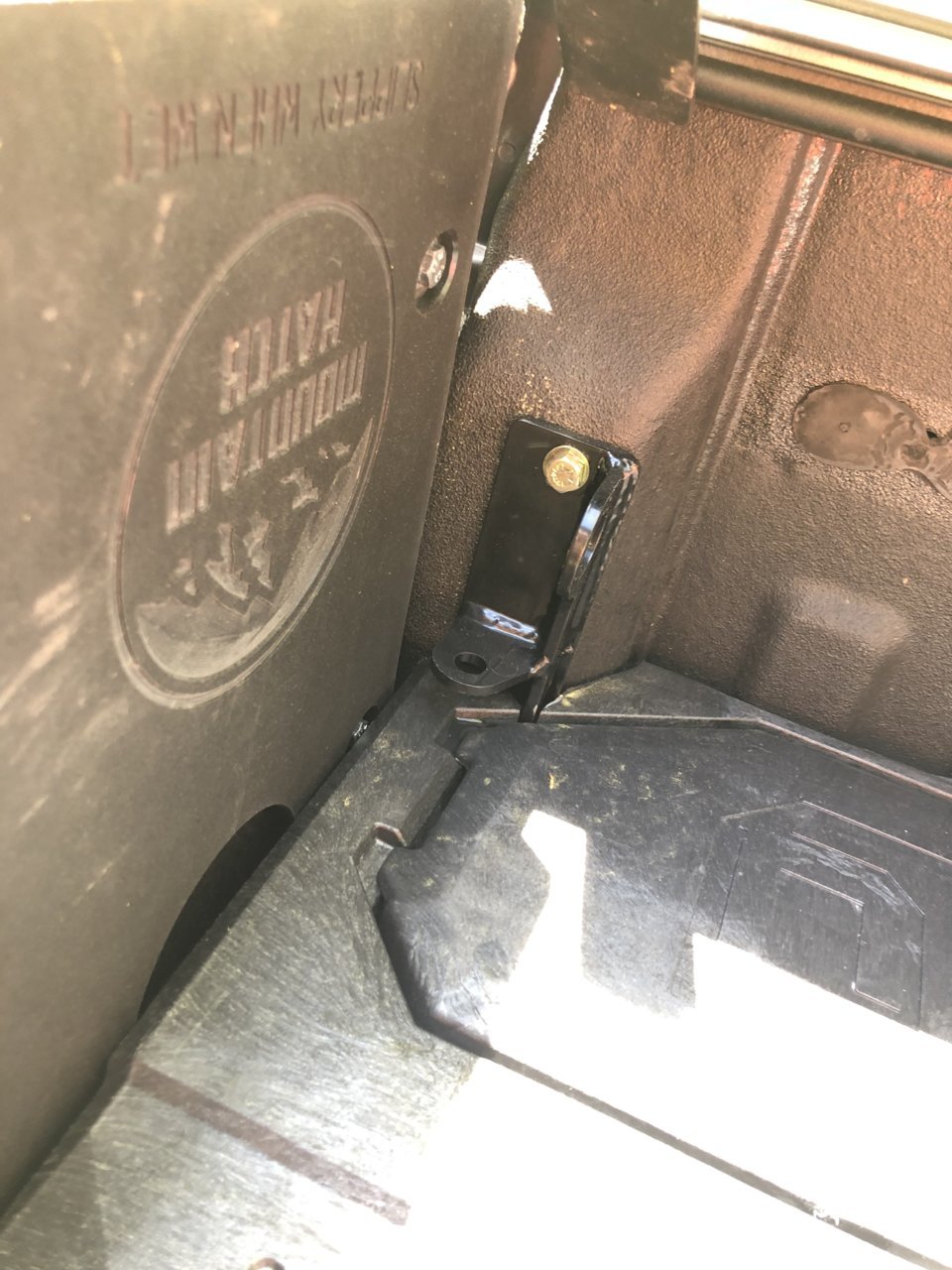

  25. May 3, 2021 at 6:46 AM
    #25
    Terndrerrr
    Terndrerrr 923000 miles to go
    Jul 8, 2019
    #32965
    6,169
    Music City
    6UR-FE
    If you’re using the TC as a tie-down point, does the MH clear strap hooks through the TC rings?
    I imagine the MH doesn’t clear the TC by much; just curious if there’s enough room to use ratchet straps on the TC without rubbing on the MH when the tailgate is closed.
  26. May 6, 2021 at 4:25 PM
    #26
    SwampThing
    SwampThing New Member
    Jun 28, 2020
    #48581
    127
    Yeah there’s room to use the hooks. The Mountain Hatch is close to the Decked system and TC stiffeners, but the hooks are set forward.
    Terndrerrr[QUOTED] likes this.

    Not sure why it’s not letting me add the picture to my post above.upload_2021-5-6_19-28-17.jpg

  28. May 6, 2021 at 4:34 PM
    #28
    pandapro
    pandapro New Member
    Dec 2, 2020
    #55589
    303
    Wow your MH is pretty much butted up against the decked huh?
  29. May 6, 2021 at 4:36 PM
    #29
    SwampThing
    Jun 28, 2020
    #48581
    127
    Yeah that’s why I was surprised @Mallcrl had so much room. Mine is butted up against the front of the bed too.
