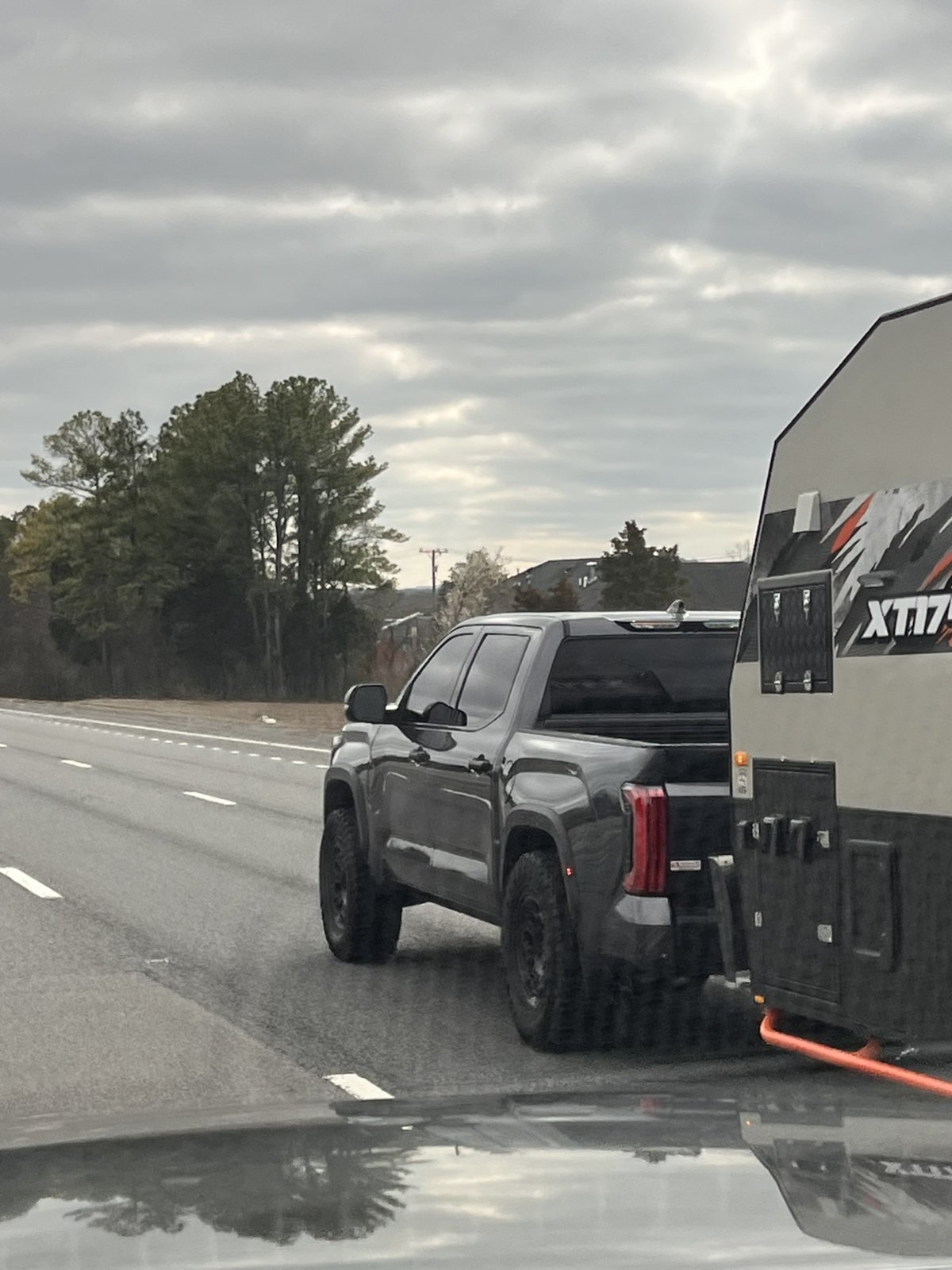

    Welp that answers that question... The TRD Pro is my favorite Tundra minus the 5.5 bed.

    Pro's are sweet. Not the best towing setup though.
    Cpl_Punishment and Bgoodman4[OP] like this.

    Lots of stuff!
    A set of airbags will fix up that Pro.
    Bgoodman4[OP] likes this.
