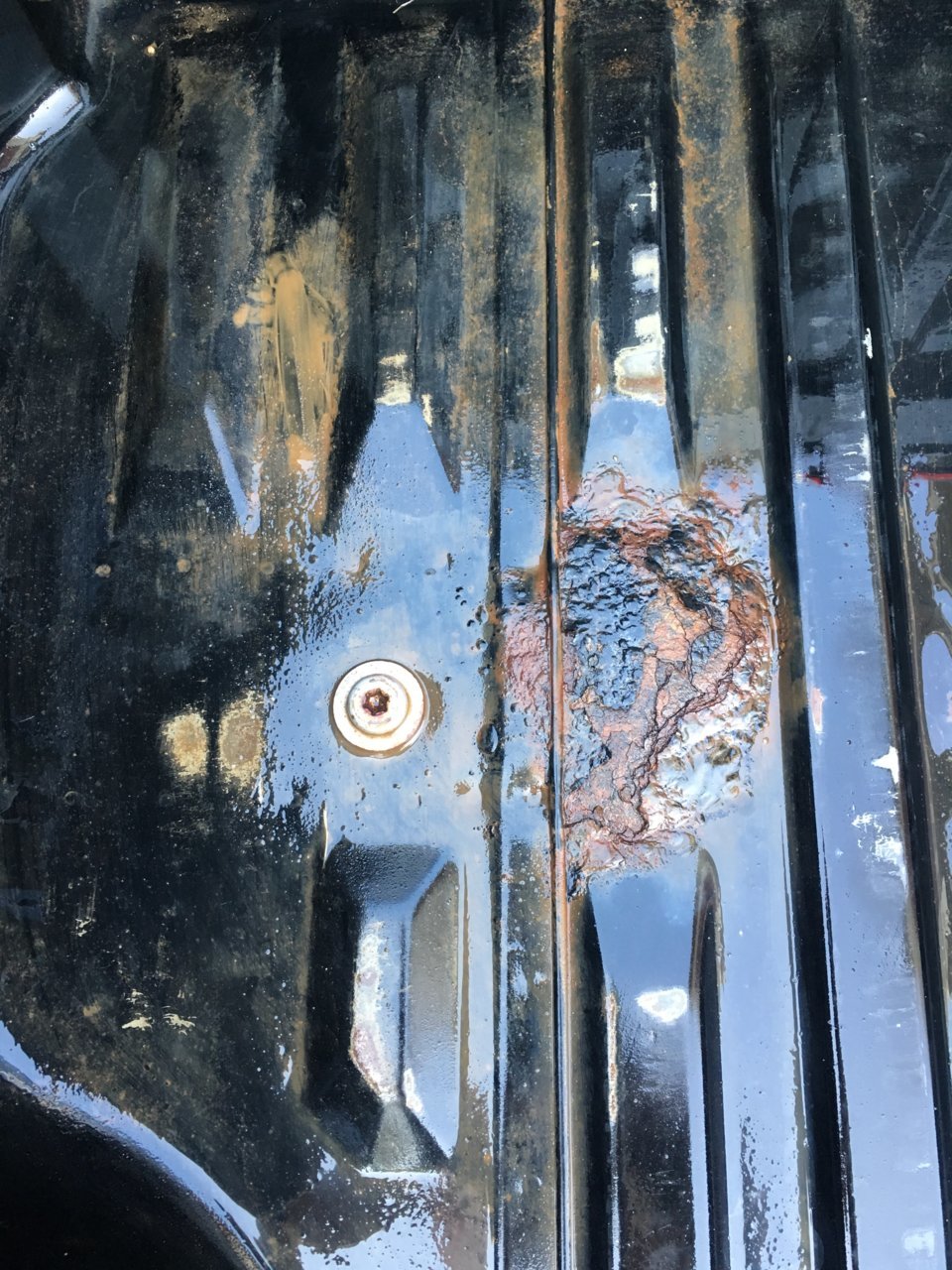

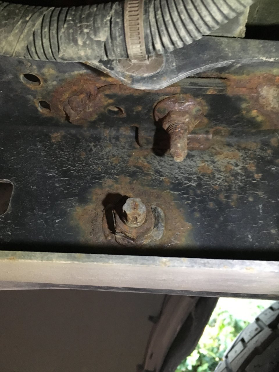

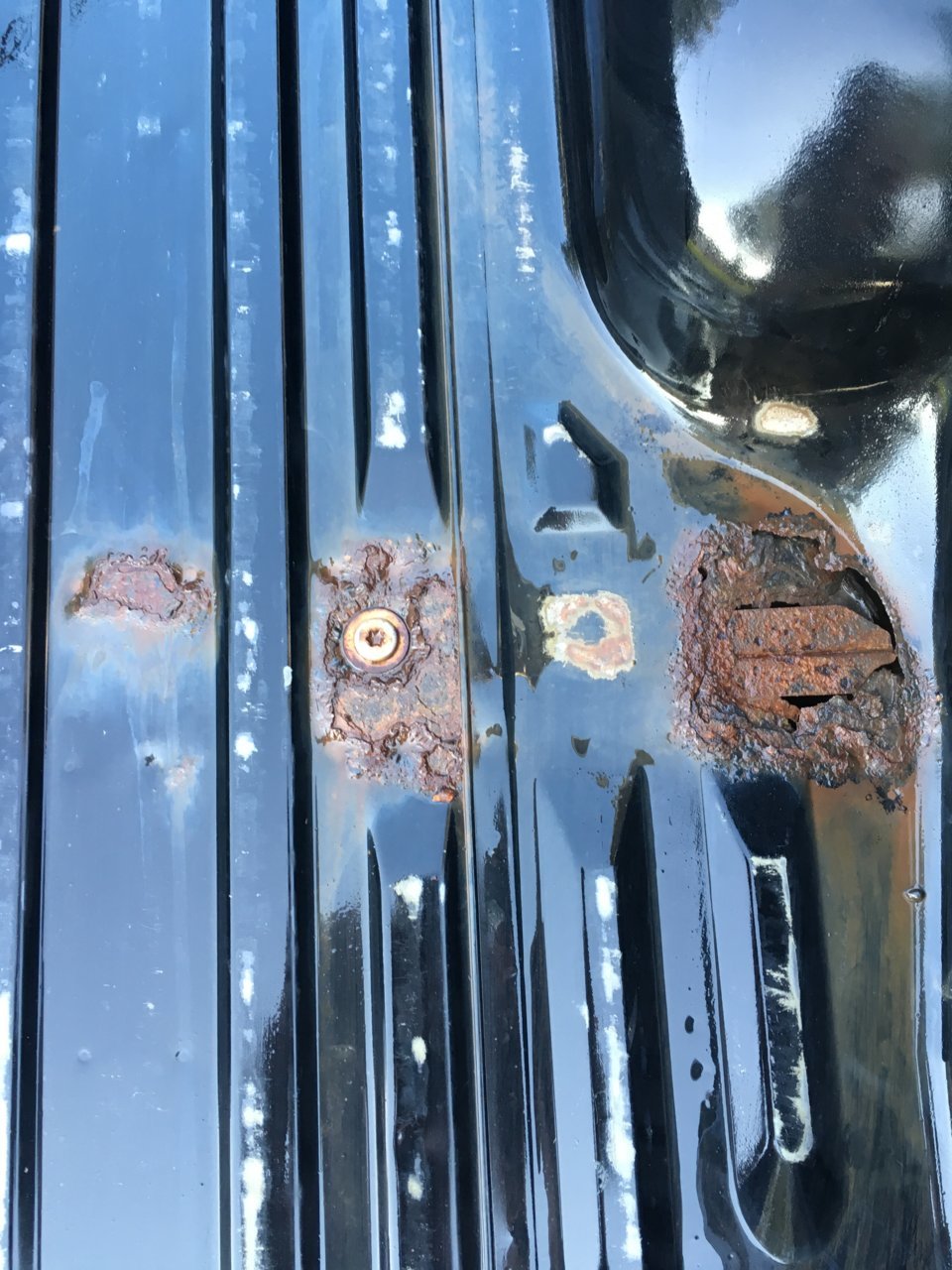

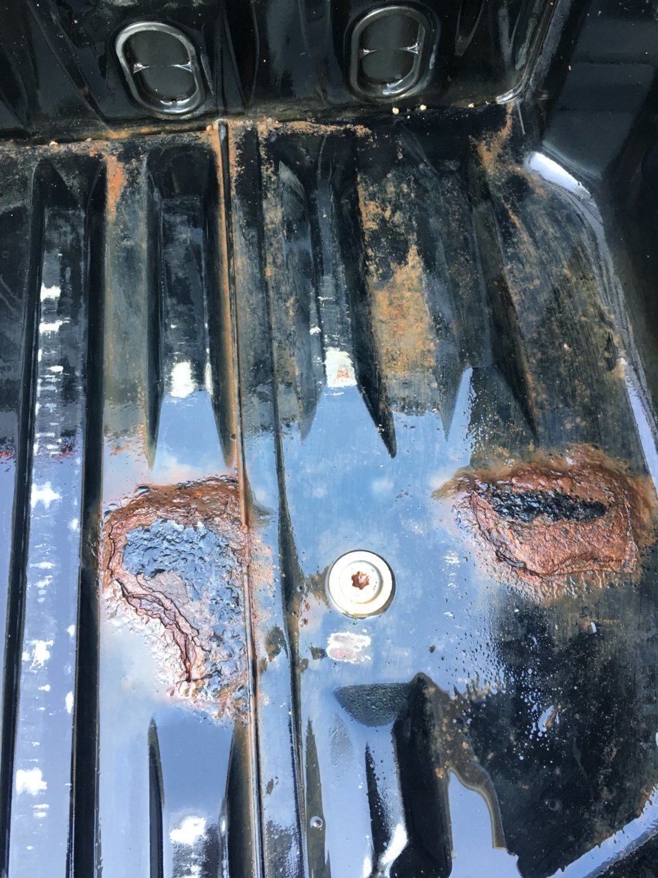

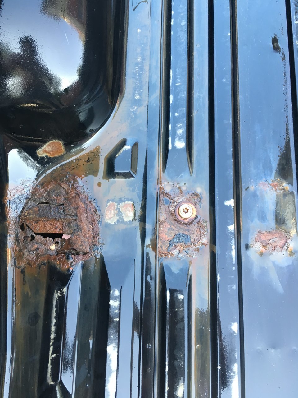

    You guys got my curiosity piqued over this, so after work I removed by liner. This does not look good. The cross supports under the bed are pretty eaten up. Has anyone seen a bed like this be fixed?

    I would get sanding and see what your dealing with, I definitely see those two holes for sure are going to have to be patched.

    Did the body shop check out your frame? You may have more severe issues underneath.

    One thing is for certain. Those plastic bed liners are bad news. I hope other people see this and get rid of them ASAP.

    I had no idea before I bought my tundra. I remember thinking 'alright it has a bed liner, I shouldn't have any problems with rust.' but surely that's been rotting for years by now.

    Get a hammer and chisel out and verify how much is perforated.

    I agree with @landphil The two holes in the rear of the bed will definitely have to be patched, but the cross beams visible from the top are not in bad shape; the driver side has a little more pitting, but from what the pics show, that will not materially affect strength.
    Take a portable grinder (30 grit disc) to the other areas not rusted completely through. If there's good steel left after rust is gone, then those areas may not have to be patched. It's quite possible you may grind through an area before the rust cleans up. If that happens, cut out rusted area to full metal thickness and patch.

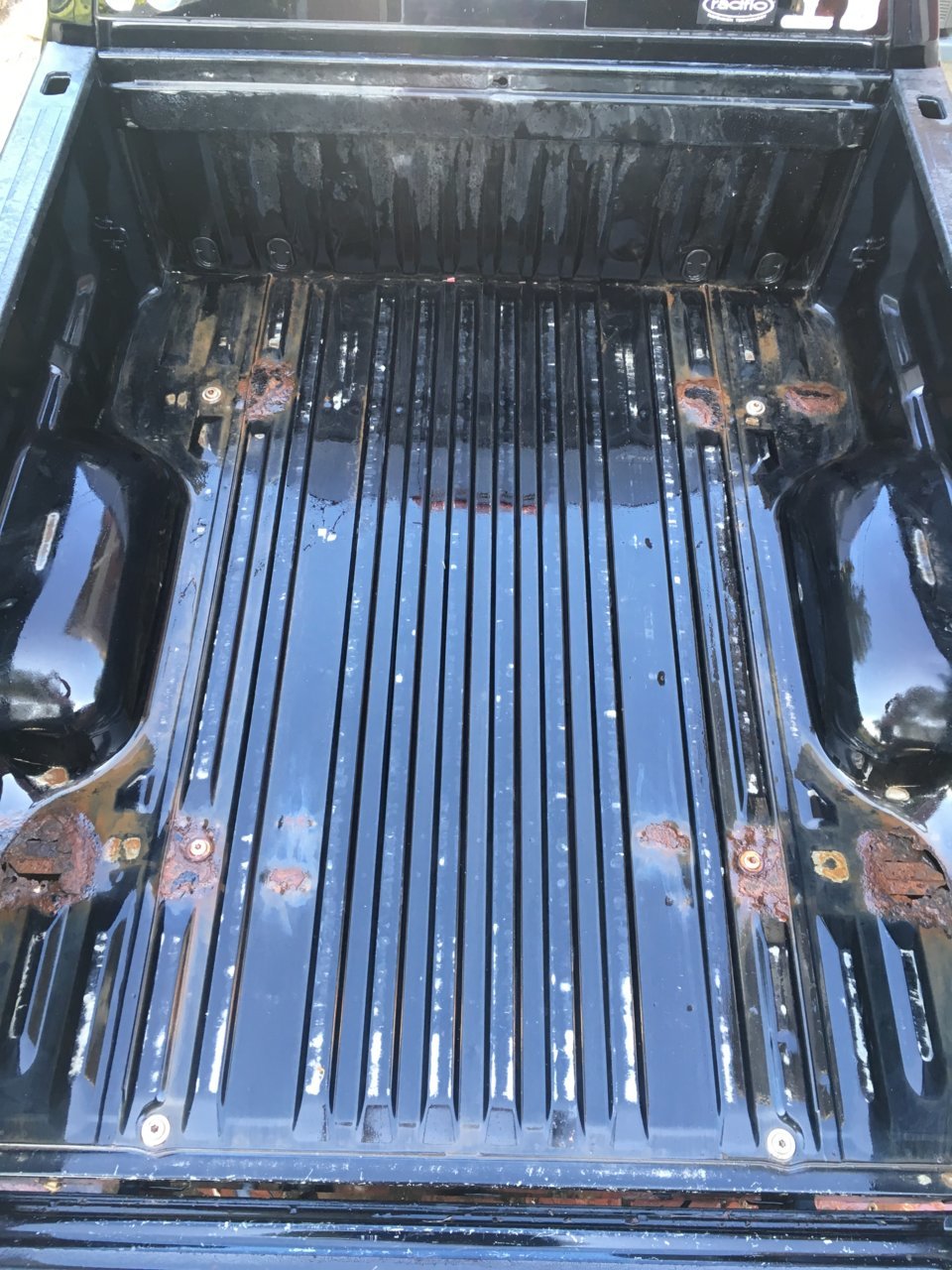

    Last year, I had it checked out by my regular shop, who said that for a nine year old truck it was pretty solid. The frame hasn't gotten any worse since then, but I noticed the condition under the bed bolts where I've got some bad bed rust looks like this. This is the worst rust I have on my frame.

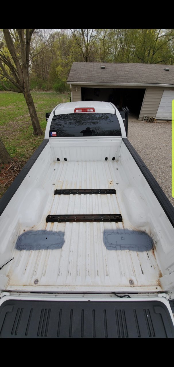

    Here is a pic of mine now. Is the rust gone ? For now.. Am I happy with the repair the body guy did ? No. That's kinda where I'm at with it now. Screenshot_20190820-075156_Gallery.jpg

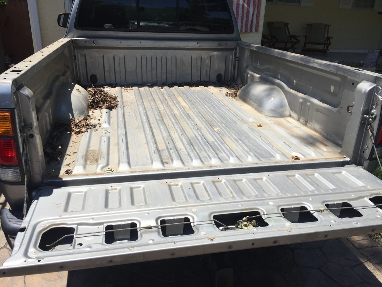

    Removed the plastic liner for the first time in 17 years to find leaves and mulch.
    Cleaned things up and sprayed the bed and rails with big box liner which is a very nice product from Rustoleum. Also sprayed the liner top after reinstall which stiffened things up.
    I think the rust (from the pictures I see posted of others on the internet) starts from underneath the bed from corrosive chemicals attacking the cross members around the where the wheels fling their overspray. I spray PB Blaster up around these corrugated areas aiming from each rear wheel well. Really soaks the nooks and crannies and leaves a semi permanent petroleum layer for prevention.

    The rust at issue here looks to be a rust bubbling UP from underneath where the cross members support the weight of (and come into contact with) the bed. Bed liners are not the issue here.
    Good PM is to spray a penetrant from underneath the bed aimed at the entire length of both cross member.
