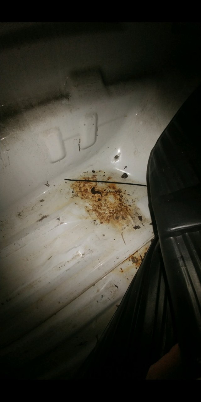

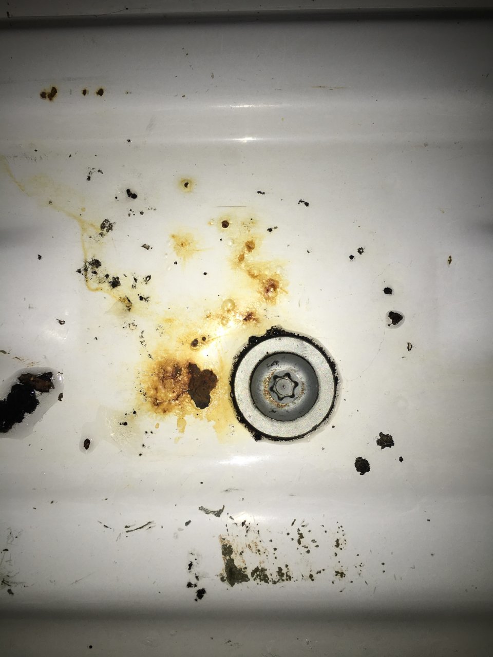

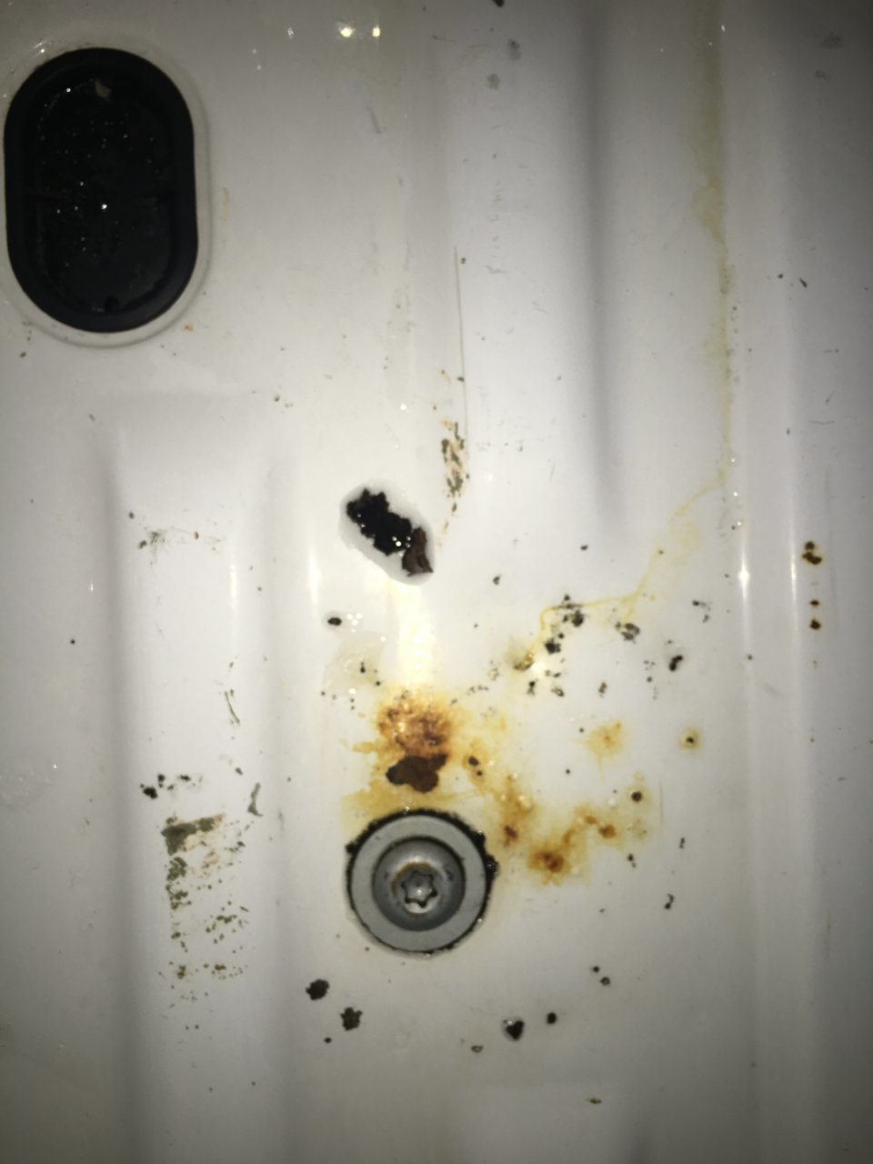

    Has anyone had issues with their bed rusting/bubbling? I have a 2006 and the rust is in line with the bed bracing.

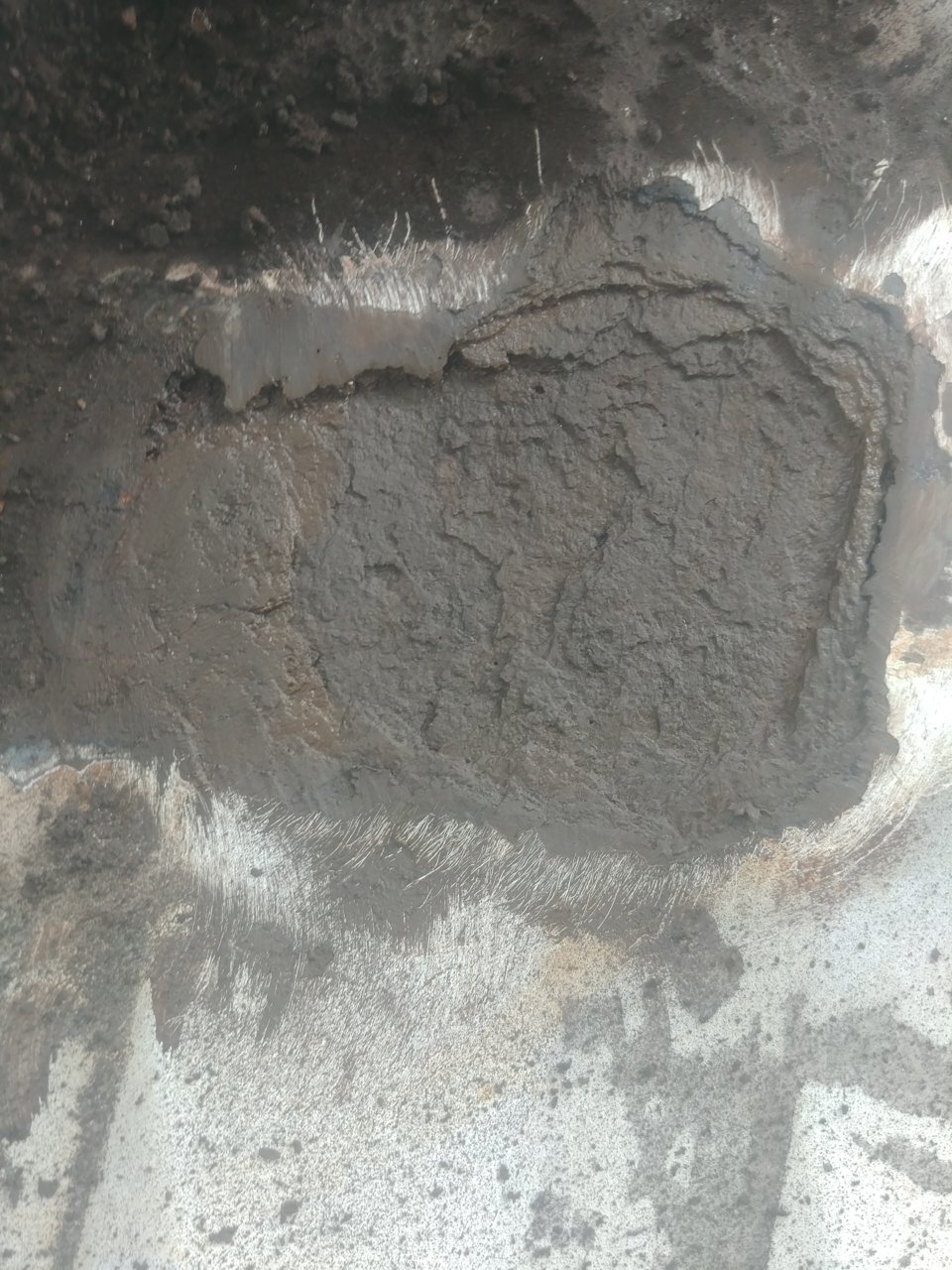

    Yep on my 08 .dealing with it now .

    Mine isn’t that bad yet. But yes @bmf4069 its blistering up and flaking away the paint away. The way it looks it’s coming from around the bed support because they are spaced out like the bed support should be.

    That was after grinding it down. This was before grinding on it .

    White paint is more severely effected. The metallic colors have more coats, plus a very nice primer base.
    Get some Ospho to neutralize the rust. If its bad, cut it out and weld or flex adhesive a new piece in place.

    Hate to tell you this but that is defiantly worse under the paint. you could try to save it but like my body guy said better off not to chance it .Cut it out and put new. He also said to remove the bed and put upside down and sand blast the hole underside then coat it. Then get line-x in the bed after. Mine is defiantly from the bed rails .Water gets in between And gets traped their.
