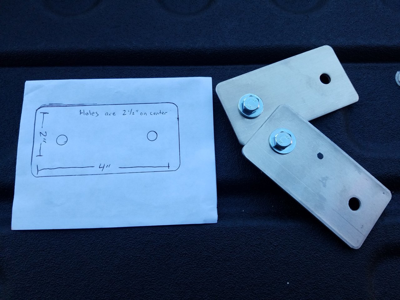

    Here ya go

    Still a PITA to make. But yep that's them. I screwed up and bought the long ones and had to saw the rails so now have 2 of those left over. A shortbed only uses 5 on each side. I'd still bet Bak would send a set for nada

    To be honest, I wasn't wild about the idea of moving the bed rails, and worried that there wouldn't be enough strength in those brackets to put any torque on the cleats. Since I've done it, I have used ratchet straps on them and they are really strong. The rails, brackets, cleats stayed put and I torqued the ratchet strap down pretty damn good. I'm pleasantly surprised.
