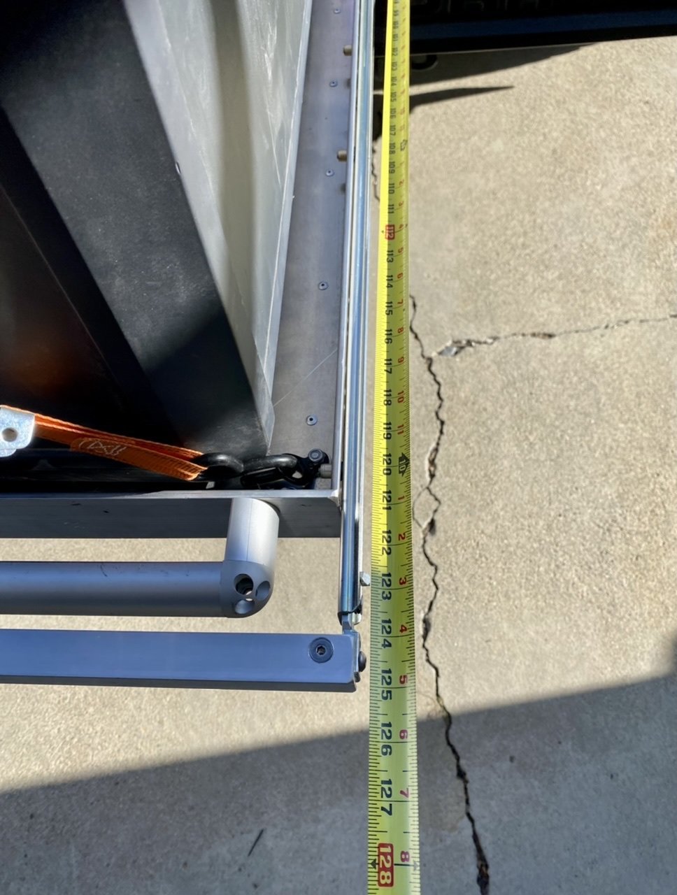

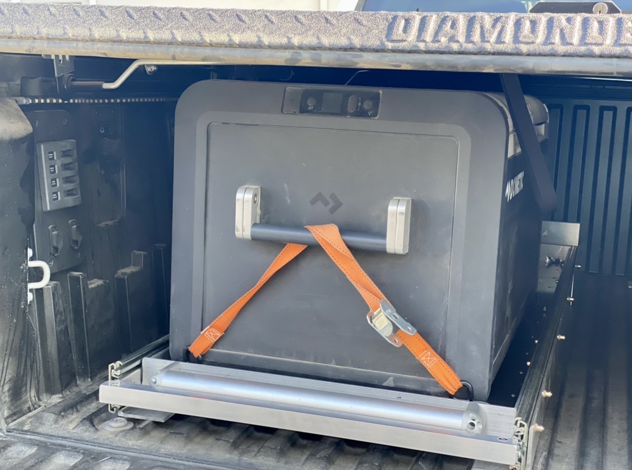

    37’s—PullKitchen--KB Voodoo Rack & Full Ext Cargo Tray

    That is really nice @PapaDave418 - well done. Curious, how much does it weigh? Is it SS or AL?

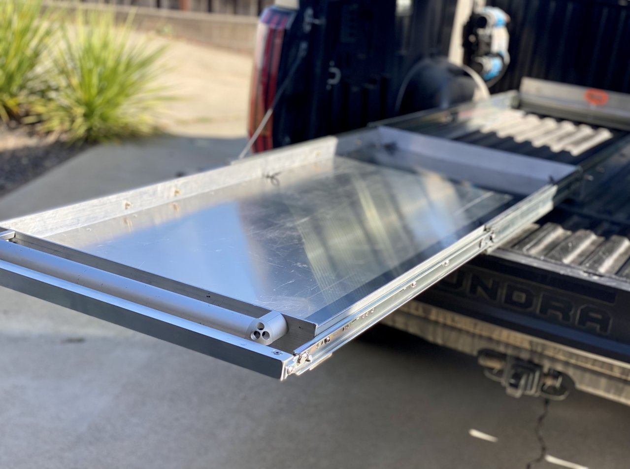

    The sliders are beefy and weigh about 65lbs or so alone. The whole thing is aluminum with stainless hardware and I would say maybe weighs 90lbs all in. It’s not hard to remove or put in other than it’s a little cumbersome with the size. That said I do take it out often and it’s easy to do.

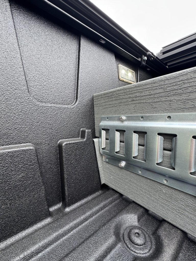

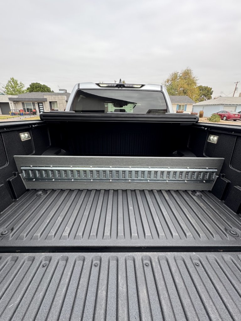

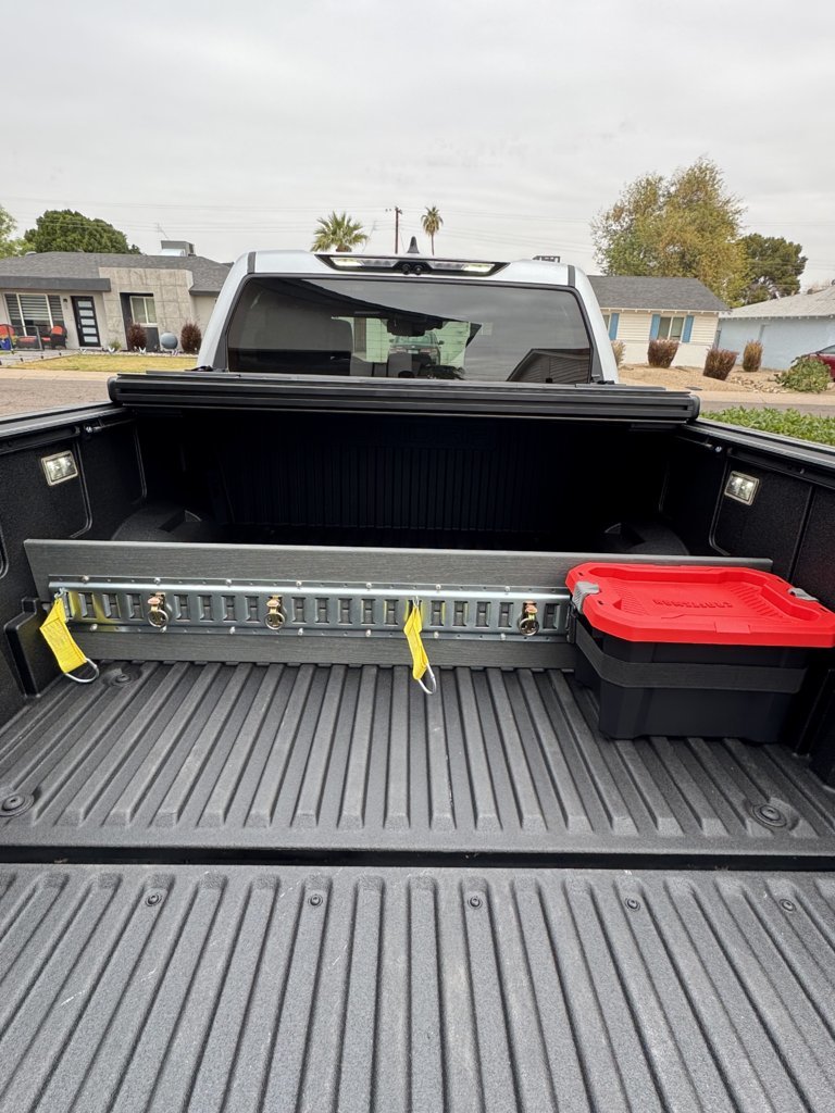

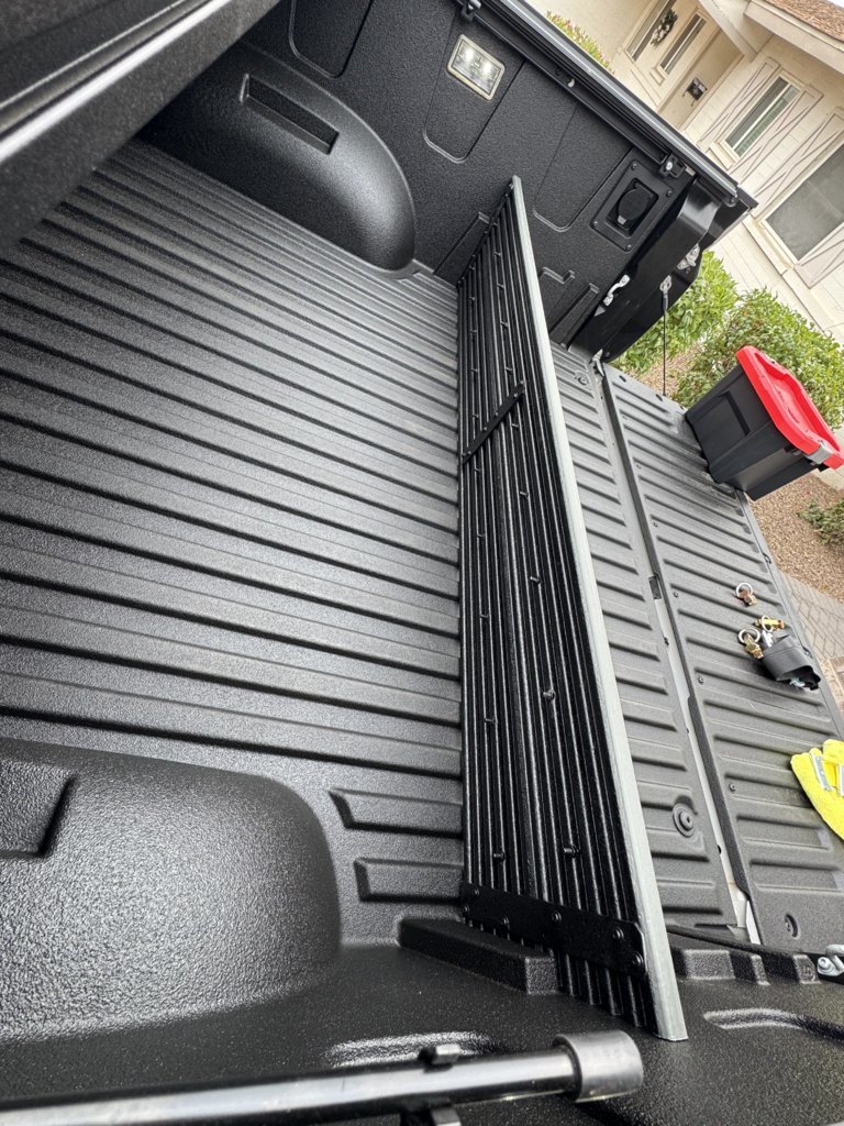

    Stole some great ideas from this thread!
    I used two 1x6 Trex boards, secured with straps on the backside and added some blocking at 6* angle on the butt ends to fit snuggly in the slots. Sprayed the back with bed liner paint- you cannot paint Trex finished edges.
    Added the E-track and rings/mounting straps (got all this from Harbor Freight for under $50).
    Ordered a couple kayak handles to attach as it is a little awkward to lift in/out.
    Cheap storage bin until I decide on a pelican case(s).

    I can't comment on the bed extender, but if you go DIY route with boards, it's quite easy to cut them to fit in slots. You can find the lengths in the manual or earlier in this thread. As for the V-shape- the back of each slot is 90 degrees, the front is 84 degrees from the bed floor. If you look at the close-up I took above, you can see what I did to get a tight fit. A couple of extra cuts.

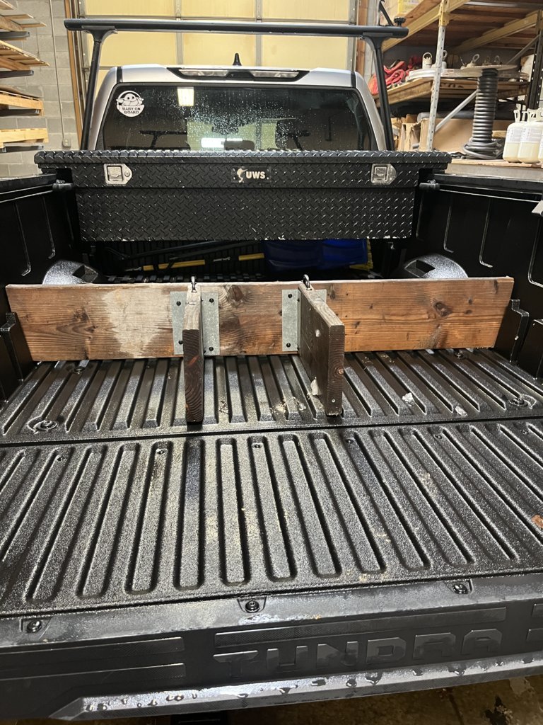

    Just bought a 2x10 pressure treated and had them cut it to 63inches after I trim it down a tad bit and paint it I’ll update with photos but not sure if I will be adding any tie down points to the board may add some hooks for the grocery getter lol but I am going to drill a couple holes out for weight reduction and to act as a grab handle for ease of use - will snap a picture when I’m all said and done. Thanks for the great ideas I’ve been looking for something and the board was the best idea yet

    Adding the E-track is a genius idea. I never would have thought of that. I have plans to make a divider when it gets nice outside out, and I will definitely be adding that to it.

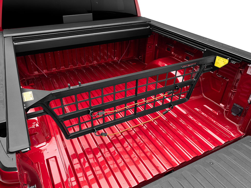

    I HATE clicking into these threads as it inevitably costs me money! LOL
    This one looks interesting to me as I could adjust along the stock rail mount. I also like the idea of the bed slide too. Dang it more money! ;-)

    I think it's Slide Master. Also the lightest. I'm trying to figure out how to mount one. Slide Master will put mounting points where you want them. I'd like to use the cross members under the bed as a mounting location but it's been a challenge. I'll post it and when I have the solution.

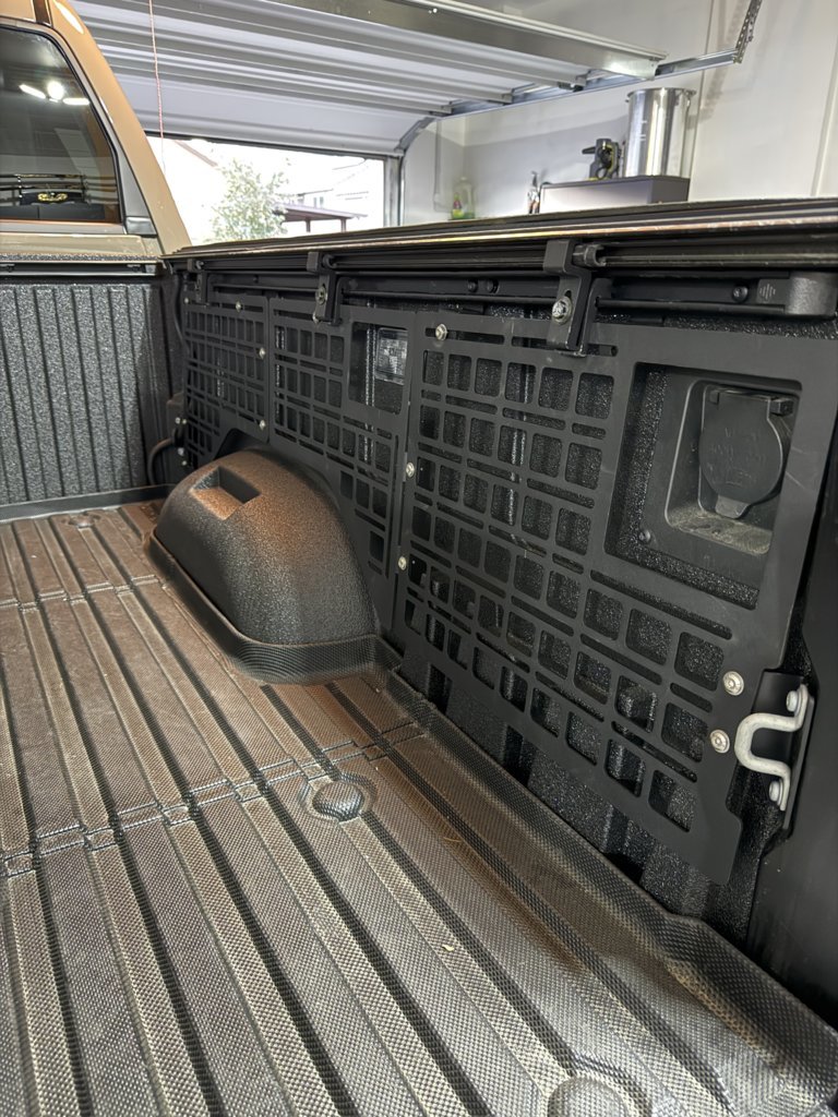

    $150 for a generic brand on Amazon for both sides of the bed. I just hook my groceries with carabiners to the molle panel. Modded it to work with my hard trifold tonneau.

    What kind of modifications did you need to do?

    I used a dremel/cutoff wheel to allow the retaining hardware to fit along the top. The picture shows the three retaining hooks. Pretty simple install and extremely convenient when you don’t want the cab to smell like food lol
