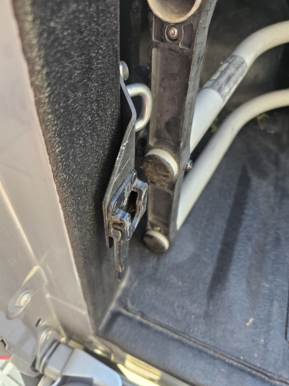

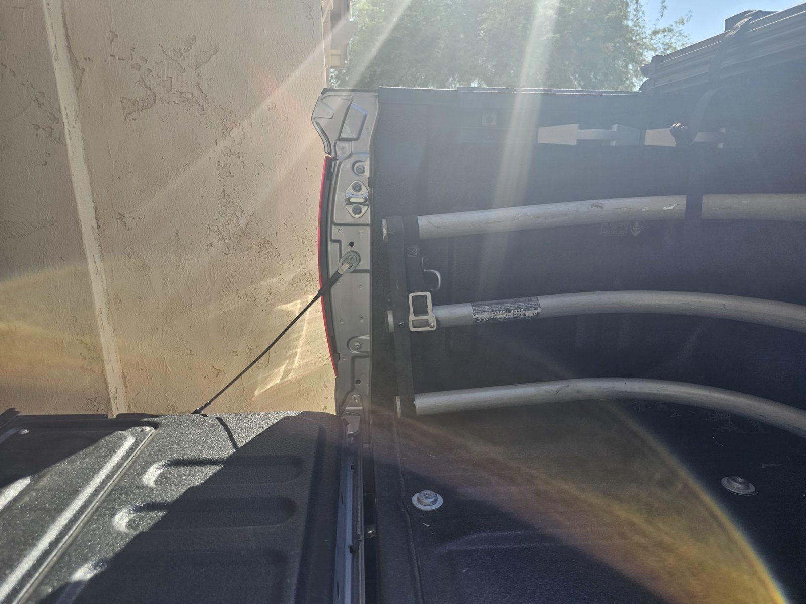

    Yup..This is them mounted on my 2018 CM. As you can see not a perfect fit. The facets sit too low, and are not flush to the side of the bed. Once I find the correct ones, I'll sell these. I was going to modify them, but there's not enough metal to drill new holes 20240716_161853.jpg 20240716_161853.jpg 20240716_161805.jpg
