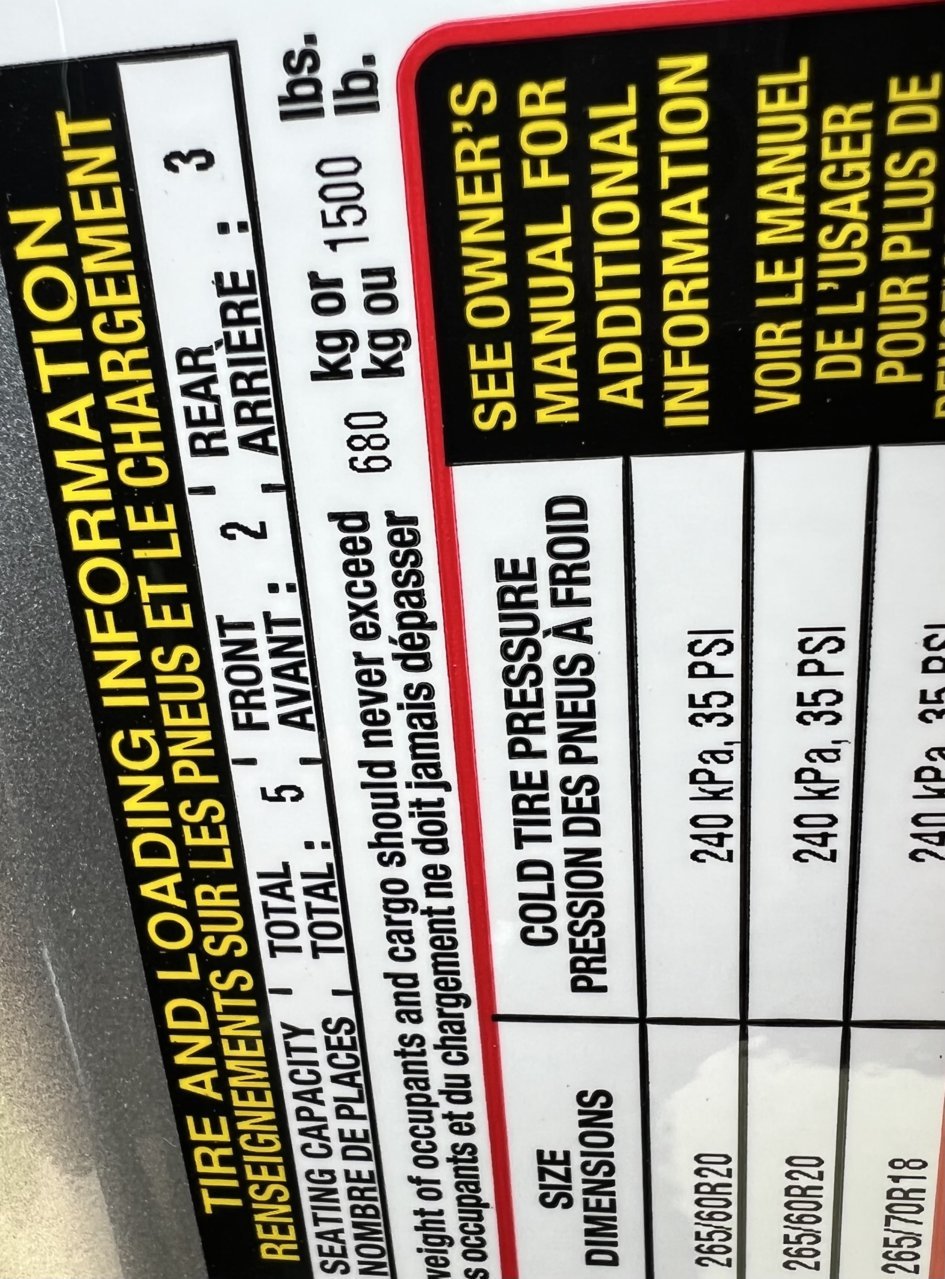

    Can anyone take a picture of their trucks payload sticker on a platinum truck with the advanced package + options and automatic step rails? Would love to see that payload capacity.

    Can’t do that but the 2wd sr5 isn’t much to write home about either.

    That's pretty awful for a basic SR5 2wd. I'd of figured 1500 or better.

    1400. My Titan is 1212 and it is 4x4 loaded.
