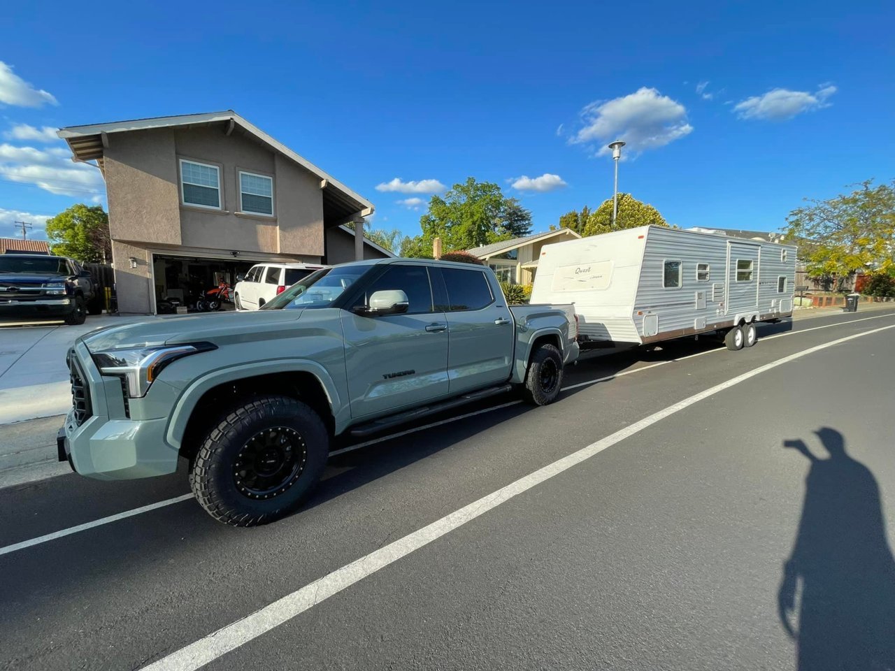

    Just pulled my 34' TT 8k-9k loaded on a 4hr trip each way and the truck did great. Only complaint I really have is that I couldn't get the BSM to detect the trailer. Tried auto setting for length and inputting the length of the trailer and neither one sensed cars on the side of the trailer for me.

    Impressive, you have that setup leveled out nicely, I assume with a WD hitch? What kind of mileage did you see?

    Thanks, yeah I have a WDH with 2 sway control kits. I still had about 1.5" sag in the rear fully loaded, but going to try and fine tune the WDH and see if I can get rid of that on my next trip. I was averaging around 11MPG with my speed at 55-65MPH. The truck does have the westcott 3/1 collar lift and 35"s. Overall I was really impressed with how it pulled and I had no sway. I've pulled the same TT with my Silverado and my Suburban that has bags and the tundra felt better pulling the TT.

    Glad to hear that as I've had towing anxiety and our trailer is only 5500 loaded up. I wouldn't have guessed you had it lifted because I would have thought the nose would be higher than its sitting. Have you done any research on airbags for the rear?

    I wouldn't worry too much about a 5500lb trailer if it was me. What I've notice a lot online and going down the road is people just don't spend the time to set up their hitch properly or even their trailer brake. I spent quite a bit of time dialing in my WDH to get the trailer sitting level and I'll adjust it again before my next trip to try to get rid of the 1.5" of sag, but IMO that's acceptable sag in my book. A proper setup on a WDH makes the world of difference towing IMO. I'm not going to get bags in the rear because I don't want to limit the suspension for off-road use. Also, I'm eventually going to be upgrading the suspension when lifts become available. If I was pulling daily I'd look into it, but the handful of times I pull a year I don't think its necessary because the truck is more than capable with the proper setup.

    I agree with setting up the WD hitch properly, on my Ram 1500 it took me an hour of playing around with it to tune it in and it paid off. I carry dirt bikes in addition to my trailer so I look at payload in the bed as my limiting factor, it'll be interesting to play around with it but I"m glad to read that its' such a capable towing platform even with the 35's on it.

    Yeah, haven't pulled the TT with the dirtbike in the back yet, but later in the year I'll be loading my bike in the bed while pulling the TT. If it was me and I had more than 2 bikes back there I'd be looking into some bags. I'd assume any universal coil over bag kit would work? But, haven't looked into it. However, I did have 3 bikes, a small electric quad, my sons power wheel, and 5g gas can in the bed which wasn't really a whole lot of weight. After this last trip we've decided were going to get a class C next year anyways. My kids are finally at the age that I'll need a little trailer to pull 3 small atvs, my wife's atv, and my dirtbike.

    11mpg towing a travel trailer with 35s is very impressive

    Ill see how it does with the bikes back there and if I need to look at air bags then I will. It would be nice as Breathing Borla suggested to have a payload package as an option. The motor will pull it but the limiting factor seems to be the payload for a lot of folks. I agree with Hbjeff, 11 is good mpg for the load and 35's but you kept speed down which is why, I drive mine the same way. How did the brake controller work, any issues?
