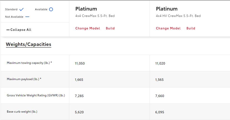

    Let's look at payload separately from towing for a moment. Payload is the maximum amount of weight you can put on the truck itself. Any passenger, added options, aftermarket addons (including skids, wheels, tires, bumpers, etc.), and anything and everything you carry in the bed comes out of payload. Your lunch picked up at the drive thru? Counts against payload. Your tow straps under the seat? Counts against payload. You get the idea.
    Well, the hitch you put on the truck to hook up to a camper counts, and so does any weight that hitch supports. This is where it will start to curb what you can tow. To tow safely it is the basic standard that you want 10% minimum and at most 15% of your trailers weight as tongue weight. 5th wheels/goosenecks work different and have WAY higher weights. This offers good balance to the set up and helps maintain control. Go too low on the tongue and the trailer will sway like a drunken prom date. Go to heavy and you get a "heavy" feel and sluggish response.
    Say max tow is 10,000 lbs. So you get a 10,000 lbs. trailer and it has 12% tongue weight when it's all said and done. This is not the advertised weight, because none of those on trailers are real numbers. We are talking true weight. The sticker would probably say this trailer is 7-8k dry. Anyway, that's 1200 pounds of tongue weight straight out of the payload. Then take out another 80 pounds for the WDH that you will need for it. 1280 pounds payload gone leaves 400 pounds for anything on the truck if you start with a 1680 payload. That means you have 400 pounds to cover the weight of any mods to the truck, any tools in it, any passengers, and anything those passengers have with them. It doesn't take more than a couple people and the odds and ends they bring with them to eat that.
    That's if you've left the truck completely stock. Realistically, say you've put on wheels and tires that are 80 pounds heavier, keep some basic tools and straps that weigh another 20 pounds, have a 180 pound driver, a 120 pound passenger, a 30 pound dog, a kid in a car seat that totals 40 pounds, and another 20 pounds of passenger items (purse, toys, drinks, snacks, water dish for dog, etc.) and you're at 470 pounds total. 70 over the payload when towing the max trailer. Nothing earth shattering, but that's also pretty conservative on the amount of shit people have in/on their trucks.

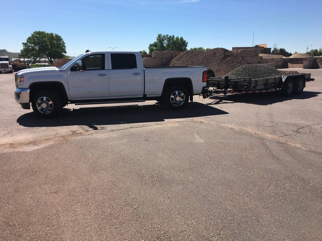

    Just to play devil's advocate, look closely. There are WDH mounts on the tongue. On an HD with way higher payload it's being done. :p

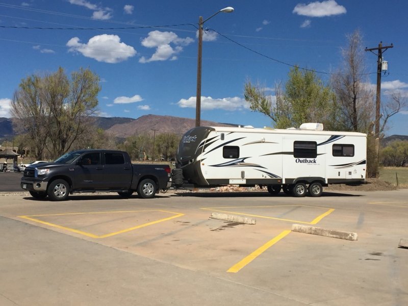

    A teardrop? A big Airstream?

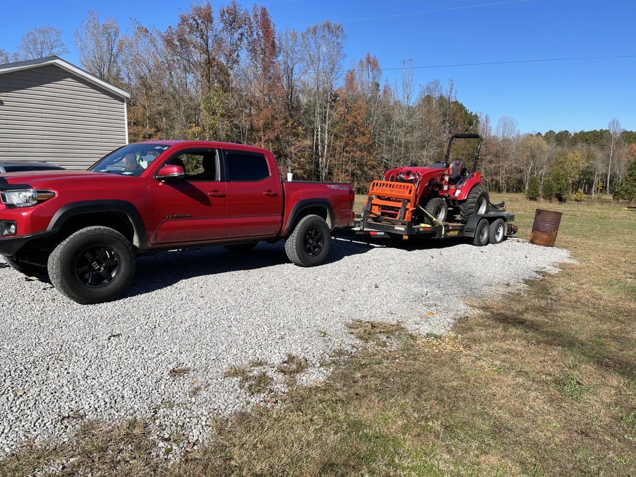

    I used a WDH when I still had bumper pull trailers.

    Oh…l2501D?
  13. Apr 23, 2022 at 4:59 PM
    #73
    33,684
    18" TRD Off Road Wheels
    No idea. Internet picture. I'm not cool enough to have a tractor. :oops:
