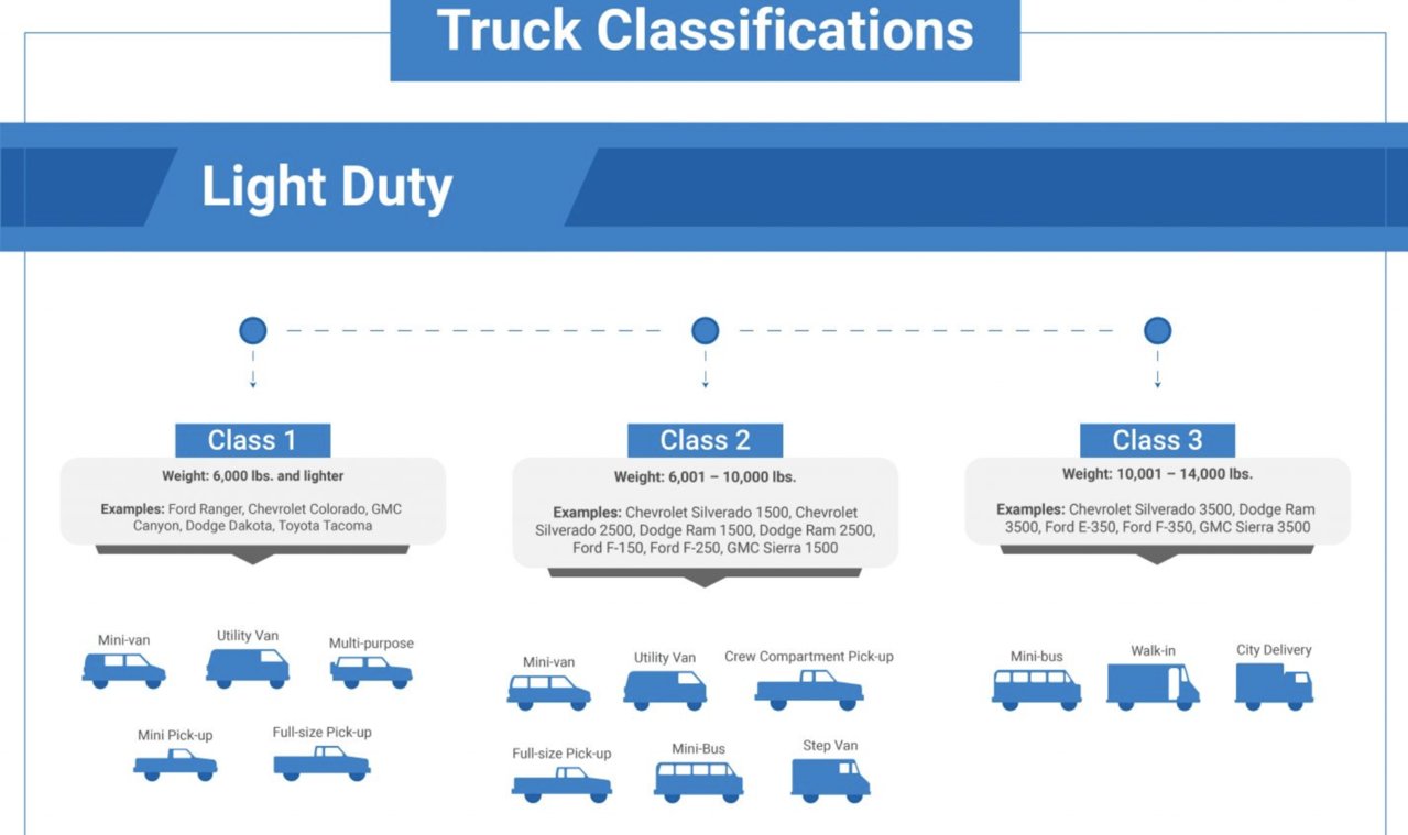

    This is my biggest criticism of the 2nd and 3rd gen Tundra. Ford and GM both have half ton 4x4 crew cab trucks with 2k+ lbs of payload. They at least offer an option if you want your non-HD truck to be capable enough to handle heavier loads and tongue weights. Toyota does not.
    My truck's GVWR is 7200 lb, but judging by all of the overlanders' rigs that weigh hundreds (and in some cases thousands) of pounds over that just sitting in the driveway, and having no issues for years and years in that configuration, it could easily be 7700 lb. Then I wouldn't be toeing the line being over GVWR on camping trips when my gas tank is full and under when I'm near E. At a GVWR of 7700 lb, I'd still be under the combined gross axle ratings. :notsure:
    I understand that Toyota set the number they did for a reason, but did you know that Toyota raised the hybrid trucks' GVWR substantially to compensate for the weight of the battery pack? Those trucks' GVWR is north of 7700 lb. Seems to me that Toyota has a market opportunity available to them. How many Tundra owners bail for HD trucks? Quite a few, it seems. How many of them would have stayed if their truck had another 700-1000lb of available payload? They could offer a heavy duty payload package. Give us a slightly less comfortable but far more capable option! An iForce Max truck with more rugged suspension in addition to that HD rear axle. Run all the tests. Give it a GVWR of 8400lb. Still a Class 2 truck, and Toyota would likely not lose as many people to HD domestics. Am I way off base here? Is there some other limiting factor for a "half ton" pickup?
