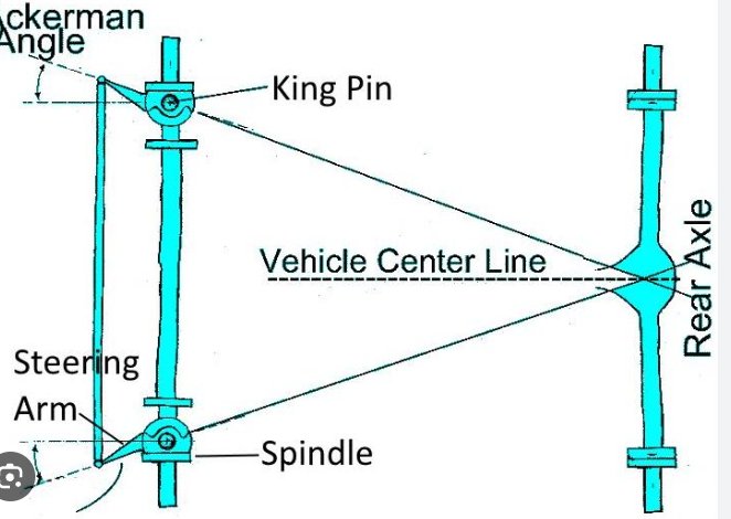

    This looks like steering geometry.
    I think they possibly designed with Ackerman angle, and designed the steering connection (pivot/balljoint) location based on a rear mounted TRE as opposed to a front mounted TRE.
    The video on page 2 where you hear all kinds of tire scrub in a circle looks to confirm this.
    If you were to draw an imaginary line between upper and lower ball joints, youd have the axis of rotation.
    If the steering arm on the knuckle is anywhere other than in a straight line or point in front of or between this axis, and the center of the rear axle, then the steering arm was incorrectly designed.
    Can you show or prove this, then BDS has made a massive mistake and needs to correct it.
    Edit: do you have more pictures of the BDS steering knuckle (each one saves a thousand words
    Edit2: It also seems to be accentuated by poor UCA geometry. He's getting too much camber as soon as the suspension travels at all.
    The video shows huge camber changes when driving over bumps. Also the tie rod length and angle as compared to how the knuckle travels will have consequences (toe-in/out) with vehicle roll an over bumps.

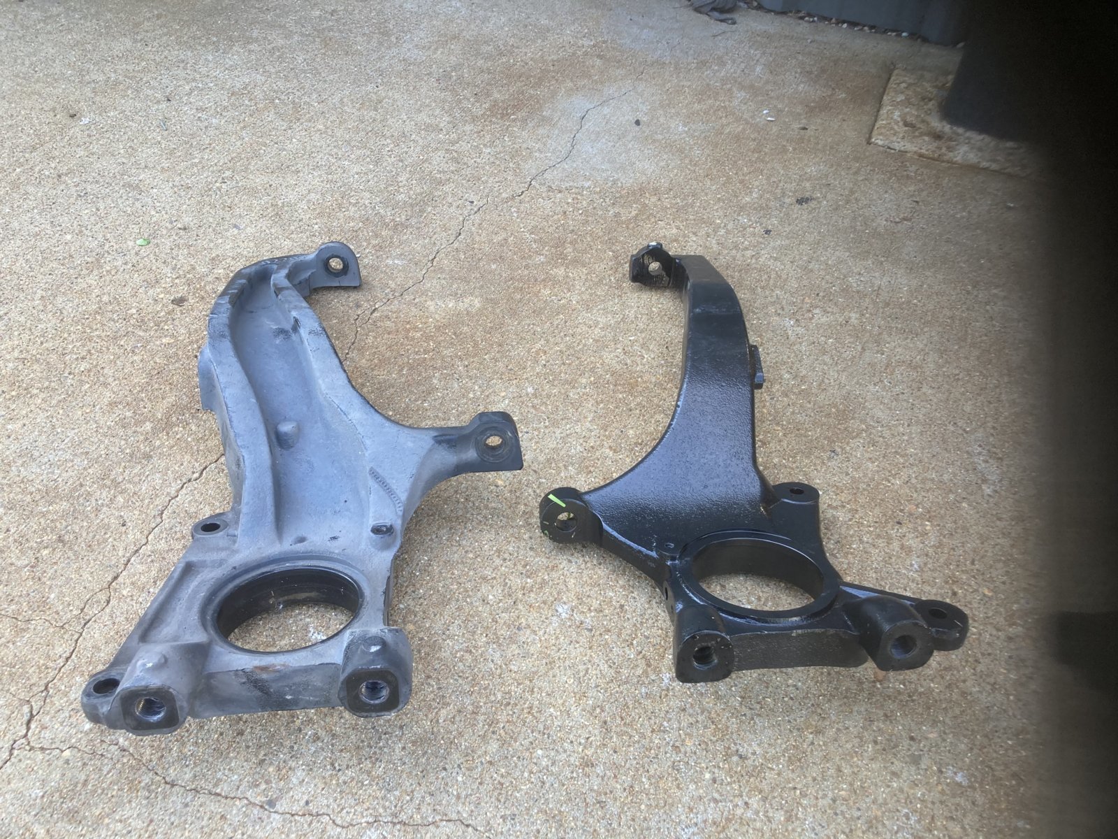

    Here is a side by side of the BDS & RC Knuckles..
  14. Jun 6, 2024 at 6:09 PM
    #74
    KNABORES
    KNABORES Sarcasm incoming
    Jan 1, 2020
    #40572
    15,113
    Arkansas
    Those don’t even look like they go to the same truck.
    NatesNightMare and texasrho83 like this.
  15. Jun 7, 2024 at 1:56 PM
    #75
    DarknessReigns
    DarknessReigns [OP] New Member
    Apr 28, 2019
    #29777
    83
    Agreed, I noticed that as well when I swapped mine. The BDS ones are beefier no doubt, but they are incorrectly engineered, which makes them a heavy paperweight.

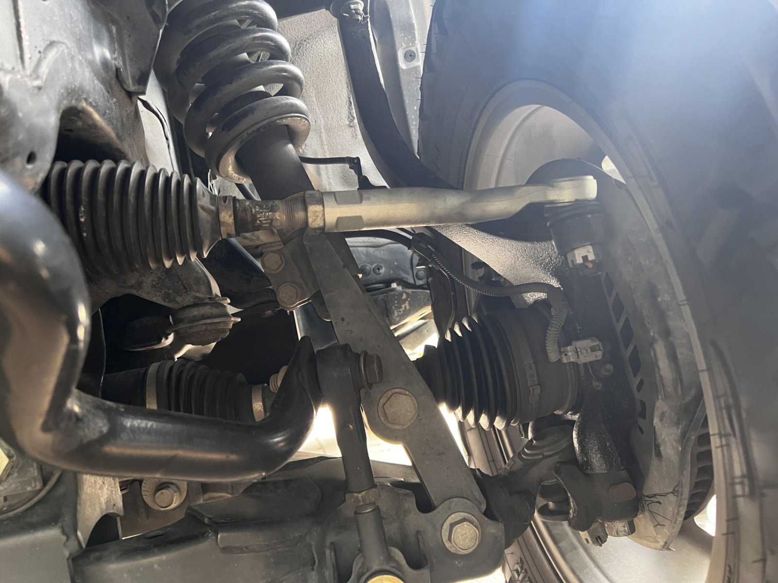

    I'm not sure the shop installed the tie rods backwards on mine :monocle:. I noticed that the angle on the tie rods looks a bit aggressive. Does this look right?

    Yeah, I read the install instructions and it says they swap them for wheel clearance reasons. I don't have any issues in that department so I'm guessing its good.
    I had always intended on switching over to an aftermarket coilover down the road and get rid of the extensions, but I have been spending my time and $$ fixing BDS's problems. If I am correct, the only coilovers compatible with this kit are FOX. Do you know if that's valid? If so, are they any good? I am now skeptical of anything related to BDS.
