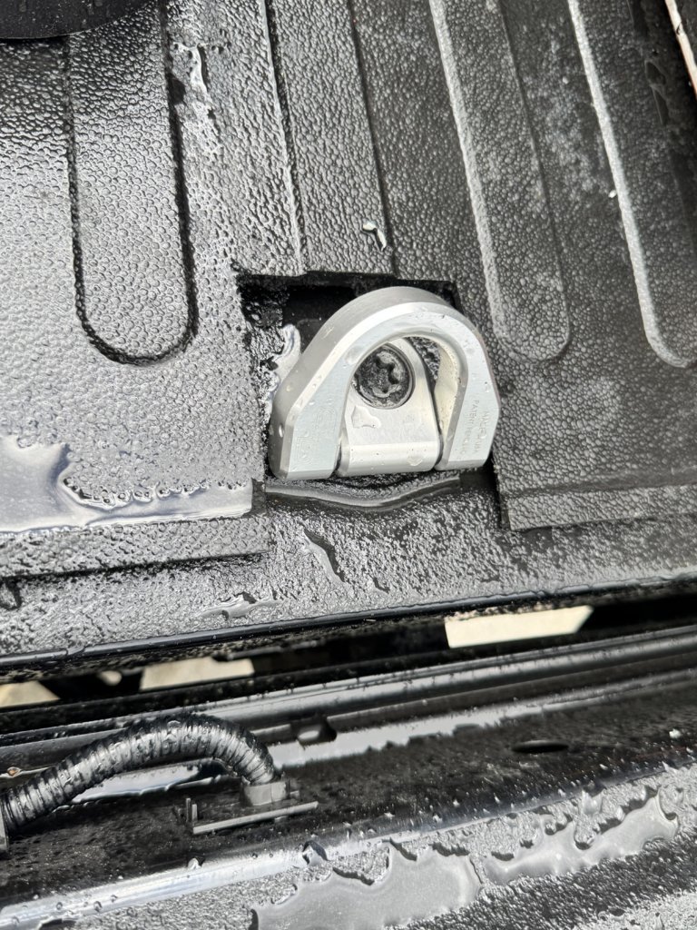

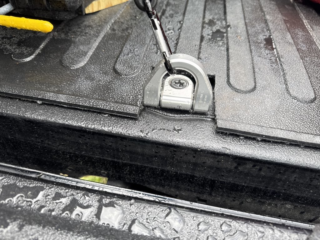

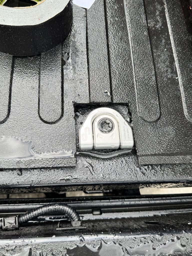

    So I learned a lot
    But the first lesson was if it starts to rain while the wife is helping you. DO NOT COVER YOUR MILWAUKEE tool first. Take care of the wife.
    Back to the D rings you have to invert the D rings so that the back part is against the tailgate because the molding of the bed won’t allow you to turn them the other way. Now, after that, I added a stainless washer underneath the D ring with a nylon washer in the middle. Both were thin and gave just enough elevation off the bed of the truck to rotate the ring on the tie down
    I used a die to clean the threads of the bolts but the head of the bolts has some spray liner on them and they may look funky.
    In hindsight i should’ve waited to cut the mat in the bed but i can live with this for now

    Honestly.... I probably would have covered the tools first as well :anonymous: my wife is waterproof and will dry out
    Question, without the bed mat, how flush is the d-ring to the ribs in the bed?

    In the direction I have them FLUSH
    BUT in the inverse there is one run or rib that cocks the D ring.
    she will dry out. L O L !!!

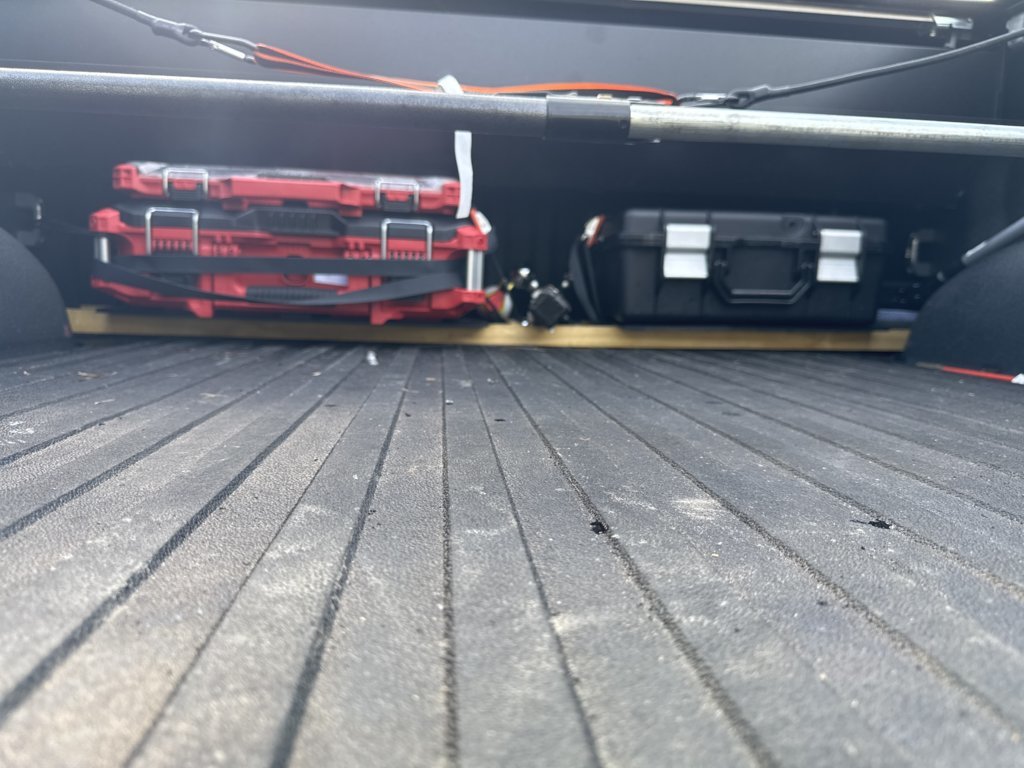

    Had to downsize one Milwaukee box for pliers and suck but it works with clearance and my compressor sits on the other side no problem
    got those straps from homedepot they don’t reverse unless you depress the tab and they are low profile

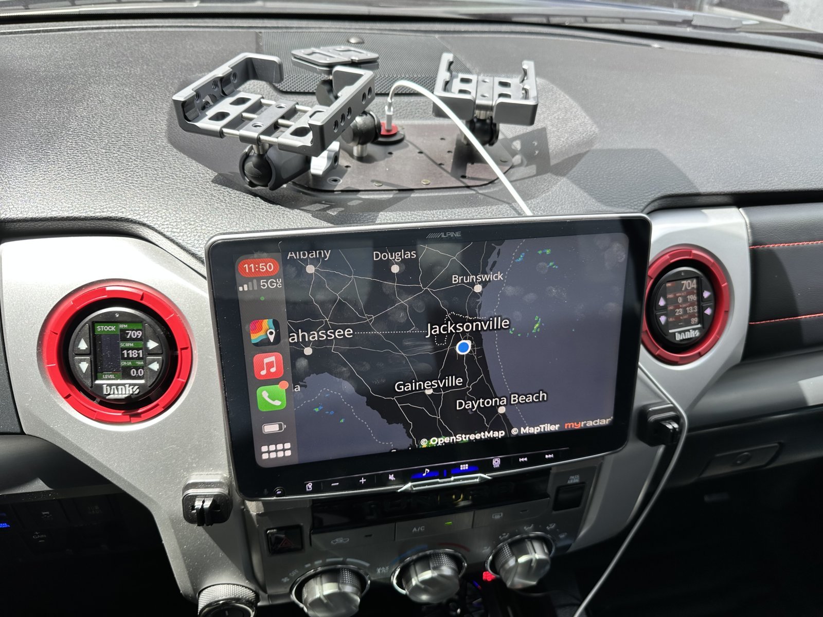

    Are you able to get TPMS readouts on your Banks I-Dash?
    Does air still blow out of the vent around the gauge?
    Thanks!
  9. Feb 20, 2025 at 12:23 PM
    #69
    Bayou Spartan
    Bayou Spartan [OP] New Member
    Jun 5, 2023
    #98144
    919
    Black 2019 TRD PRo
    None
    Afternoon Sir
    air still blows and I confirmed with banks before purchase that having the gauges installed in the vents would not be an issue.
    I haven’t been able to find TPMS on those gauges but I get them on my alpine unit.
    And it shows a lot as well
    I hope this helps you
    I’ve been learning a lot myself on here and I have new plans in motion now for front bumper
    And Warn ZEON XD 10-S - 110010 winch with S8 30” light bar. It took me some time but I got it on paper now based off others experiences
    so anything I can do to help you don’t hesitate

    Thanks for the info!
    Did you get the vent mount from Banks as well?
  11. Feb 21, 2025 at 4:50 PM
    #71
    Bayou Spartan
    Jun 5, 2023
    #98144
    919
    Black 2019 TRD PRo
    None
    I did not get the mounts from banks
    I got them off Amazon and I was looking to try to get you a link but I don’t see them anywhere
    I will keep searching though
    aelarson[QUOTED] likes this.
