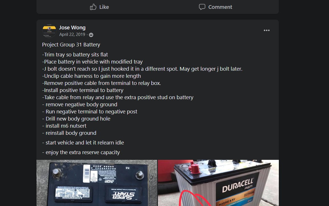

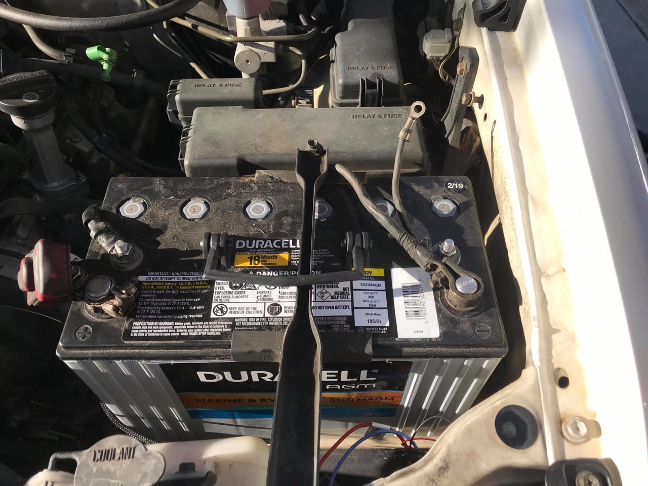

    I'll take a pic in the morning. Its my 04 Sequoia, which i assume is the same. I believe all I had to do was move the small ground point. I didnt even bother trimming the tray because it only bumps it up by like 1/4" on one side. Heres someone else's pic from the TSOR fb group.
    he makes it sound complicated but its not: upload_2022-12-13_21-36-54.jpg

    Do you know if the specs are worth the upgrade from the 27F? Especially the reserve capacity
  8. Dec 13, 2022 at 8:54 PM
    #38
    AverageAZN
    AverageAZN New Member
    Sep 14, 2022
    #83367
    85
    Austin
    2004 Toyota Sequoia
    OME/Dobinson long travel lift, 34s
    I mean its 100AH, the same battery in 27F is 90AH. the choice is yours :)
