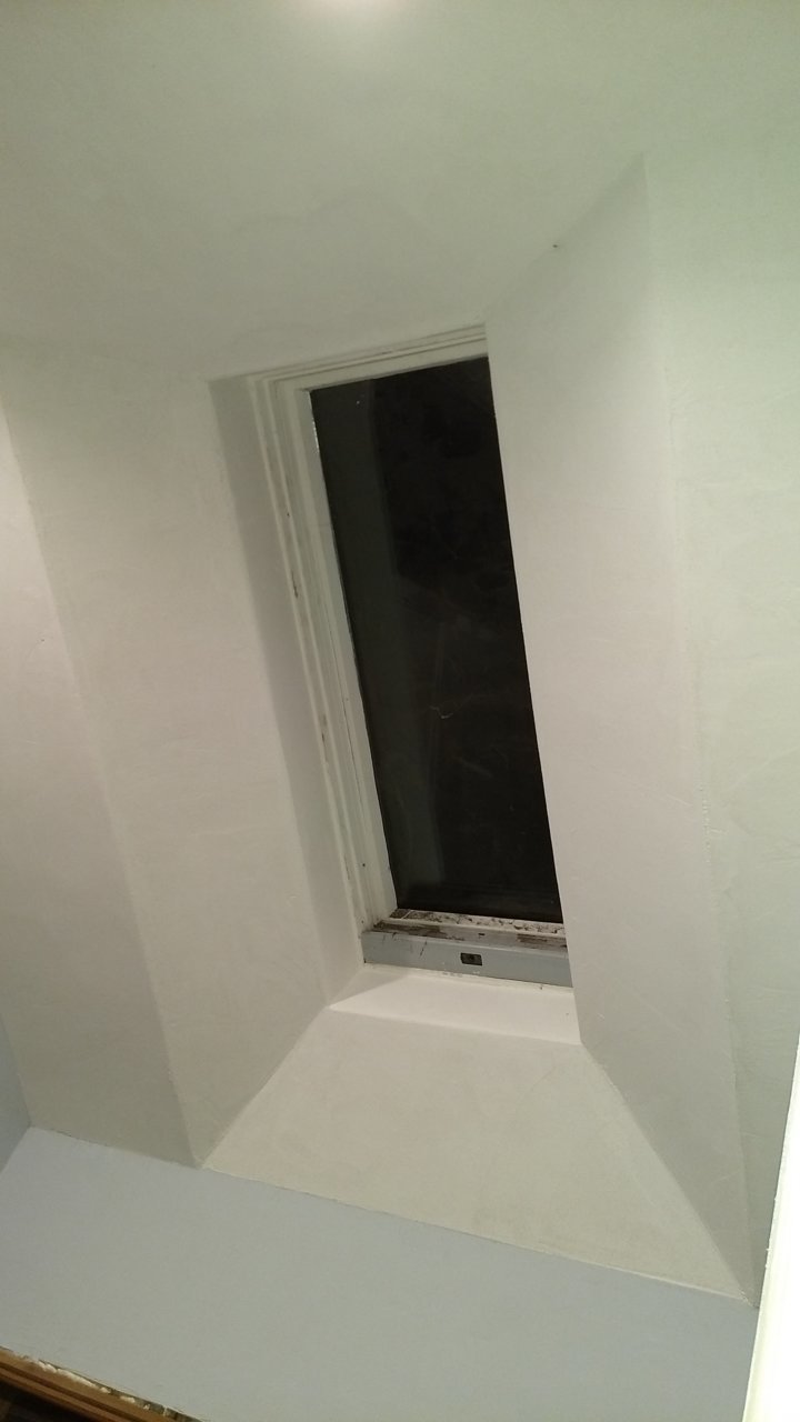

    Perhaps I'm a little insane but I like try different things. The rafters are 2x10 so I flare the "tunnel" to allow more light and to better see the redwoods above. The texture is just mud with a coffee can full of 30 mesh sand. I cover the whole surface and allow little imperfections, kinda like what drywallers call "old world". The lid has no color. For the walls I added 1.5 tbs of lamp black and about 8 0z. of blue chalk line chalk.IMG_20180303_185119030 (1).jpg

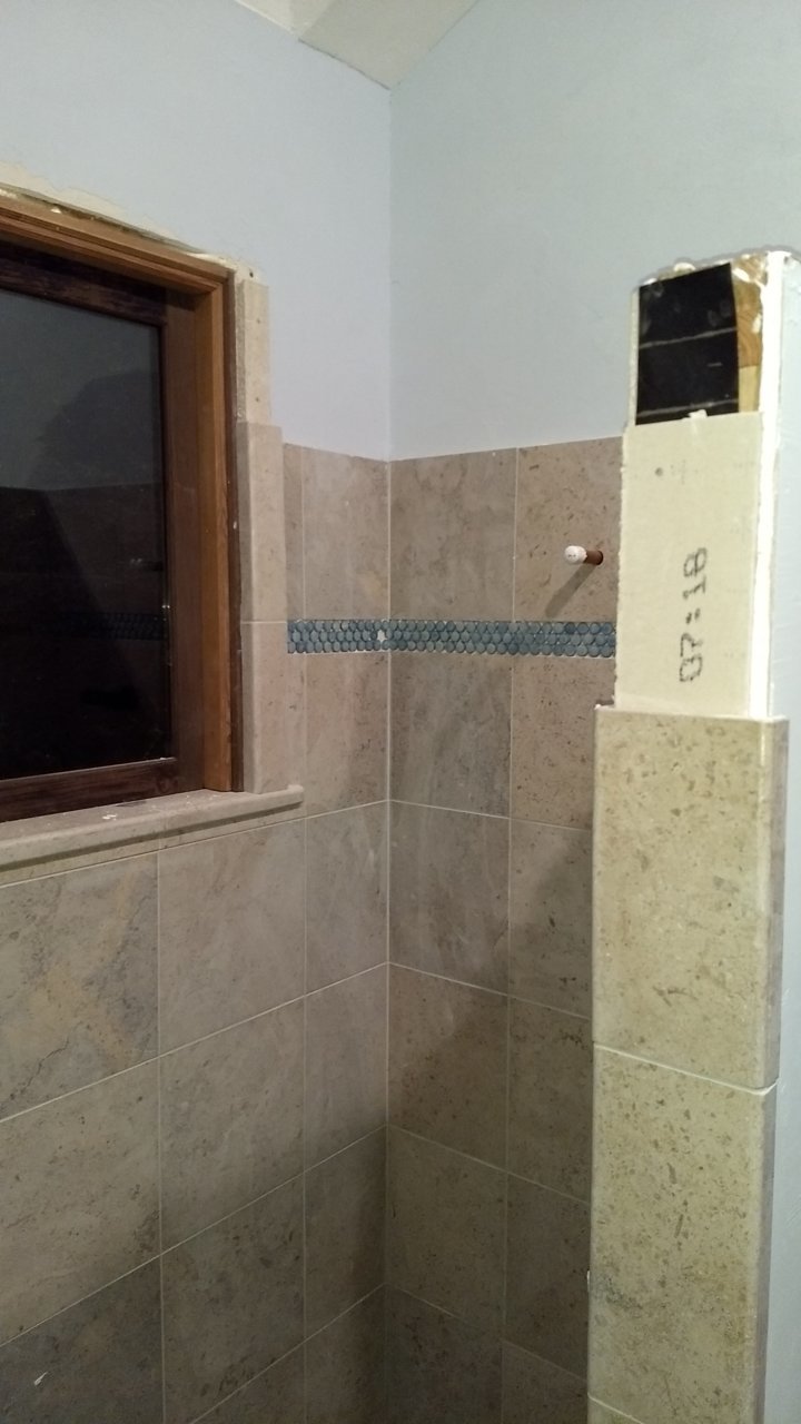

    The window is upcycled. It's an insulated glass unit that I stripped the from off of and recycled. Then I put the IGU into a reclaimed redwood frame. The window sill is an example of the the glued (west epoxy) together lime stone. It's a 7/8" sill glued on, rounded over and polished. IMG_20180303_185055016.jpg
    The wall end cap is 3 pcs to wrap around. The window will be trimmed out with pieces glued up.

    Nice work I see you use Wedi also they make a great product.

    Thanks! Yes, it flat out works, and cuts prep time dramatically. Not cheap, but it allows me to give a better long term product, and still compete with time frames. I have that damn Wedi goop on all my work clothes.:facepalm:
    Very nice. I never wanted to do tile(carpenter), but I was doing bathrooms that were in the 20k+ price point, and the tile installers didn’t come close to performing work at that level. And of course it was my ass, so I do tile.

    You are very talented and highly skilled. That work looks amazing.
