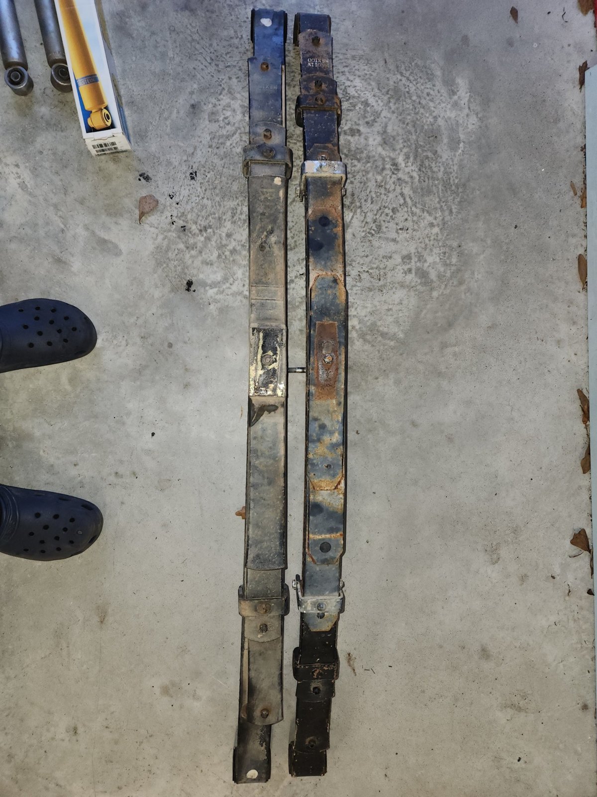

    Bump. We need measurements and pictures. Did you cut any of the leafs?
    Asking for a friend.

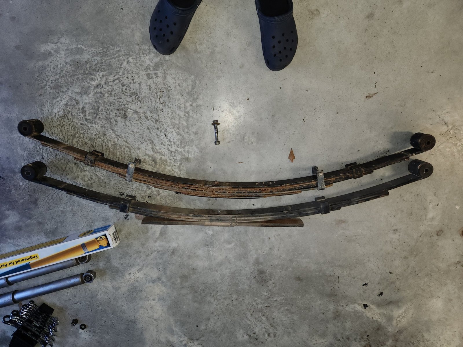

    Update: I settled on a bastard pack (for each side) that included 1 main spring, and the 2 longest intermediate springs from each pack, (original '00 AC springs and original '05 DC springs) so totalling in 5 leafs, and ditched the overloads. I wanted alot of flex without too much lift, and that was working best for me.
    To answer your question; I did not have to cut them because the '05 DC leafs were longer, besides the main leaf
    It gave around 2" of lift, so I started looking for shocks around 2" longer. Long story - short, I kinda stumbled onto a nice discovery; the rear shocks for later gen tundras mount the same (post/stud on top with an eye on bottom) and are roughly 2" longer at both compressed and extended lengths. I got a set from a 2019 tundra and while the length was perfect, they were shit off road, and now shit on the road. If you don't abuse your truck the way I do, and just want to lift the rear an inch or two, and keep it on pavement, then later gen rear shocks will indeed work for your 1st gen. I know that wasn't your question, but worth noting nonetheless

    I take it the intermediate springs were different lengths from AC to DC then?
    I know comparing my 03 2wd and 06 4wd leaf packs, the intermediate springs were different lengths.
    Note the Crocs, just for you. :burp:

    theres a little bit of difference. The '06 AC has longer intermediate leafs than the '06 DC leafs. Cant fairly compare to the '02-'03 AC leafs i have, since they've been taken apart.

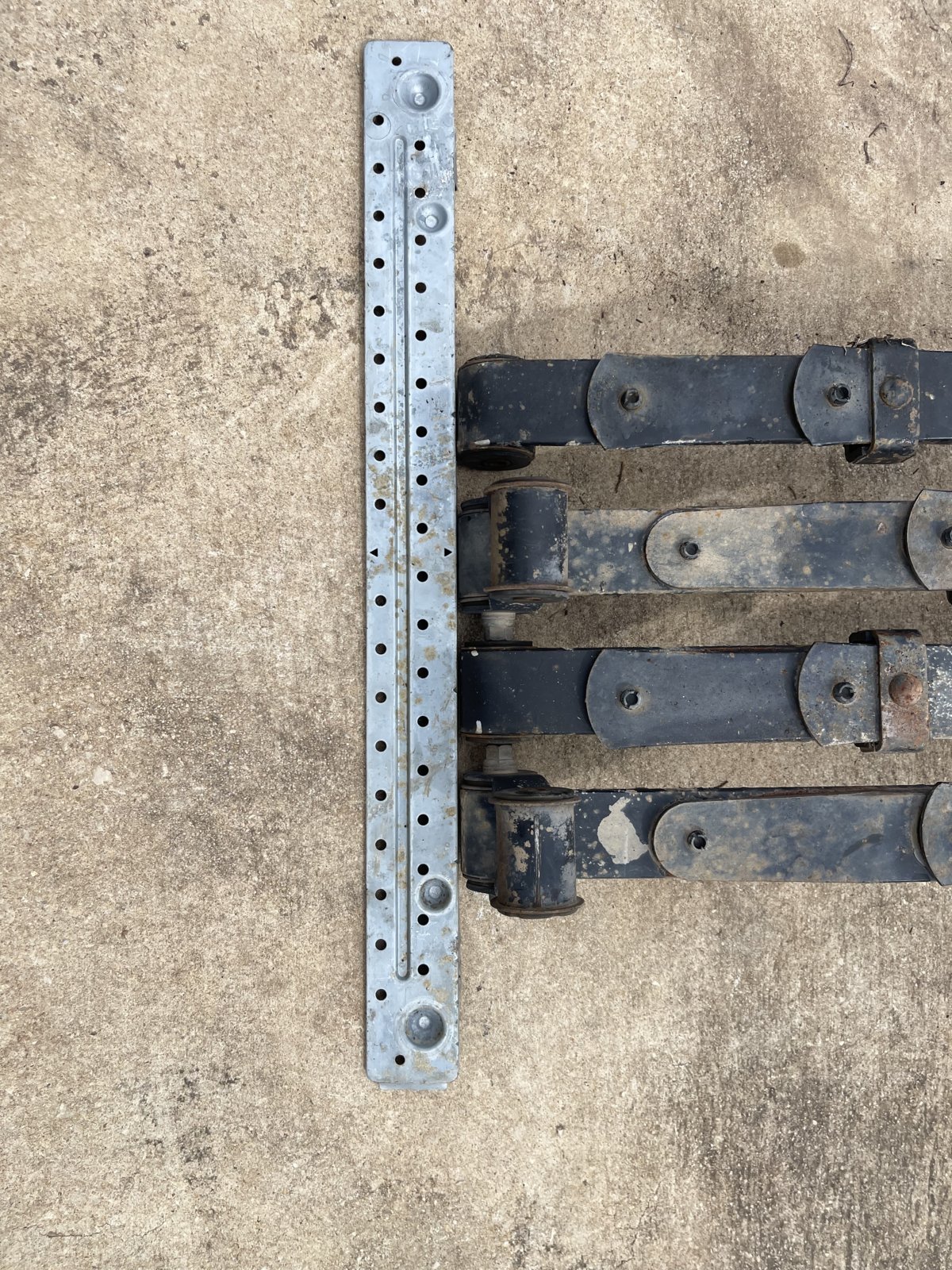

    Definitely looks like making bastard packs just got easier. I previously expected to have to cut leafs down to size, like @des2mtn mentioned doing on his bastard packs.

    Possibly, just trial and error. I'd expect to use a grinder on this job at some point on this job, even if not for the leafs, but to cut u-bolts or centering pins. That's not a big deal though. I probably could have gotten away with throwing donor leafs somewhere in the main pack without cutting leafs themselves, but happy with my results.
    Adding to your original pack will still require cutting the clamps to allow a donor leaf in the main pack. If you use the donor leaf with the clamp, the clamp has to come off it. Just swapping in leafs that are longer in another part of the pack to avoid cutting leafs may result in lifting the truck too high for stock length shocks, but lots of variables such as condition of the leafs, and weight regularly carried.
