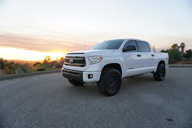

    Hey everyone! Here is my build thread and my experiences to give back to the community since this forum has been so helpful for my build.
    I bought my first new Toyota back in 2008. It was a 2009 trd sport Tacoma prerunner. Loved the truck and it did everything I needed it to do for the time that I owned it. But it was only 2wd and access cab was getting tight. So since I paid it off it was time to start searching for something bigger. I originally wanted a new 2016 tacoma but the 16 tacomas were about the same darn price as the tundras so figured id go big so I have more room and towing capabilities.
    So based on all my research I knew my best route was getting an SR5 and building from there. Ended up needing to special order a truck since they couldn’t find one around the area with exactly what I wanted. So heres what I ended up with.
    2016 Tundra SR5 Crewmax
    5.7l
    4x4
    Graphite interior
    -SR5 upgrade pkg
    -Spray bedliner
    -Entune premium
    -Deck rail system
    Mods List- current
    -20% tint all 5 windows
    -Colormatch and paint all chrome
    -King Shocks w/adjusters
    -Toyo RT 35x12.5-18
    -Method Grid Titanium 18x9 +18
    -light bar behind grille
    -GGlighting dust pod
    -Magnaflow 30” muffler p/n #12388
    -change all bulbs to LEDs
    -CMC
    -AFE pro dry s Drop in filter
    -custom console divider
    -BHLM
    -Switch-Pros 9100/ custom roof mount
    -ARB onboard air compressor CKMA12
    -LED rock light kit
    -RCI Offroad steel skidplate
    -Camburg UCA uniball
    -Stereo upgrade
    ok so first here is a pix of me and my tacoma on a road trip thru CO before i sold it for the Tundra
    April 18-2016 Tundra finally showed up to the dealer!
    First mod and celebration beer on first day
    Got the windows Tinted almost right away. 20% all 5 windows
    DeBadge the big ugly Chrome badges. i left the "Tundra" to later plastidip maybe
    Been riding my whole life so was exciting to see how the tundra did with bikes for the first time
    always used SmartWax products so always got to keep her clean n shiny
    Next Mod was get rid of the Chrome!
    Color match came out great and I'm very happy!
    While bumpers were getting painted it was good time to keep modding
    KING Shocks 25001-143A (front) 25001-144A (rear)
    Added some deeper sound at my shop with Magnaflow #12388
    Added light bar behind grille. ended up having a bad shake when offroading so i made an aluminum piece to stabilize the bar from shaking. i only took one pic of the piece i made.
    Now finally my much needed wheels and tires showed up!
    Toyo RT 35x12.5-18r
    Method Grid Titanium 18x9 +18 offset
    Got tired of being unorganized in the giant center console so decided to make my own Aluminum divider after work one night.
    Cab Mount Chop to clear the 35s
    TIG welded my tabs on to control the heat and no sparks
    Heres how she is as of January 2018

    Looks good! It seems you did all the work and installs yourself, awesome too!
    I love that wheel, that color on the white looks good. Something other than black.

    Great work bro, I like to see Tig welding vs mig, alot cleaner for sure. Looks like the aluminum divider needs a plasta dip bath, haha.

    did you have to remove the UCAs to install the kings ? Looking to buy the same shocks.

    No I did not need to remove the UCA but I did have to just remove the single bolt attached to the spindle to give some clearance. Also had to have my brother help me push down on the LCA so I can slide the shock in. That's about it! There's some good write ups around in this forum and a few basic YouTube videos that can help! Good luck!

    thanks. no issues with alignment after switching shocks and tires ?

    As far as I know... no issues with the alignment. The shop was able to get the numbers within spec and the truck drives better than stock so I'm happy.
    I'm debating adding an aftermarket UCA and cranking the coil up almost another inch so I will do another alignment after that someday.

    Thank you! I couldn't stand the little light shake I was seeing when I had the lightbar ON. So simple but effective fix!
    Next plans are something with my headlights! Can't stand the shiny chrome. So either $10 in spray paint and go for the BHLM. Or just save up some $$ and get the spyder headlights cuz those are clean looking also! I really like having the headlight adjuster tho.
