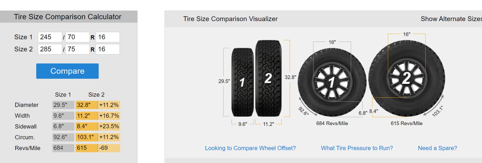

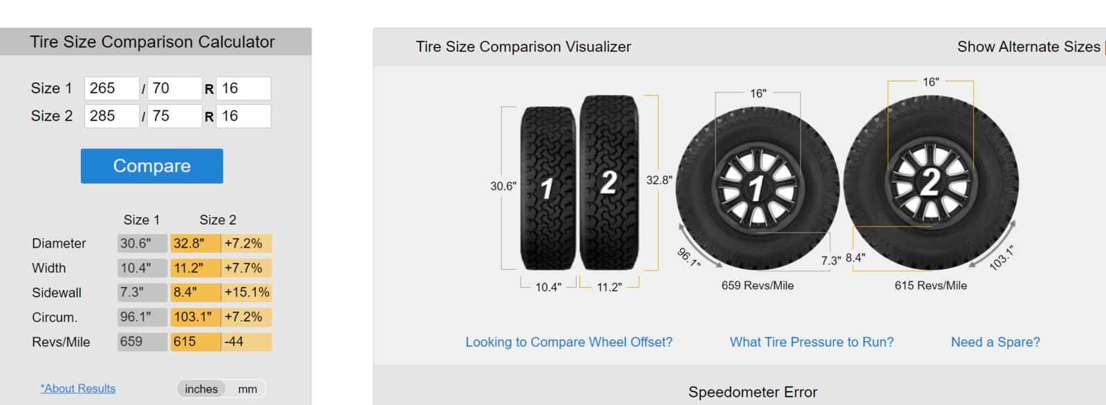

    My truck is stock, but the TRD package which is supposed to be a suspension that gives just a tiny bit more tire clearance. Apparently it can depend on tire brand and even model, as they can be a bit bigger or smaller than the claimed size, but on my truck, 265 75 16, just slightly bigger than stock, rubbed my frame. If your truck isn't a TRD, 245 70 16 is the stock size. TRD stock size is 265 70 16. So 285 75 16 is definitely a big tire compared to stock.
    Comparison of the smaller stock size compared to what you've got, and the larger stock size compared to what you've got. Definitely significant.

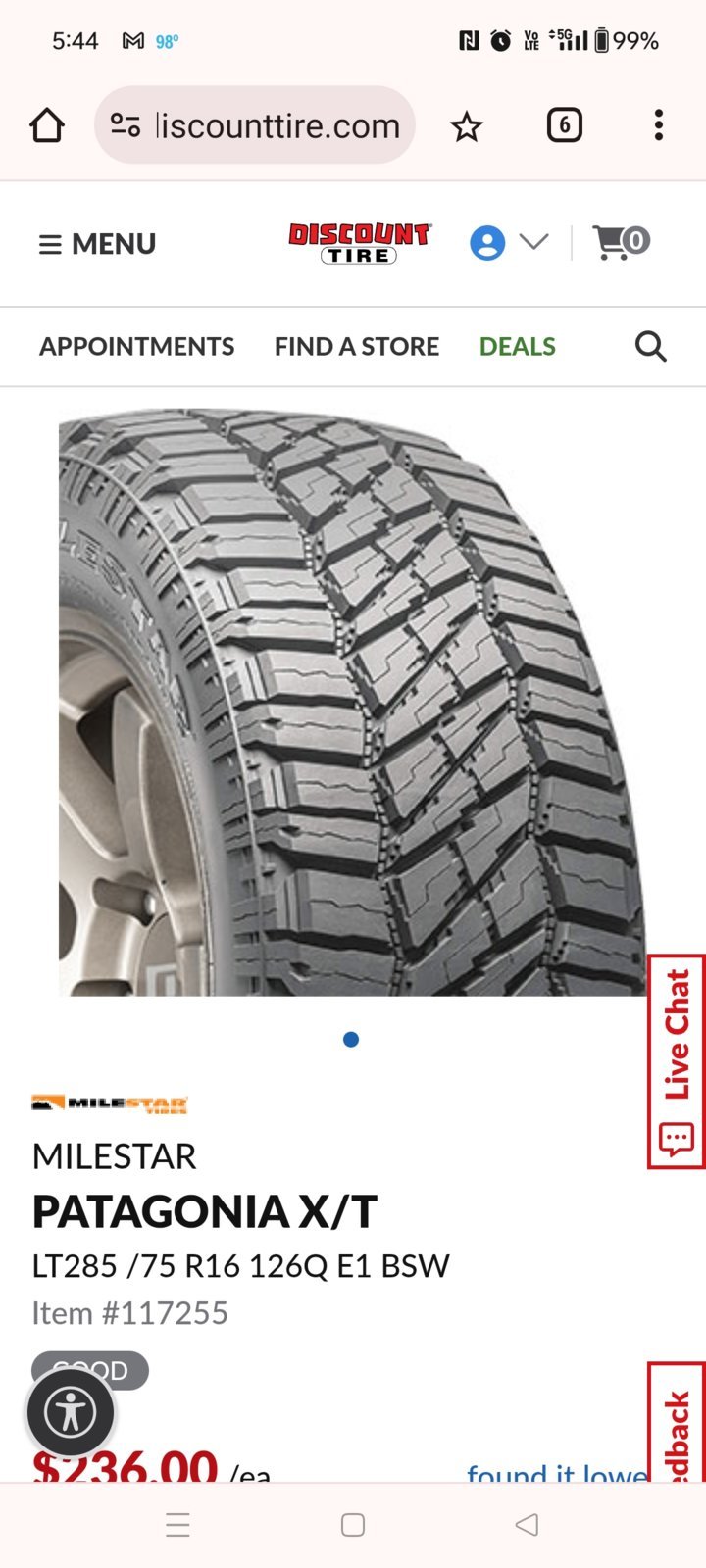

    patagonias are the heaviest tires on the market iirc
