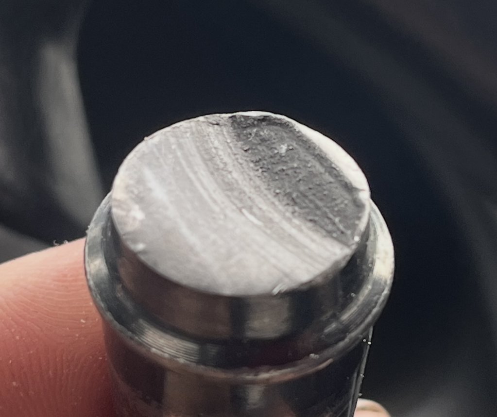

    So examining the broken surface closely....and looking up the failure modes of bolts in an old metallurgy book, it appears what happened to me was classic metal fatigue. The bolt surface shows the classic 'beach' marks of it.
    A crack started in the past, long enough ago for the cracked surface to oxidize, and then much more recently the crack started to spread rapidly through the bolt until it had cut through about 7/8ths of the bolt thickness, before tearing away completely at the end from simple stress.

    Although the Mevotech failed and and has given me a really bad time.
    It actually was still holding the weight of the truck up to about the last 1/8th inch of metal. It was cracked 1/3rd of the way through, for long enough for the crack to oxidize, could have been months or years like that.

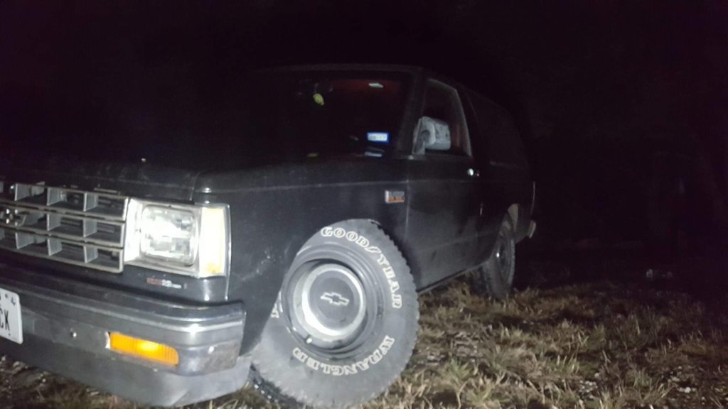

    My s10 blazer had lbj’s right way up. Broke the nut. Happened on a bridge expansion joint.
