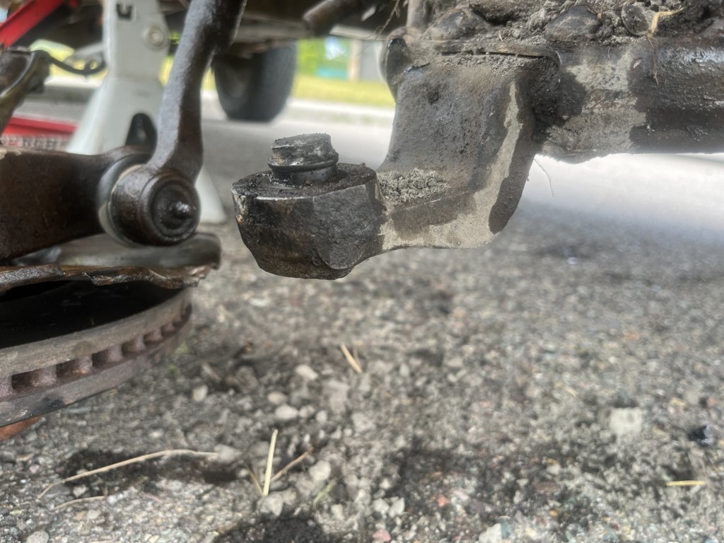

    Looking at my pictures, it looks like the upper ball joint socket is expanded and deformed from the ball pulling out. I think I will need to take the whole spindle home to cut off part of the socket, as its now oversized and I don't think will hammer out as is.
    Right now, I need to pack up all my tools, because I'm was in the middle of an engine transplant on my surbaru, so my stuff is all over the place. FML, and get down to where my truck is, three miles away.
    I guess nobody is going to steal it.....
    Actually, would be nice if they did.....as that would mean they fixed it for me.

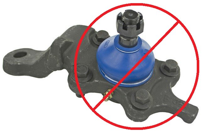

    Anything that's not OEM has a bad rep. But Mevotech and Moog are especially total fucking garbage.
    It's a massive problem, aftermarket part quality with that specific part. Aftermarket are notorious for abrupt failure with no warning, and massive damage. OEM with 4 fresh new OEM bolts every 100k miles for that specific part, it's a wear part, you need to replace proactively. You're not going to be able to detect play in the joint, and I don't think most mechanics know this.
    Only OEM LBJs. Always. Fresh bolts at each change. Always torque to spec. Mark the castle nut and bolt head position with a paint marker and verify nothing moved while doing each oil change, to be safe with little effort on your part.

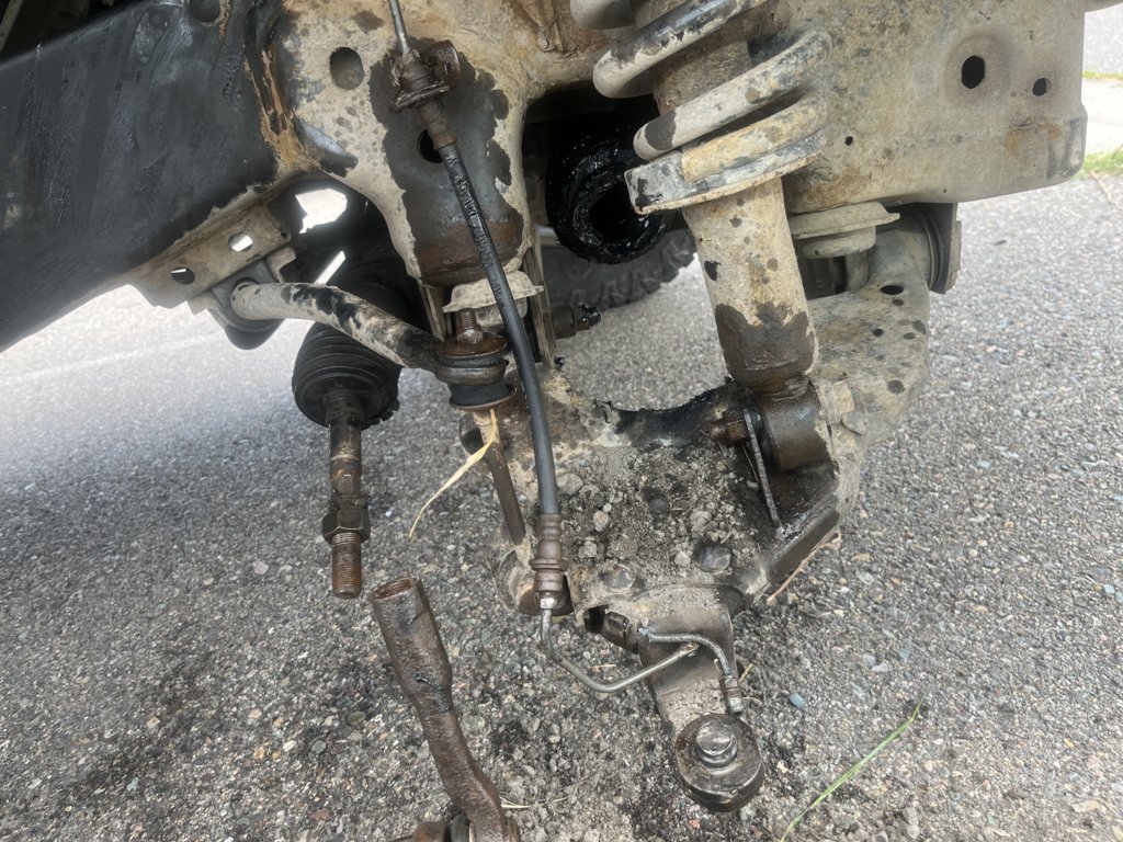

    This is where I stand right now. Nothing wanted to come off easy in the parking lot so I took the whole hub off and took it home where I have a 20 ton press.
    LJB Nut got turned into sparks on the highway so it may be interesting getting it off. CV shaft cut out, the bearing rack shattered internally on the outer end.
    I actually have a spare CV. Long story but about 2020 I had a vibration I was trying to track down and a oil seal leak. I pulled the CV to replace the oil seal, and replaced it with an aftermarket, as at the time I thought maybe bad CV. Figured out it was actually front driveshaft U-joints. I saved that CV though, which as far as I know, is actually perfectly good. It's been sitting in a box for five years so I think I will just put it back in.
    Brake line removed and crimped closed. Going to town to see if there is any local parts just to get me home, its about an hour trip.
    Unfortunately, my wife is using my normal backup car for work while I fix hers, and so I am down to the secondary backup car, which is not in great shape but should get me there and back I hope.

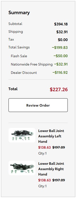

    $227.26 OTD Shipped to your house! C'mon man. Dealer is not that much more expensive.
    This is the exact kit you'll need for the 00.
    Did you even get bolts?

    is that brake fluid or penetrating oil above the brakeline soft hose?
    if theres a local junkyard nearby it might be worth a shot to find out if they have tundra or 3rd gen 4runner parts that might get you home.

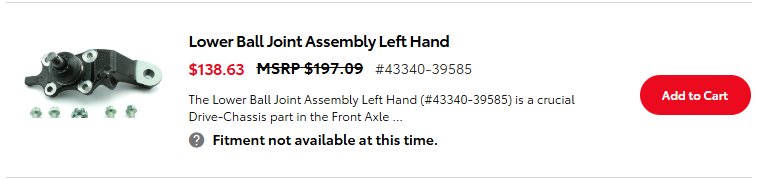

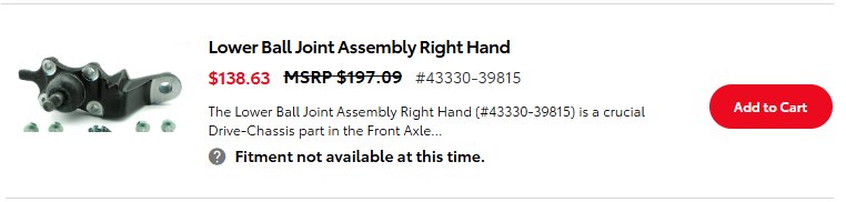

    When I called dealer he said $150 each.
    Online, $95...so I placed an order, but I didn't realize they where left and right specific so I might have got two of one side....

    Current Flash sale is $50 off all orders, free ship, and Serra has no tax for anyone outside Alabama, which comes out to 25% off. And saves @Aerindel whatever tax his local dealer would charge. It's worth it, but he only has 10hrs left to place the order.
    But honestly, at $95 if local pickup, making the order online from a dealer, you can't beat that.

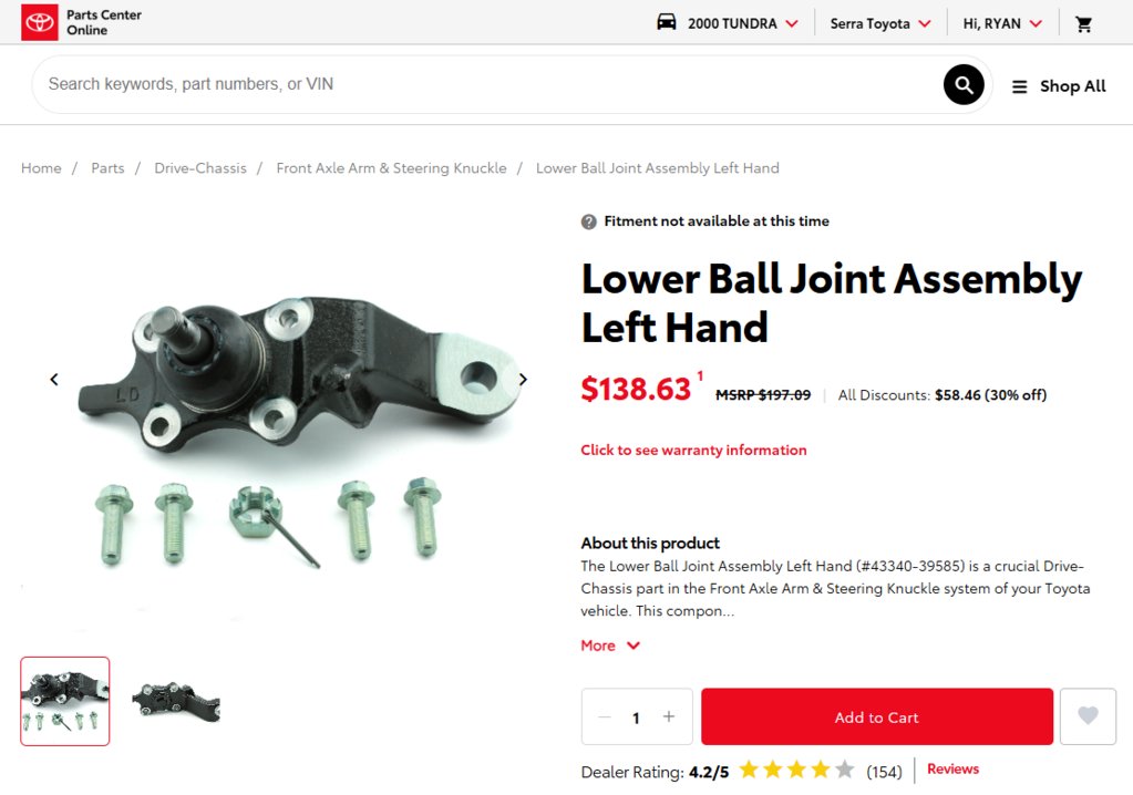

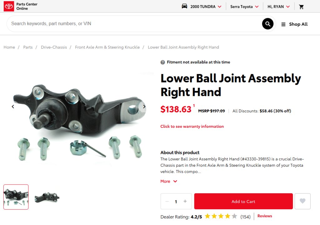

    Its $152 each local pickup. By local 120 miles round trip. I ordered the wrong parts, tried calling them back, but the order lady went home early....Going to try to sort it out tomorrow with them.

    Indeed. Looks like they stopped selling them though.

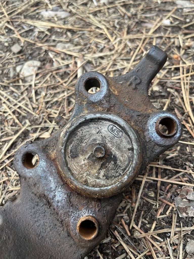

    Do we know what brand this is?, this is the only markings I can find on the failed ball joint.
    I now have all broken parts off the truck and spindle. Getting the CV nut off, without a CV shaft, was a challenge, but I finally got it.
