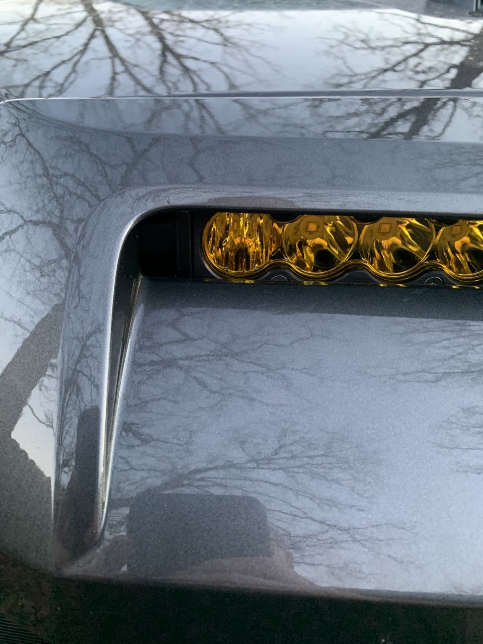

    Nope.....no ADD...maybe OCD...lol. Just the bottom is cut off if its installed in the way that the instructions state. It is a tight fit in there though.

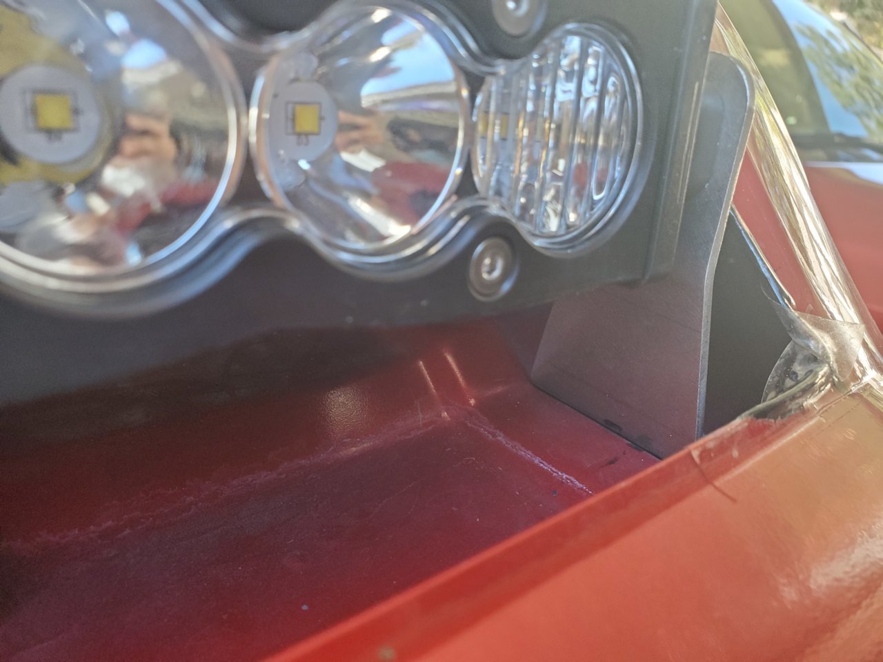

    I did this same thing and when mine cracked on both ends it was in the line of where I trimmed. It will fit in there but the brackets have to be set just right. The templates leave much to be desired also. When mine cracked I used a Dremel and cut it off so I can see what I need to do to make it work the next time. So it was a hood bulge I cut at both ends at the opening fully exposing the light bar and brackets.

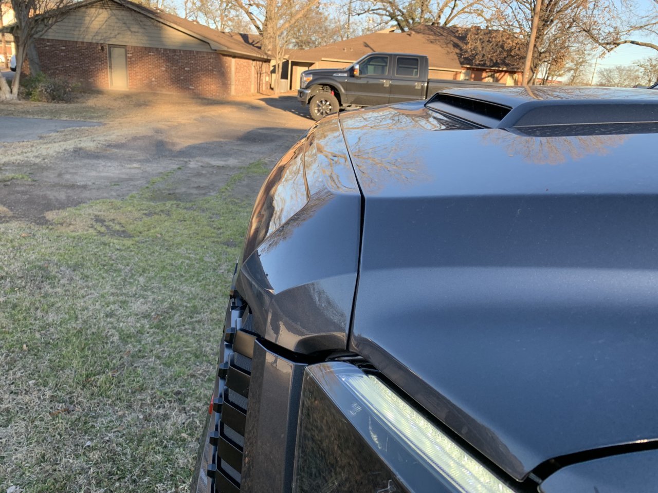

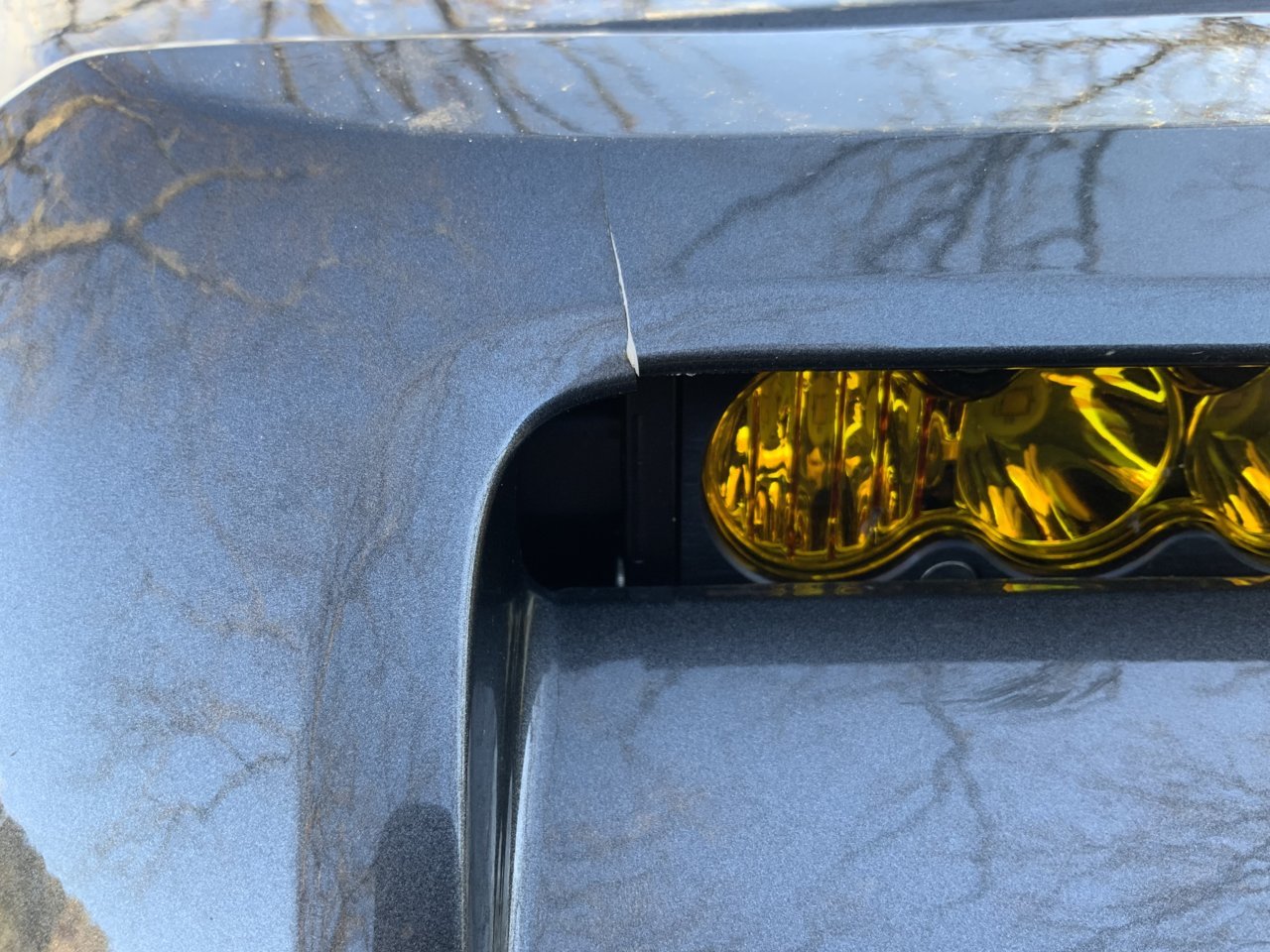

    I just noticed a crack on the passenger side corner of the hood bulge. This will be an interesting conversation with the business installer on Monday.

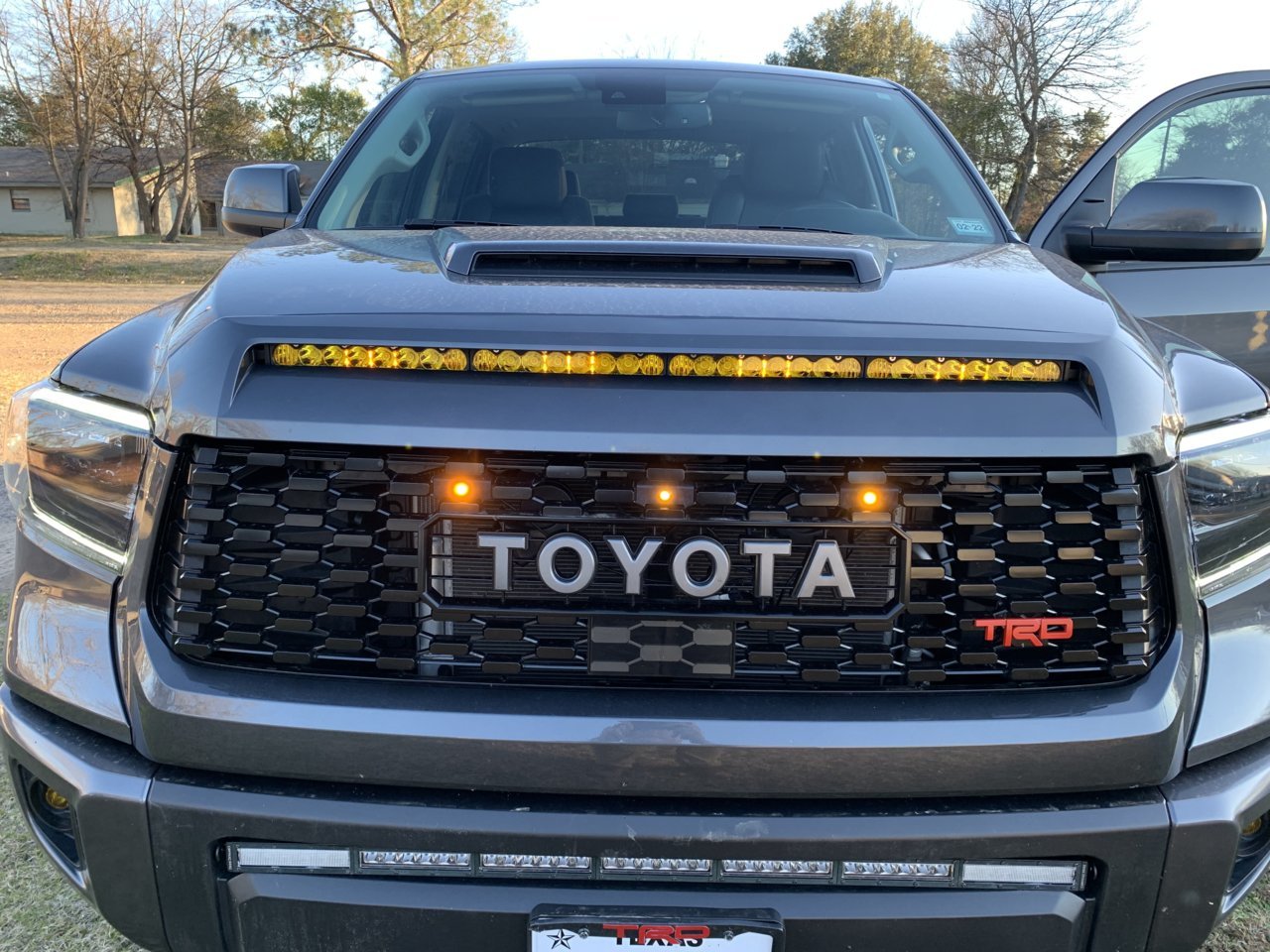

    Looks nice.
    But why are they all amber?
    Just curious...:cool:

    That sucks Lee. Hopefully they take care of it.

    Exactly where mine cracked on both sides

    Is this from the light bar making contact with the corner of the bulge? Hard to tell from the photos. Seems like it could be remedied by moving the brackets back a bit.

    The cracks are because it wasn't installed correctly. Once again, if the bar was installed per the SDHQ bracket instructions, the bar would be further back and have close to a 3/4 inch gap between the surface of the bar and the bottom edge of the bulge opening. Your bar looks like it is right up against it. The clearances between the brackets and the bulge are very tight and that's why the corner clips get trimmed and the brackets placed in a certain spot. Not trying to start crap but whoever installed it did a poor job and should be embarrassed that he let it leave his shop that way. Looking at the bulge deformities that yours has, it is the worst one that I have seen out of everyone that has installed one.

    As I stated earlier, I believe it to be either the corner tabs not trimmed adequately, bracket placement or a combination of both. Looking back, I can’t help but feel a little guilty for not installing it myself. I got impatient looking at it in the box while dealing with a pinched nerve in my neck with radiating pain in my left arm. It’s better now, and I’m thinking, why didn’t you just wait? We’ll, hindsight is 20-20. Maybe, I would have had a similar problem with the install, don’t know. What I do know is that I’m on their schedule for tomorrow at 1:00. All wrongs will be made right.
    @Tundra234 if my memory serves me correctly, you had problems with your install as well, am I correct? Would you care to share and elaborate your experience?

    I like amber with black..

    Hood Bulge Issue Fixed! The corner clips were trimmed correctly. They ended up moving the bar back as much as it could go. Had a body shop fix the crack and it’s barely noticeable, in which I’m fine with.

    Did they drill new holes to push it back. I would keep an eye on it because the brackets are still extremely close by looking at the pics. My brackets are all the way back to this raised area.

    Yep…all the way back!
