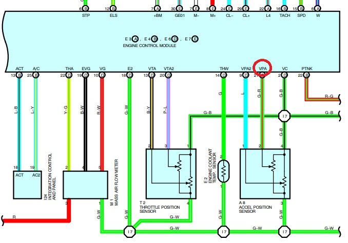

    632968BC-89C7-4EFB-9DBD-2389D619616E.jpg This could be promising... found signal wire on APPS nearly severed. Very well could be the source for the P1120 code and limp mode, and it squares with the intermittent nature of the issue.
    I want to splice and see if that makes a difference. Anyone know what gauge wire this might be? My guess was 20, but smallest I could find at NAPA and AZ was 18. Can’t seem to find any info/replacement on this connector. I confirmed with multimeter this is not the voltage wire or the ground so I believe it’s signal.

    Curious, did you mean P2120 ?
    The reason I ask is because the FSM mentions that code when related to the accel pos sensor !
    Most of the bigger wires like that one are 22awg IIRC. Zooming in, that appears to be a Green w/red tracer that's messed up ? If so, that is the VPA signal that indicates the actual accelerator pedal opening angle and is used for engine control. As shown on the below drawing, it is connector A8....90980−11150

    Wow thanks @BubbaW. Great info! Maybe I’ll just switch out that whole connector vs. the one wire. Hoping to find an OEM part that doesn’t have too long of a ship time.
    The code displays P1120. I do not have the FSM, but my reader and my online searches were bringing up APPS related language. So that’s where I’ve been focusing.
