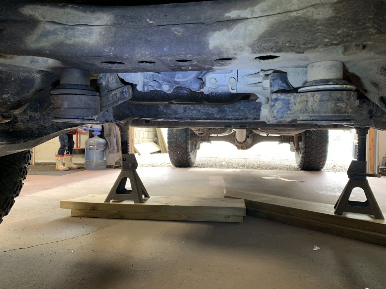

    Correct be if I’m wrong, but does my truck already have a diff drop installed??

  7. Mar 15, 2019 at 4:33 PM
    #37
    TheBeast
    TheBeast The Beach
    Apr 27, 2016
    #3246
    12,576
    SoCal
    2012
  8. Mar 15, 2019 at 4:40 PM
    #38
    Mnorris1206
    Mnorris1206 Super white is fast as f***
    Dec 24, 2018
    #23448
    2,509
    08 tundra
    6" lift kit 35" tires with cold air intake and exhaust
    Looks like the small spacers that came with my 6" lift from rough country.

    Yep haha. I had to order the socket today since I couldn’t find one anywhere in town. Will be in tomorrow then cv axle inspection. Upon further investigation it looks like the boot has a pin hole leak. I’m going to inspect the bearings and see how they look. Hopefully I get lucky with a clean up and grease job then new boots.

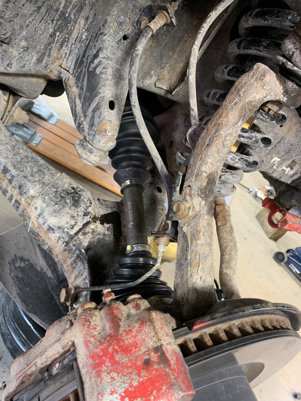

    Pulled apart my drivers side cv joint for inspection after finding grease sprayed all after my truck haha. Looks like a pinch cut in the original boot. After inspection the driverside outer cv joint was clicking so decided to replace both with the heavy duty upgraded cv axles. First side took 2 hours. Passenger too 20 minutes. For anyone planning on doing this do not remove the brakes or hub. Totally a waste of time. Just remove the lower steering bolts from the steering knuckle and the cv fits past it. Glad this is done!

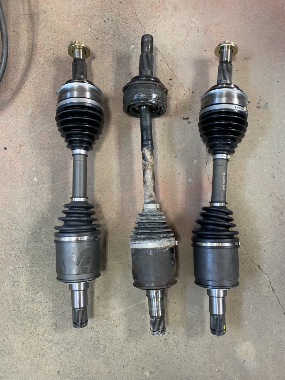

    What part of the axles are heavy duty?

    The boots. And if you look at the shaft it’s thicker. Don’t know what advantage that is besides extra weight?

    Just bought them from the local Napa. They were $210 Canadian a side. Couldn’t tell you the brand name. Although there is a logo looking ‘C’ engraved on the shafts as seen in the picture. The boots seem to be much better quality than oem also.

    I guess I should post a few pics haha. Here’s some comparision
