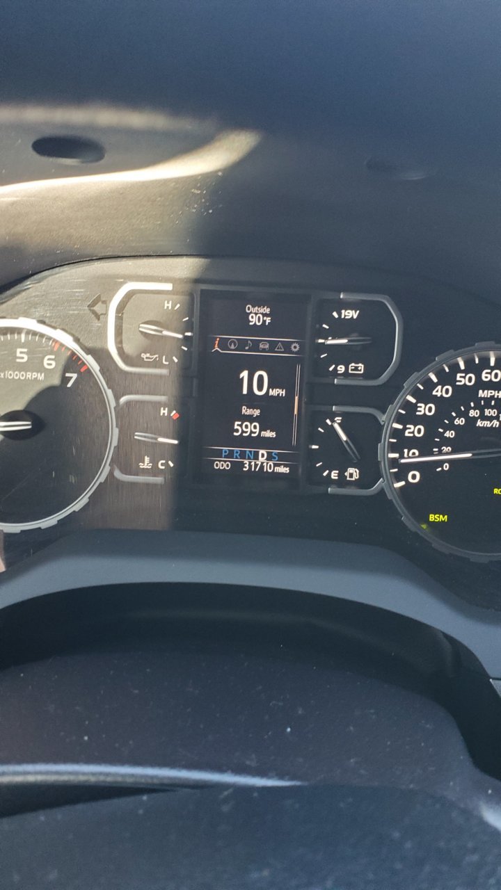

    Today my stock battery on my 2018 4.6 liter just failed completely at a drive through window after 4 years and 40k miles. No warning, it just quit. Now that I’ve replaced it, my gas mileage has increased dramatically. I was getting barely 14 mpg and now it has jumped to closer to 20 mpg. I’ll repost if it turns out to be just a new battery reset glitch, but I hope it’s for real. Has anyone else experienced this? Thx.

    It’s most definitely a battery reset glitch…..just preparing you for the inevitable disappointment
  3. Jul 11, 2022 at 7:26 PM
    164,125
    It’ll level back out over time

    The MPG info you see in your display is data stored in the instrument cluster. When the battery is fully removed the cluster forgets all the previous data and resets. As your drive it will relearn the fuel usage and the number will come back down to where it was. Give it a tank or two to normalize back.
    A good battery is critical to keeping your electrical system operating however a good strong electrical system does not translate to less fuel burned to power the truck.
    It’s still using the same amount of fuel it used to it’s just doesn’t know that yet to display it to you correctly.

    Same thing happened to my 2018 yesterday. I walked outside after work and it was dead. Nothing there, completely gone. What surprised me was that there was no indication of it failing. Anyhow, picked up a Duralast from AutoZone on the way home. My mileage gauge went up too, from 534 to 580. Like to think it'll last but not expecting it.

    It's your computer recalibrating after a new battery... it will go back to "normal" after a couple tanks... but if you were hand calculating your fuel use and not making judgements with your dash suggestions, you may have a happy thing going on...
