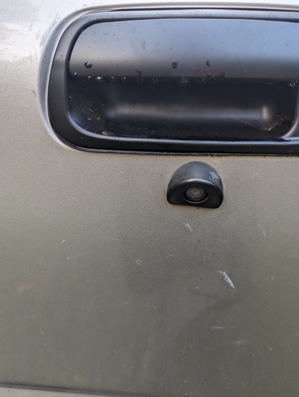

    I have a 06 tundra with the backup camera from factory. I have checked wire going all the way front to back and it's in good condition, but the camera itself won't show a image. I have tried to find a replacement but can't seem to come up with anything. Would anyone know where I could find a replacement that would work? Or possibly wire in a aftermarket? The camera unplugs from inside the tailgate and it's a 6 pin almost like a mini XLR. Any advice is appreciated.

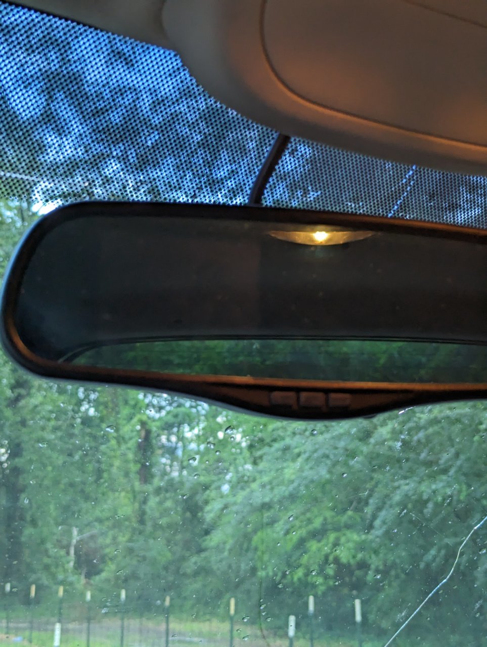

    I am not original owner but I own it. It is the Darrel Waltrip edition, which I guess came with a backup camera. The camera lens just seems foggy/water damage and just displays white image. It threw me off too.. 06 with backup camera?? The image is displayed on the rearview mirror, which is also OEM from Toyota which is only reason I assumed it is factory as it is hard wired into mirror. Its like a 3-4 inch screen on left side of mirror. I see now it isn't very common, so it must be because of the edition I have. Its only 2WD but it has full TRD package with TRD BBS wheels, exhaust, etc. I have tried to do research on it and came up dry as far as fixing/ replacing it.

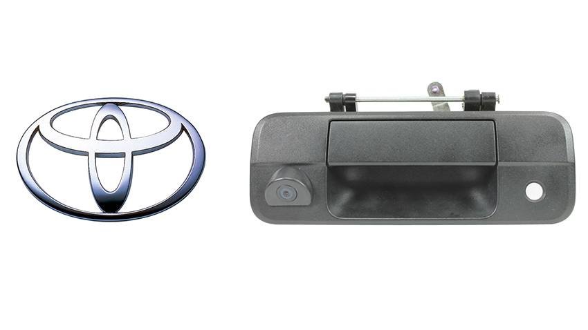

    I want to add I did find ONE thing I forgot about to mention that I came across. I found this part, could be aftermarket or something but I know 2nd gen Tundras has backup cams like this right? But the camera in this picture looks almost 1:1 with the one I have. Possibly someone snagged one from a 2nd gen? This is image I saved from google as I was looking at 2nd gen stuff a few days ago.

    I'm 99% certain none of these were stock options from the factory. We would've seen it on here from someone at this point, and it would show up in a catalog. I looked up several Darrel Waltrip edition 1GTs and I'm not seeing any with it. It's probably just a great install job from a shop. If the mirror was actually factory OEM, it'd have a Toyota part number on it somewhere, typically on the back. I doubt it's the case.

    Correct I just wanted to replace it with OEM camera if it was one, that was what I was aiming for really. My owners manual is also for some reason for the 07 model and it looks almost brand new which is odd. I've had the truck for a little over a month now and just figuring stuff out. I will definitely check Crutchfield out! Its also a 6 pin, not 8. Looks like what I attached.

    Possible that someone put a 2nd gen cam on your 1st gen. Its not a factory install for sure. The camera is crooked. LOL
