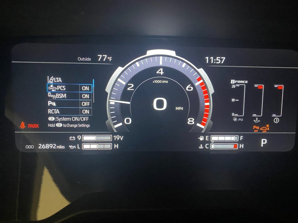

    Only if you have Auto Trailer Detection (ATD) on. If it's off, you have to manually turn the Parking Support Brake button off. I leave ATD on.
    Here's my every day dash display, except for the menu on the left. I usually have the fuel mileage display there.
    As you can see, I have Intuitive Parking Assist off, because I hate all the warning buzzers and visuals. They are just distracting to me. I also have the Parking Support Brake (PKSB) off. That's the button on the dash with the car backing into a cone.
    When I plug in a 4-pin trailer, the Rear Corner Traffic Alert (RCTA) light also appears on the dash. So, my truck auto detects the 4-pin trailer and disables the RCTA.
    That's all I've ever done to tow a 4-pin trailer, which is what is on both of my boats and utility trailer. I've never had any problems with backing them up.
