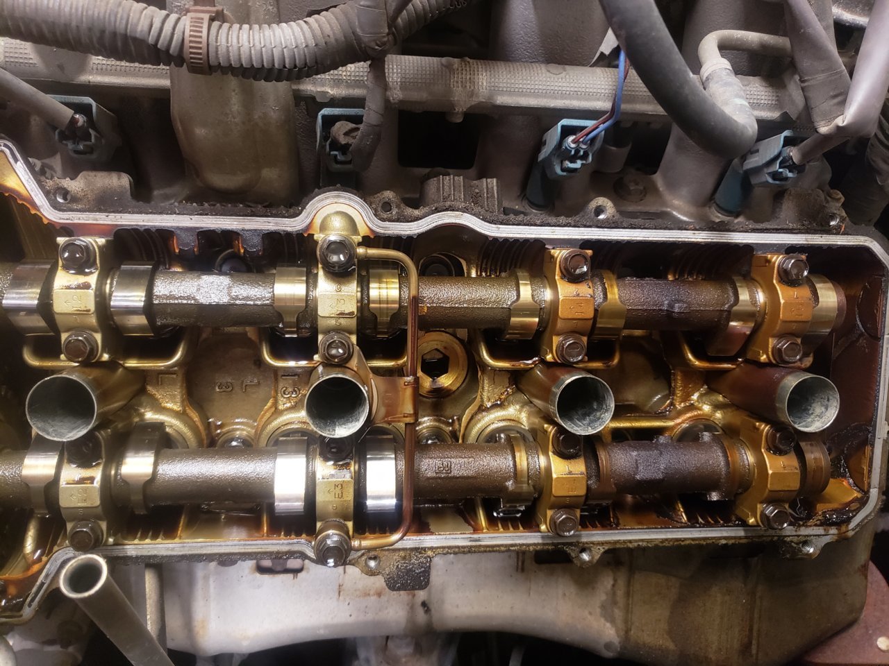

    I had my valve cover gaskets replaced this past Tuesday and we checked out the tension on the springs, they all seemed to be all the same, nice and tight. I also replaced my PCV valve which the dealer didn't stock, ordered it from advanced auto and drove it down the road. The popping went away, however the lack of power was still there. I removed the catalyst on the passenger side, because that's the side with the misfire, son of a gun ran like a new one, so the cat was my main problem and I'm tickled that it's back to normal again. I hope this helps someone else and I've noticed my gas mileage up to 15.8 mpg on this tank and it had ran a day or so before on this tank full before I had the work done.

  17. Dec 22, 2018 at 6:40 AM
    #47

    Do you have pics?

    [ ATTACH=full]217276[/ATTACH] 20181218_103558.jpg
