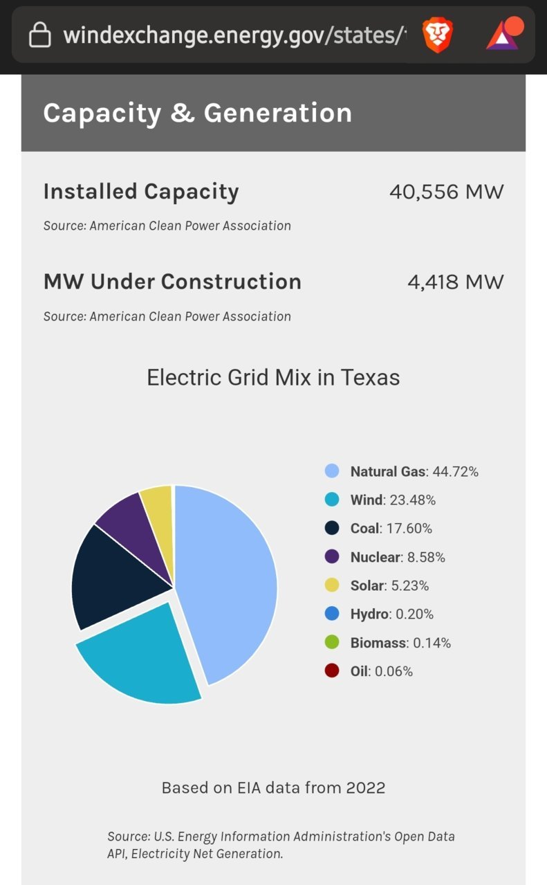

    Apparently we supply the country with 25% of its wind energy

    Good info. It’s a shame all that % of wind and solar is so unreliable. fundamentally unreliable.
    nat gas/coal/nuclear should be the sell.
    See, the result of unreliability is harmful to humans, yet we pursue these as reliable.
    It’s foolish

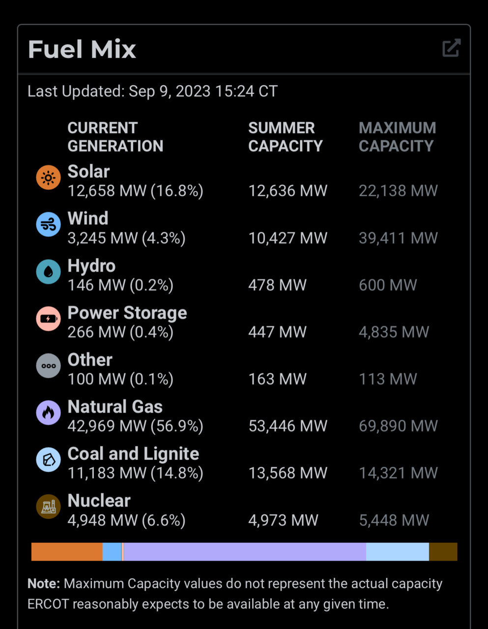

    Even more of a shame is wind/solar go away quickly. Guess what, the Transmission System Operator can't use spinning reserves (emergency power) to cover it. Isn't that a bitch?
    We are taking down our last coal unit in '28 sometime, but we are just mothballing it. Heard some rumors about retrofitting a modular nuke unit next door.
    Glad I will be retired by next year. Being on nuclear sites is a PITA.

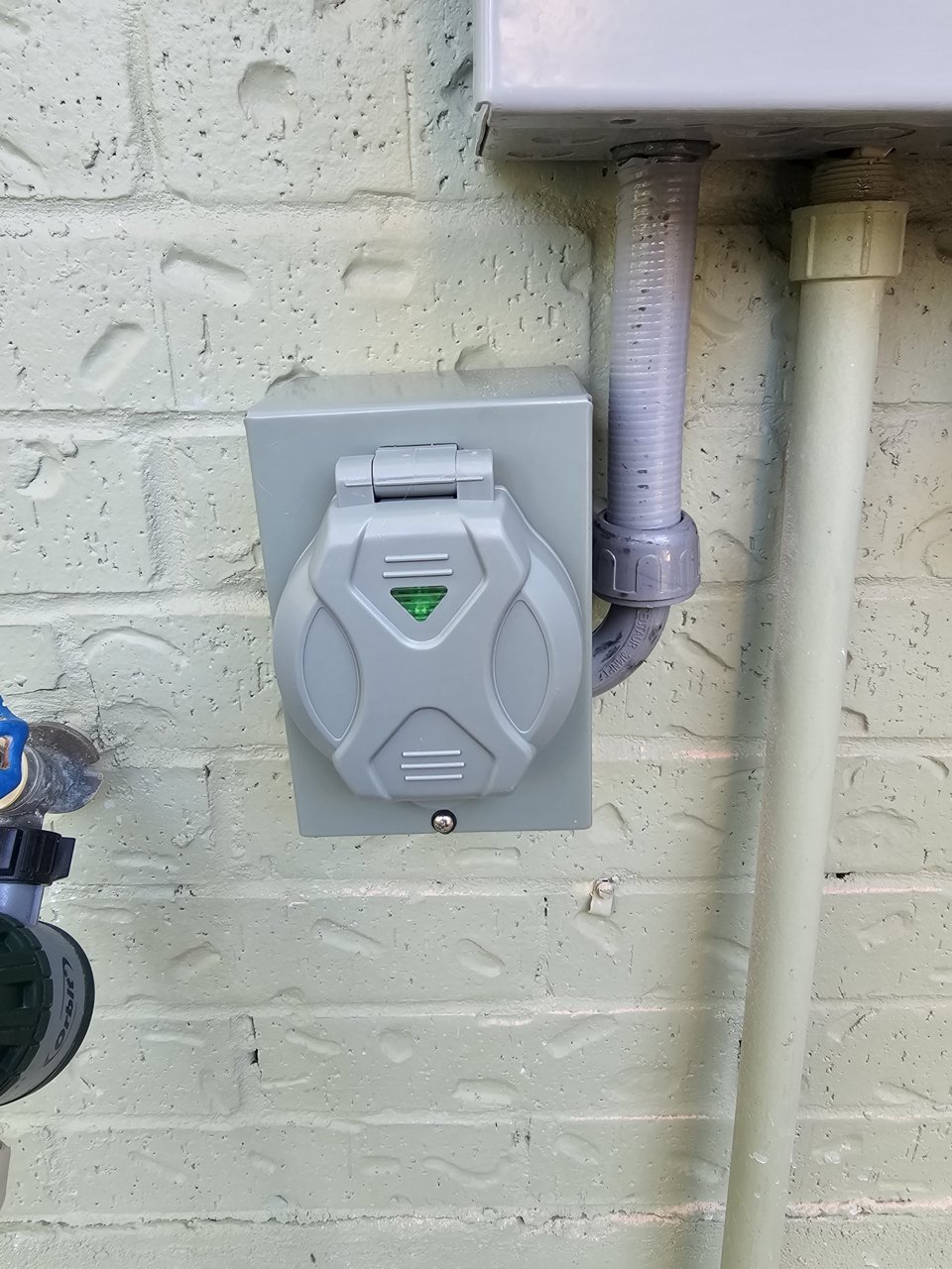

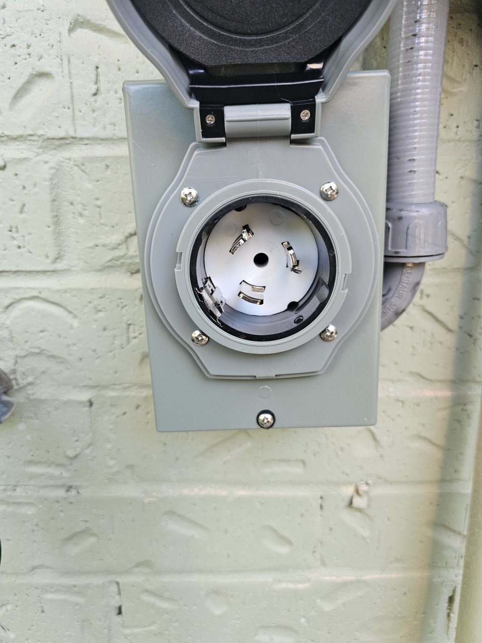

    Update: The electrician came by today and installed an interlock kit. We re-checked the load of just the heater because I was concerned about the 100A breaker for just that and it came in at 80A (19.2kw) He said sounds about right. No wonder our winter electric bill is the GDP of a small 3rd world country.
    Pics of the installation:
    The gas company also came out, staked, and measured. He asked me what pressure was required by the Duromax to operate, and of course, I didn't know. After some research, it appears that water columns is how that's measured (huh?) and that I need 7" wc. That's 1/2 PSI and about normal pressure out of a household gas line. Cool - won't have to fork out another $350 to the gas man (extra $ needed if pressure would need to be upped out of the meter).
    Anyway, after much discussion, we are gonna go with a DuroMax XP15000HXT tri-fuel setup and primarily run on propane courtesy of a 100 Gal tank and also have NG as a backup energy source should things go long term or full zombie apocalypse. Now I'm researching propane regulators and quick connect fittings.
    Mater and nobodyintexas like this.
