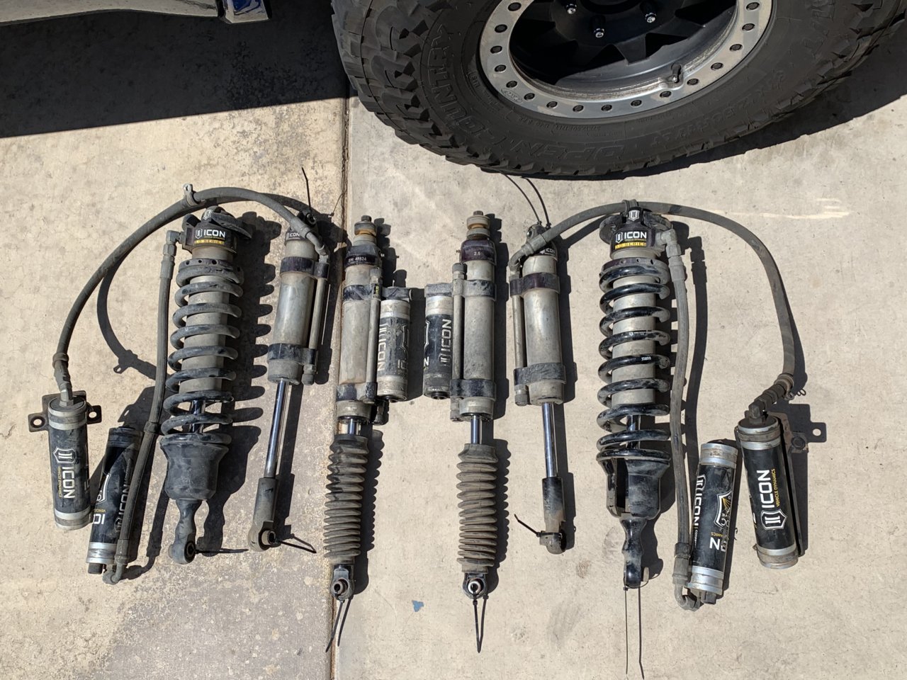

    It wasn’t exactly easy since we were the first dumbasses to try it, but now it’s readily repeatable.
    the coilover is a 3.0 (3” diameter shock body) with compression adjustment and an internal 2” bump stop.
    • Controls body roll and pitch during daily driving (slow speed events [shaft speed, not vehicle speed])
    • Compression is set soft for a Caddy level of comfort on street
    • When we go off road on moderate trails I’ll turn compression up to maybe 5/10 to allow some compliance through choppy stuff but resist some of the more aggressive bumps and washouts
    • Turn it to 10/10 for jumps and whoop sections or anytime we’re truly high speed in unfamiliar territory with possible hidden g outs
    2.5 bypass (2.5” diameter shock body) has three distinct zones of adjustment - bump, ride, droop.
    • At full bump the tire is all the way up in the wheel well, and the shock piston is all the way inside the bump zone. When the piston enters that zone, the shock fluid no longer ‘bypasses’ the piston, and the valves on the piston are in full control of the compression damping. (This zone comes into play slightly before the bump zone inside the 3.0, creating smooth transitions from less damping to 100% damping ability).
    • The ride zone is where the tire is at during most of your normal street and mild off road driving. In this area you (or at least I) want a smooth digressive shock curve. A digressive shock moves faster the harder you hit it, but more strongly resists low speed shaft movements (see note below on shaft speed). This means that in the ride zone, body roll and pitch (slow speed events) are controlled and predictable, while the small washboard and babyheads and ruts (high speed events) are allowed to push the tire out of the way and snap back quickly without transferring that shock to the frame/body. The small choppy stuff smooths out more at higher speeds. [progressive shocks do the opposite, the harder you hit them, the more they resist, and the more they transmit to the frame. Great for racing control, terrible for comfort.] This ride zone is controlled with the bypass tubes. The tubes have their own little valves that allow fluid to flow from one side of the piston to the other as it moves and “bypass” the piston valves which are firmer than the soft bypass valves. This allows the ride zone to be smoother on small fast inputs and more comfy.
    • The droop zone is when the tire is all the way out of the wheel well and dangling by the suspension. Unless limited by a strap as is don’t for long travel, the shock is the limiting factor in how far the tire can droop. The shock length is set to stop the droop shortly before the upper control arm uniball reaches its angular limit and breaks. There is a shock zone in the bypass at the bottom to add more resistance to the drooping out so when you jump the truck or otherwise let the tire drop free and fast, there isn’t a loud and uncomfortable BANG when the end of the shock travel is reached. The damping force for this is controlled by the rebound damping valves on the piston after it passes the end of the bypass tube.
    it all gets sort of complicated from there. Unfortunately the above is a pretty simplified version of what’s going on and leaves out a lot.
    There’s also spindle gussets visible in the pic. Those are welded on to help prevent bending the stock spindle on bigger hits. Not visible are cam tab gussets that help keep the alignment cams from flattening the stock flimsy tabs.
    This is what Tundras to Sedona is for. Hard to find a couple hundred Tundras in the dirt in one place at the same time any other way.

    I like how well Ryan describes everything, but I disagree with his assertion that washboard and small choppy stuff is low speed on the shock curve. I know he tuned digressive shocks for a long time and has a ton of actual experience, but I think he’s wrong on that one piece. And it’s a crucial piece to the comfort aspect.
    As far as I’ve been able to figure, and have asked this of several other tuners who agree, washboard and small choppy stuff is actually a high speed shaft event. Exactly how Ryan described square edge events at the top of the curve. They are nearly instantaneous compression/rebound events of 3-6” tire travel, so roughly 1.5-3” of shock travel. The piston will move plenty to blow open the stack and enter the high speed portion of the valving.
    This is the part where it gets complicated as I noted above, and as @BiggHertz noted is as much voodoo as it is science.
    Long story short, if you’re looking to spend several thousand dollars, get a few rides first.
    Once ours are all rebuilt and put back on, I’m happy to take you for a spin. I suggest finding someone with Kings, Fox or ADS to also compare. All the hypothesis in the world won’t make up for what your ass feels in the seat. ;)

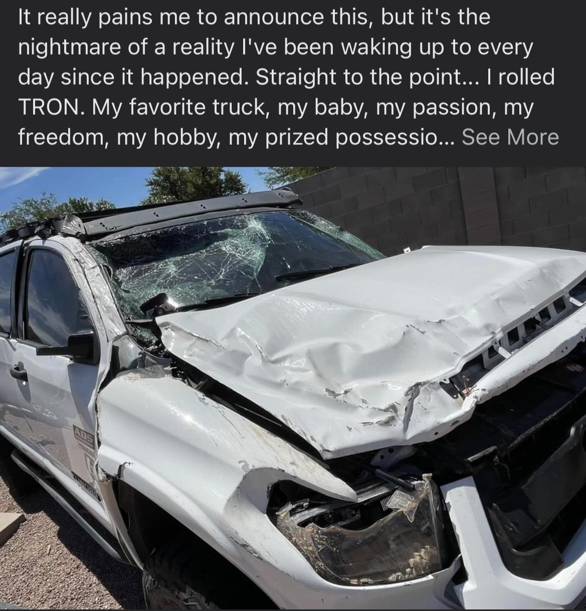

    Since I haven’t seen Tron post on here in a while, and a lot of us aren’t on Facebook, and many of us looked at his build for inspiration, I figured I’d post this here for awareness. He’s okay, but the truck is done. Sad times…

    Oh man...that sucks. Glad he's okay. I had been following his build for quite some time.

    Saw this earlier, sad day but I'm sure the new build will be better!

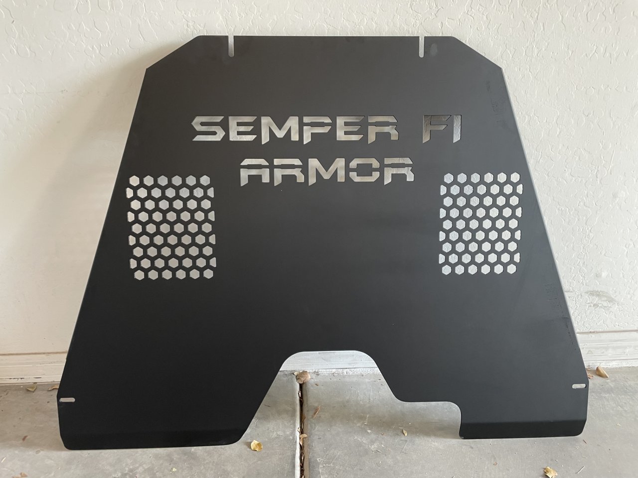

    FYI, cat protection plates are in stock at Bedliner Veterans in Mesa. Semper Fi Armor is their body/truck armor brand. Pretty cool stuff. Hoping to get this thing installed and do a write up soon.

    Price?

    $325 for the initial run. Not sure if they’re going to hike it going forward. I think they built 35 plates or so in this first run.
