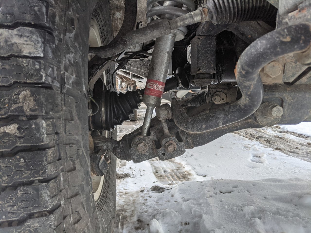

    well... i have no idea. if i take a picture would that help? Where should i look? Like i said, i bought the truck with the lift kit already installed.

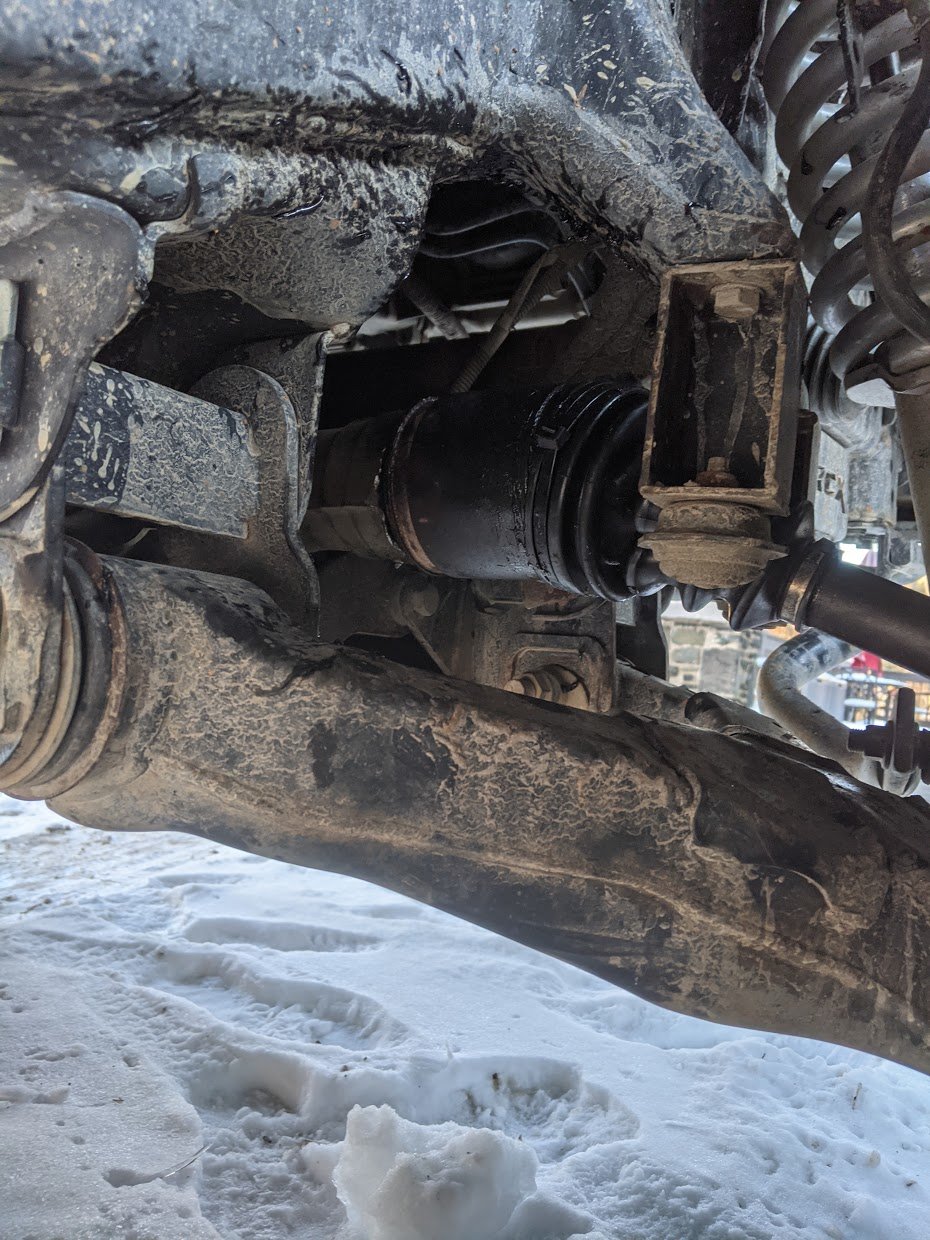

  13. Feb 3, 2021 at 2:25 PM
    paulk
    paulk [OP] New Member
    Jun 19, 2018
    #16275
    25
    Paul
    Toyota Tundra Crew Max 2012, Lifted on 36" STT's
    Rack, Lift

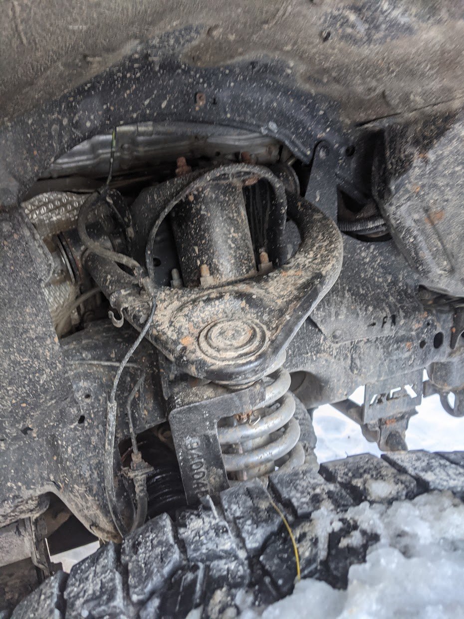

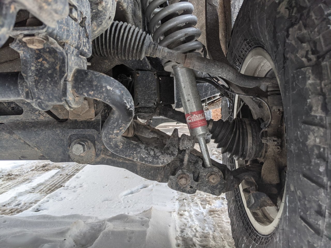

    ok, so im going to go with "i think so" now....
    I assume that is what this bar here is...
    In this image you can see the boot separating as it popped out again...
    And some other images that may be helpful.
  14. Feb 3, 2021 at 2:34 PM
    timsp8
    timsp8 Former Tundra owner for 13 years
    May 11, 2018
    #15231
    3,540
    NY
    2018 Tundra Limited Crewmax - Traded In
    That bar is the drop bracket for the lift. I can’t see the area the diff drop kit would be. Take a pic of your cv axles straight on with the truck on the ground and tires pointed straight. Get the angle.

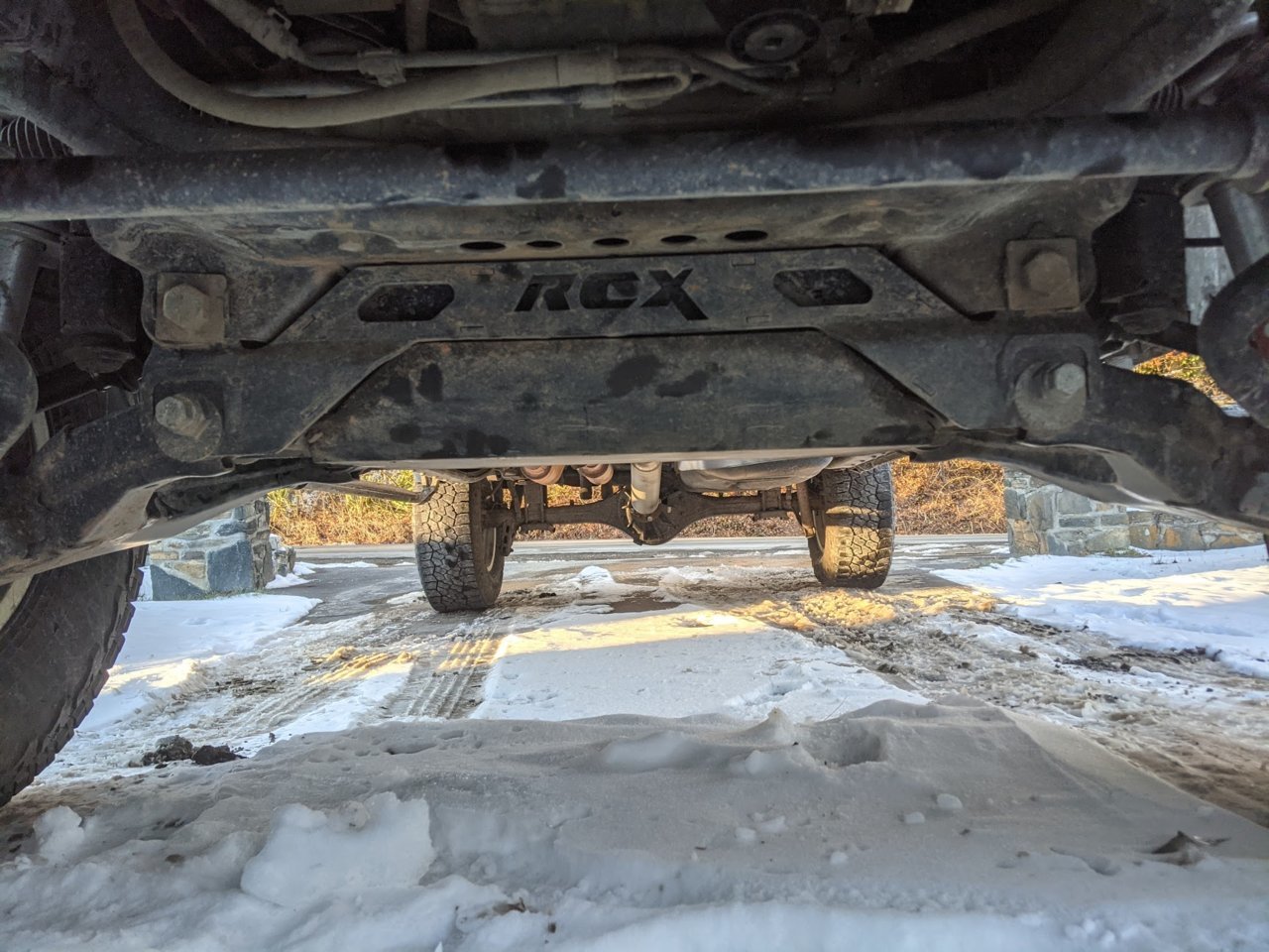

  15. Feb 3, 2021 at 2:44 PM
    paulk
    Jun 19, 2018
    #16275
    25
    Paul
    Rack, Lift
    left and right side. taken as suggested.
  16. Feb 3, 2021 at 2:45 PM
    Hbjeff
    Hbjeff New Member
    Jan 20, 2019
    #24845
    5,119
    Huntington Beach
    2010 DC 5.7 2wd
    You dont need a diff drop with a bracket lift guys.
    my guess is that this is a 4 inch lift, maybe the diff isn’t PERFECTLY centered with the lift kit, and these extra lift springs the axle is too angled on that side.
    jeremyd likes this.
  17. Feb 3, 2021 at 2:46 PM
    paulk
    Jun 19, 2018
    #16275
    25
    Paul
    Rack, Lift
    I looked for those spacers, but like the entire diff is hidden by the protective plate. Even around the back of the diff its encased, so i could not get an image or see if they were there.

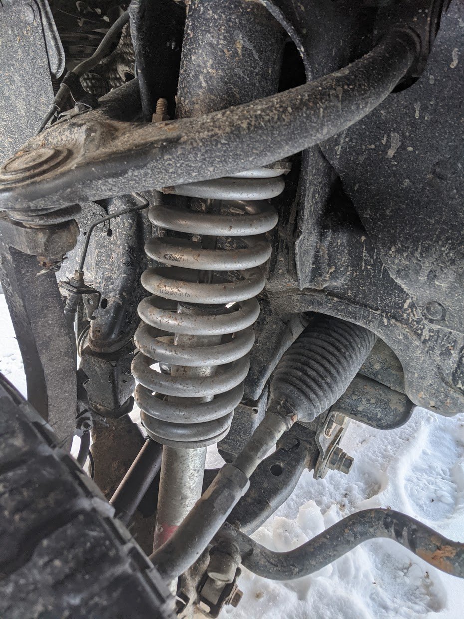

  18. Feb 3, 2021 at 2:53 PM
    paulk
    Jun 19, 2018
    #16275
    25
    Paul
    Rack, Lift
    @Hbjeff thanks for the input, but im pretty sure this is a 6" lift. When i swapped out the coilovers the stock ones had a 2" spacer and then the big 4" spacer you currently see in the image (above the coilover). The eibachs were taller so we removed the additional 2" spacer. the truck was level again with the 2" longer coilovers + the 4" spacer.
    In fact. here i can show the before and after....
    Stock Coilovers with 2" spacer and 4" spacer.
    and here is the taller eibachs with only the 4" spacer.
  19. Feb 3, 2021 at 2:56 PM
    timsp8
    May 11, 2018
    #15231
    3,540
    NY
    I never had a drop bracket lift so I wasn’t sure, but the angles on his cv axles look pretty big.
    Hbjeff[QUOTED] likes this.

  21. Feb 3, 2021 at 2:57 PM
    Hbjeff
    Hbjeff New Member
    Jan 20, 2019
    #24845
    5,119
    Huntington Beach
    2010 DC 5.7 2wd
    You might be right. Just to be sure, measure the distance of the lca mounting bolt at the frame to the old mount. Those bolts are either 4 or 6 inches apart.
    strange if you’re still at 6 inches of lift tho

  25. Feb 3, 2021 at 3:14 PM
    #25
    Ryuu
    Ryuu Hwat!?
    Apr 23, 2018
    #14693
    892
    Oscar
    SouthEast, TX
    2017 TRD PRO Barcelona Red
    a few
    Did you receive the Eibachs preassembled?
    Looking closely at the pics, kinda looks like they’re set to the 3” instead of the 2”
    Just glanced quickly over some info on those coilovers, seems like the notch you’re on is 2” of lift if you use the stock coils than come on the truck. The ones you have seem to be eibachs and those give close to 3” of lift instead of 2” on the notch you’re on. Might just have to drop the spring perch to the very bottom notch.
    That’s what I understood from the documentation I looked over. Hope it helps.
    Hbjeff likes this.
  26. Feb 3, 2021 at 3:23 PM
    #26
    Hbjeff
    Hbjeff New Member
    Jan 20, 2019
    #24845
    5,119
    Huntington Beach
    2010 DC 5.7 2wd
    Circled the two bolts that will tell you the drop bracket height
    Ryuu likes this.
  27. Feb 3, 2021 at 3:35 PM
    #27
    jeremyd
    jeremyd 2014 Crewmax SR5
    May 9, 2016
    #3336
    1,469
    NV
    2014 SR5 CM 4X4
    ProComp 7" 35/12.50/18 -11
    I agree, this looks like a 4 inch that was turned into a 6 inch at a later date. The angle of the cv's is way steep..
    Ryuu and Hbjeff[QUOTED] like this.
  28. Feb 3, 2021 at 5:04 PM
    #28
    paulk
    Jun 19, 2018
    #16275
    25
    Paul
    Rack, Lift
    yep, 4" distance from bolt to bolt on center.
    Ryuu and Hbjeff like this.
  29. Feb 3, 2021 at 5:06 PM
    #29
    paulk
    Jun 19, 2018
    #16275
    25
    Paul
    Rack, Lift
    Sooo..... do i need maybe a 2" spacer then instead of a 4" spacer since the Eibachs are an additional 2" of lift over the 4" spacer?
