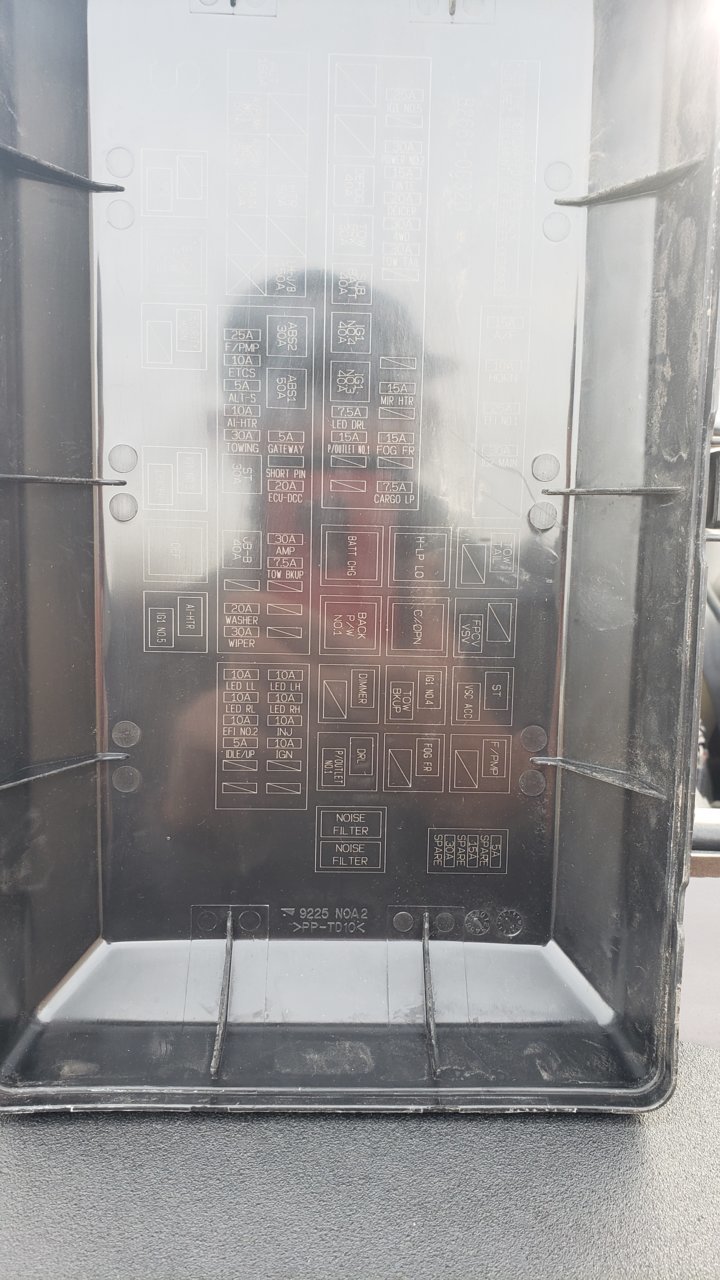

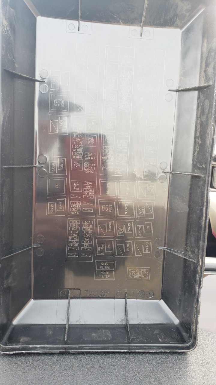

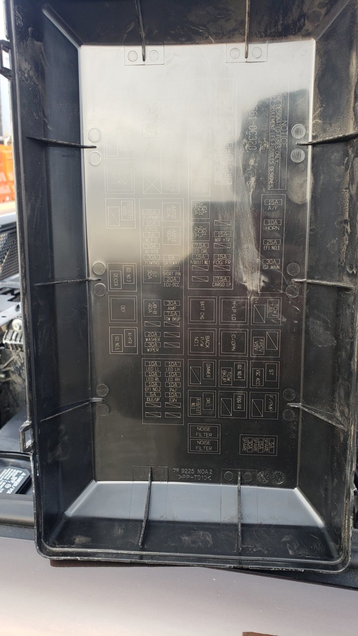

    So where are you all mounting your 60 amp bracker?
  26. Dec 14, 2021 at 9:19 AM
    #56
    Sonicbluerider
    Sonicbluerider New Member
    Apr 27, 2019
    #29703
    522
    Dennis
    2019 Tundra
    Ya bad pictures, but combined u can c them..SO FOUND ING FUSE..CAN ANYONE POINT OUT USB/ CIGARETTE LIGHTER..THANK20211214_090909.jpg 20211214_090909.jpg 20211214_090846.jpg
  27. Dec 14, 2021 at 9:44 AM
    #57
    pvn.beluga
    pvn.beluga [OP] New Member
    Dec 28, 2020
    #56744
    2,009
    Phuc (Phooc)
    Connecticut
  28. Dec 14, 2021 at 11:11 AM
    #58
    Sonicbluerider
    Apr 27, 2019
    #29703
    522
    Dennis
    2019 Tundra
    thanks! ing it is then
