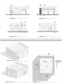

    I always thought buy fully spec’d to “future proof” & recently been trying to just have an intern do the work.
    Almost switched to archicad just to be able to run on Mac, but I taught myself revit quicker, also is cheaper license
