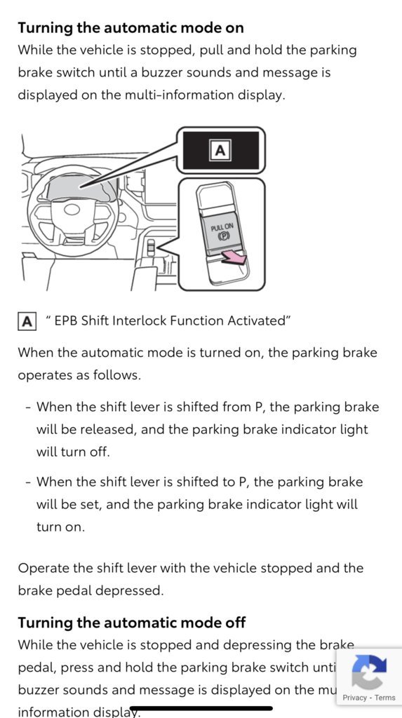

    Put your foot on the brake and pull the parking brake button out for 3 seconds.:thumbsup:

    Thanks @DRP! I can do this, but previously I didn’t have to pull the parking brake button out. The brake would engage automatically after I put the Tundra in park while braking. I liked that functionality and am trying to find out how to turn it back on.

    If you hold it out for 3 seconds in will reenable the auto function. You'll know its reenabled when the message that its been reenabled pops up on your dash. Trust me and @olafman1 on this.:):thumbsup: (did I set the record for most times the word reenable has been used in a post?)

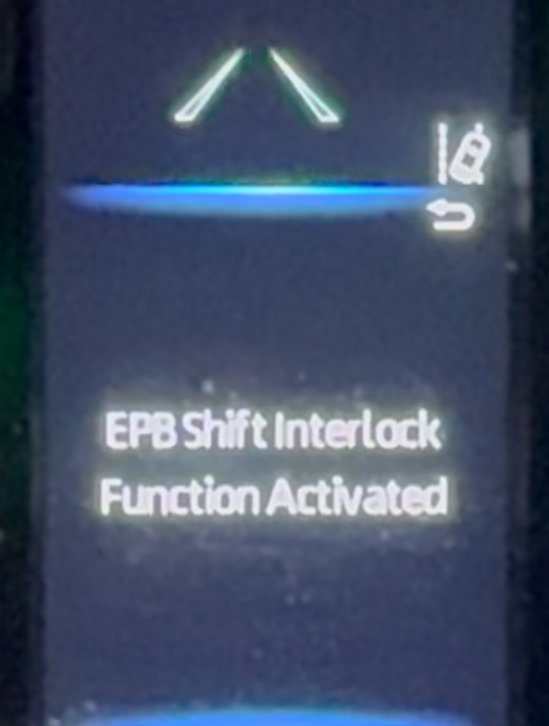

    Just reading this now- thank you @olafman1 and @DRP!!! Thought I was crazy, absolutely couldn’t find the way to turn this on again. Tried HOLD for a week and that’s not it at all. Thx to your posts learned the feature is called “EPB Shift Interlock Function Activation” WTF lol ;)
    Going to try it right now. Thank you both!!
    PS worked like a charm! Much appreciated so pleased!
