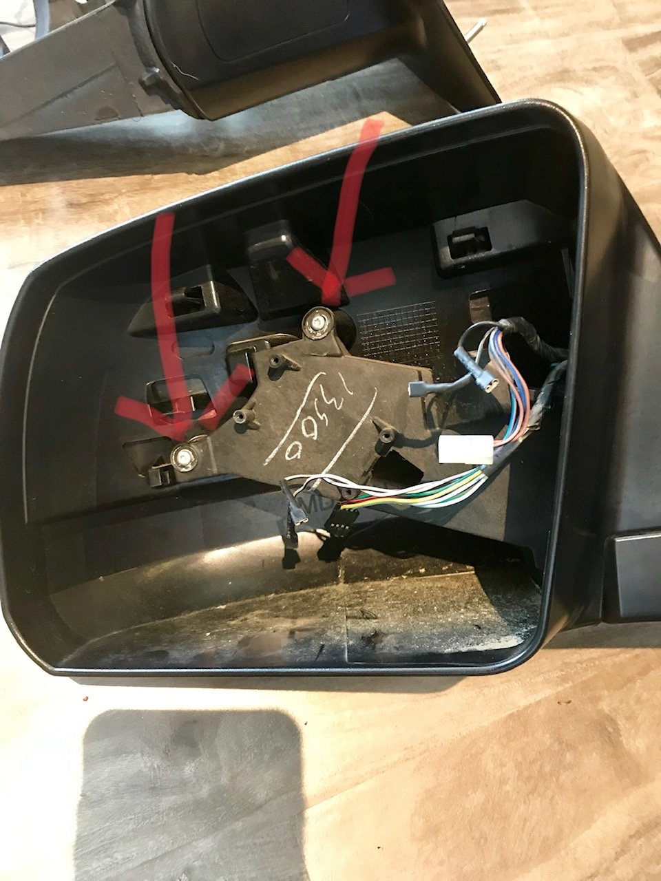

    Well I finally did this mod. I have a 2018 SR5 w/o memory. It went pretty good, all the wire locations were as everybody said but some of my colors were different. I ran the passenger wire above the plate under the glovebox without dropping anything else and ran it between the HVAC box and the firewall and then over the steering column. Everything zip tied out of the way.
    I got the folding mirrors off FB marketplace for $50 but they ended up being gouged up. I found out I could separate the housings from the folding arm assy by removing the 4 screws that hold the mirror adjustment plate and then the 2 screws that hold the arm to the housing then install my old, nice housings (see pictures). Now I've just got to make holes in the housings for the puddle lights (another day). Good news, these housings CAN be swapped.

    This is great news, but I'm curious as to whether or not you were able to separate the arm from the mounting plate. I grabbed a set of 2012 mirrors to put on my 2018 Limited and they're OK, but they're missing the vortex generator on the mounting plate and the passenger side stop seems t be broken. The passenger mirror doesn't stop until it hits the window. I'd love it if I could get the actuator into the original arms.

    I don’t think you can put the actuator in the arm that wasn’t made for it, they are made different in that area. What are you calling a vortex generator?

    Bummer. At least maybe I can take it apart enough to see if I can repair the stop.
    The vortex generator is that ridge on the outside of the mounting plate. The 3rd gens have 1 on the mirror and two on each taillight. Supposedly they help with aerodynamics and maybe gain a microscopic amount of mpg.

    I don’t think it’s possible to separate the arm from the mounting plate easily. That is a very stiff spring in there.
