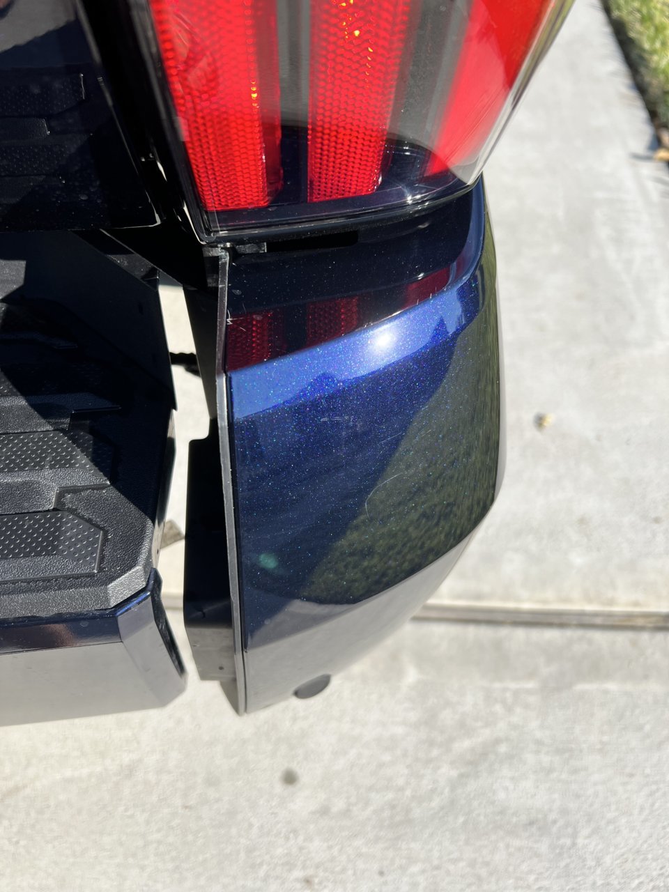

    The auto car was has been pulling the rear corner panels off their brackets. The panels that are on either side of the rear bumper. Has anyone else had this problem? Is there a fix?
    Currently i climb under with hit the clip back into place. This is a new truck and i should not need to do that after 80% of my car w
    ashes.

    that sucks…I don’t do auto car washes but as @Eurodriver has said this 3rd Gen bumper ends are crap as it.
    You can pull on it and it wants to separate so not surprised it’s happening easily in car washes.

    So at the dealers now. Their fix is replacing the body panel with the same compression fitting. I feel this is a temporary fix. It is going to fail again! Might just hit it with some gorilla glue….

    I had the same problem on my 2023 also. The inner black mounding that the panel clips onto was not properly secured. The washers must have broke through or were not installed. Easy fix though. Thanks for C4 rear bumper install video, took off rear passenger panel. Put some new washers in to hold black bumper attachment in place and snapped bumper right back in.

    Likely there is a clip bent somewhere that just doesn't have the holding power it needs anymore.
