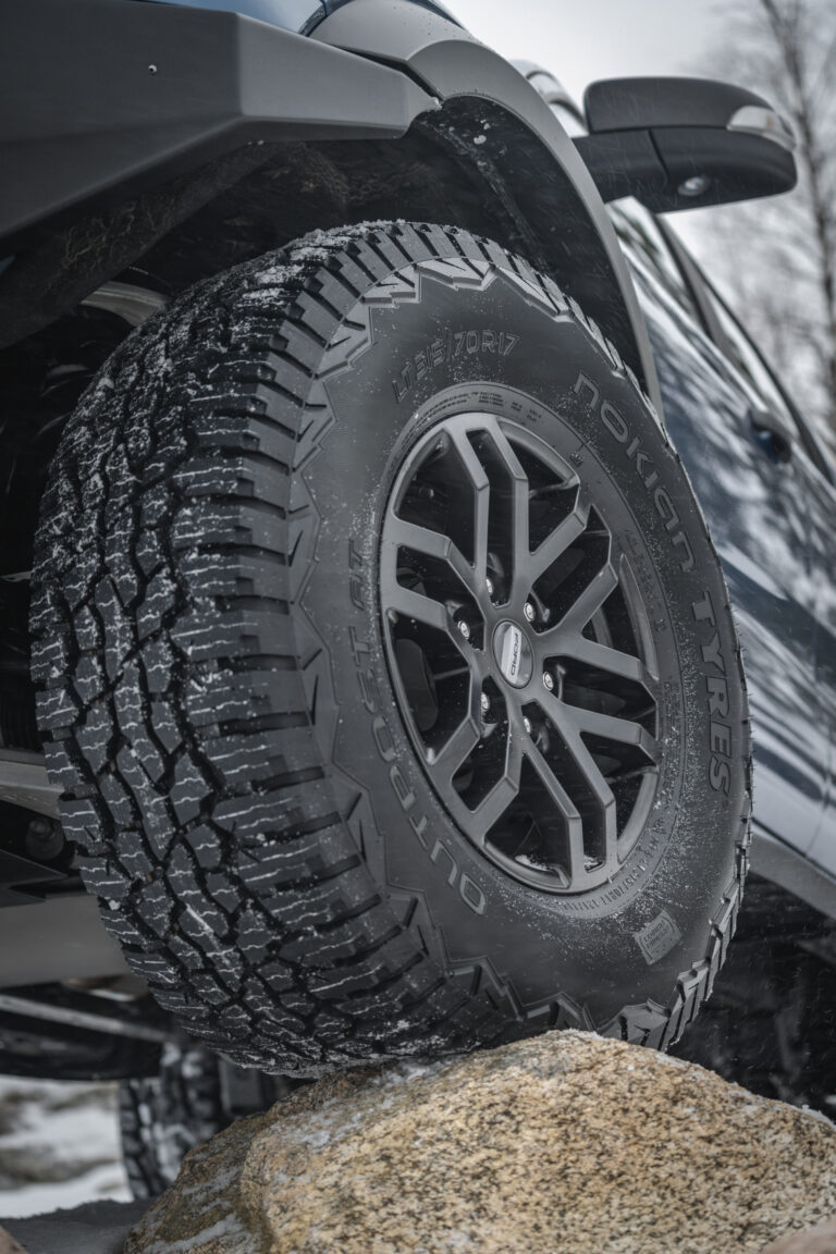

    Pulled the trigger today on (5) Nokian Outpost AT 315/70/17 to go with the RRW RR7’s. Found them on Amazon for a good deal, free shipping, no tax.
    Kiddnapped Tundra likes this.

    I’m intrigued by those Nokians for our next tire. How have you liked them thus far??
    Have had good success with other Nokians in the past.

    Nokians so far have been superb. Brilliant traction in the wet, and mild mannered for an AT. Would buy again especially for the prices you can still grab them at compared to the competition in the C and D ranges.
