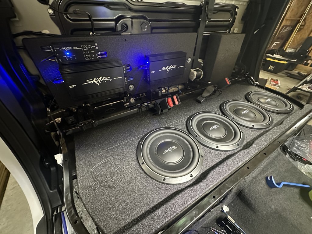

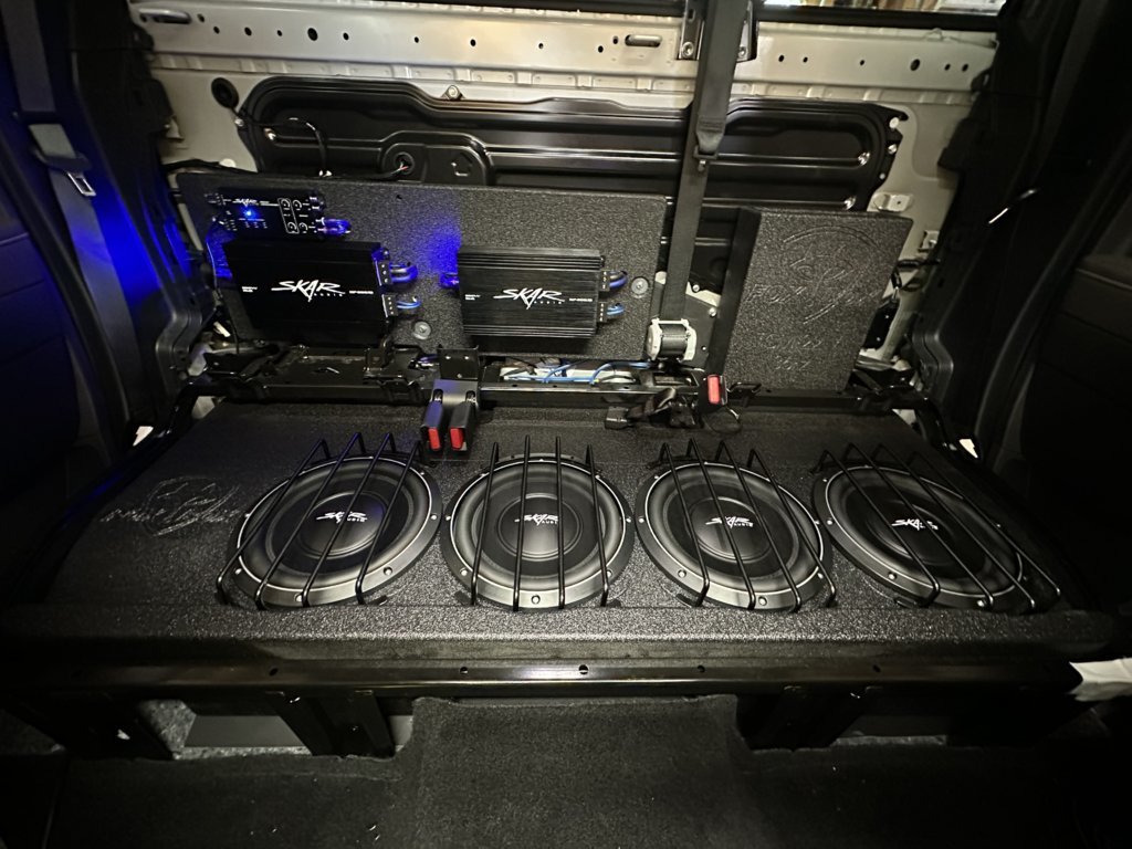

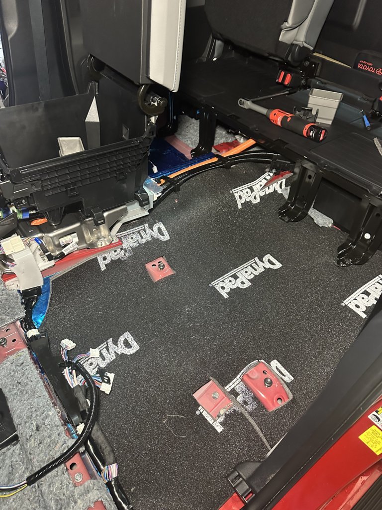

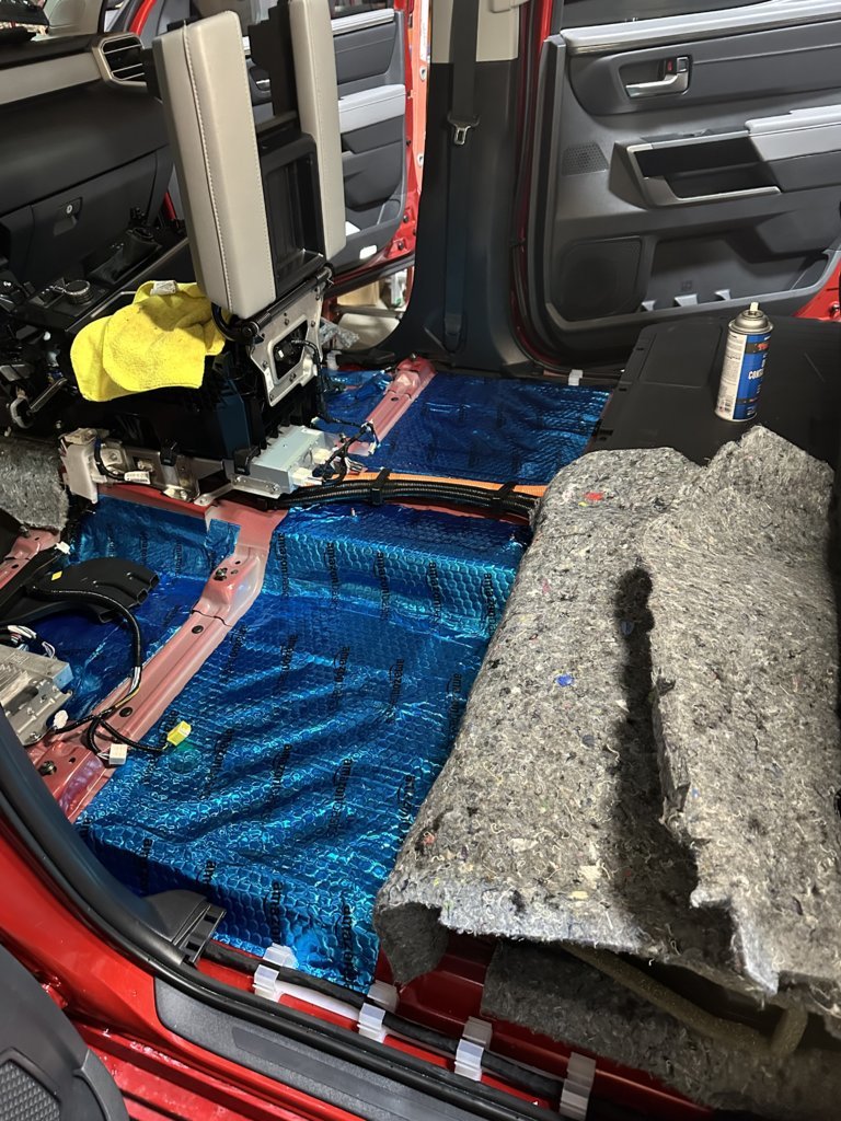

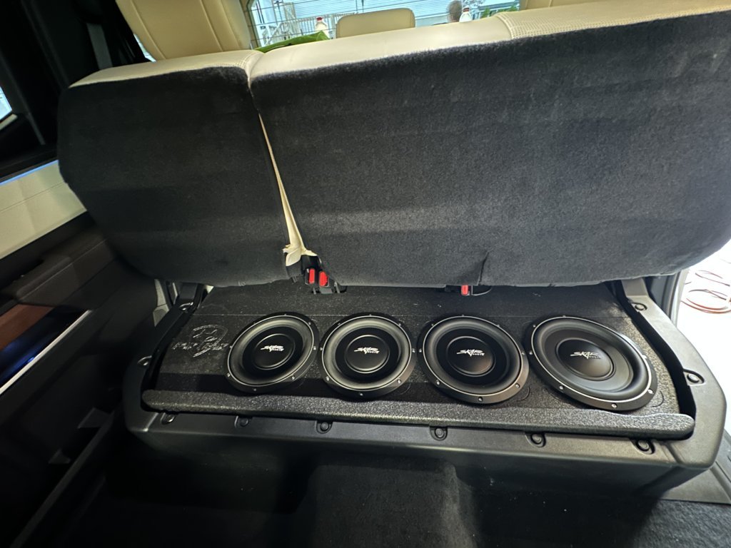

    Recently installed four 10” subs, running off of two 800w monoblock amps being passed a signal from an active loc. Subs are wired in pairs down to 1 ohm. Tuned the system with a DD-1. They easily overpower the mids and highs if I have the gain knob turned up, but I dont drive around like that. Sounds very clean, happy with it. Plan to upgrade the rest of the system down the road once I understand more about it given the JBL amp already in place. I took pics of every step through the process, so many photos. IMG_8401.jpg IMG_8390.jpg IMG_8403.jpg

    4 10’s! Go big or go home!

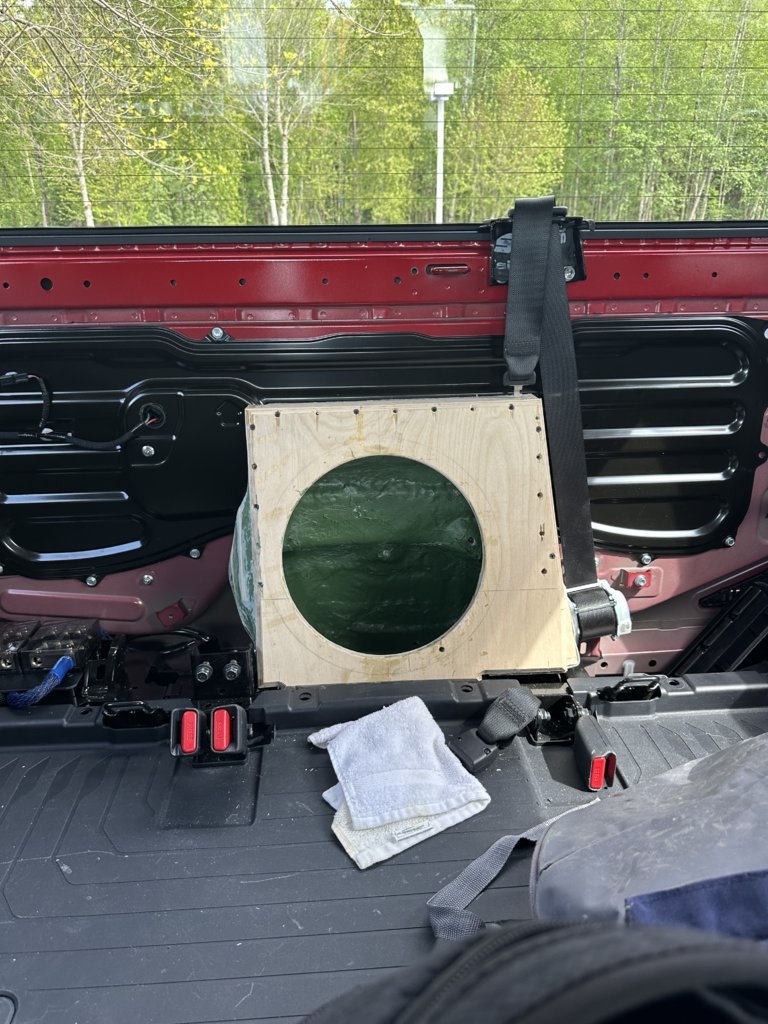

    My current situation. I have a Hybrid so no under seat space. Had to glass a small enclosure for a single 12. Need to finish the box, add the amp racks on either side, beauty panel, then finish in vinyl. Getting closer but still a lot g ways to go.
