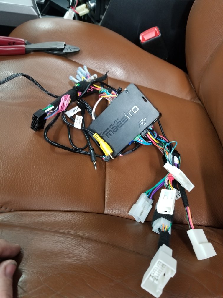

    I had a local shop here in Tucson do my initial stereo build. I did my due diligence. Got multiple quotes, checked out shops in person and read countless reviews. I felt like I found the perfect place to get my truck done. I was terribly wrong. Here are a couple highlights
    - Broken trim plate for the headunit
    - Used aluminum speaker wire instead of copper
    - Grounded the sub amp to a partially painted part of the truck. Sub amp would cut out
    - Headunit would shut off and restart on it's own
    - Cut through the antenna cable and "reconnected" it
    - Used scraps of sound mat instead of full sheets
    - Speaker "pods" were drilled into the door panels with roofing screws.
    - Said they used a idatata link for my steering wheel but used some cheep crutchfield one instead
    - Alarm would lose connection with remote. Would have to bypass alarm to get it started
    I'm sure I'm missing some stuff but basically a complete disaster. Truck looked good/sounded good at first but over the the first 6 months or so it started to slowly fall apart.
    IMG_7500.jpg IMG_7579.jpg IMG_7577.jpg IMG_7578.jpg IMG_7569.jpg IMG_7568.jpg IMG_7571.jpg IMG_7567.jpg IMG_7570.jpg IMG_7572.jpg IMG_7582.jpg IMG_7584.jpg IMG_7580.jpg IMG_7502.jpg IMG_7501.jpg IMG_7840.jpg IMG_7828.jpg IMG_7842.jpg

    Part 2 the rebuild
    Took the truck to James Scheppelmann at Kartunes in Tempe, AZ. James specializes in Toyotas and has worked on a ton of Tundras, Tacomas and 4Runners. Obviously hindsight is 20/20 but wish he would of handled it from the get go.
    We basically started from scratch and ripped out everything except the shoddy sound mat.
    NEW EQUIPMENT
    Compustar alarm w/ remote start
    Kenwood DMX 907S
    Focal PS165FX Flax 6.5" 2 ways x 2
    JL XD600/1
    JL VX600/6i
    Digital Knob for FIX
    JL 10TW3 x2
    Mesa Mat x 15
    New door panels from Toyota
    IMG_7566.jpg IMG_7826.jpg IMG_7830.jpg IMG_7855.jpg IMG_7859.jpg IMG_7824.jpg IMG_7849.jpg IMG_7844.jpg IMG_7846.jpg IMG_7834.jpg IMG_7823.jpg IMG_7832.jpg IMG_7857.jpg IMG_7848.jpg IMG_7835.jpg IMG_7839.jpg IMG_7890.jpg IMG_7888.jpg
