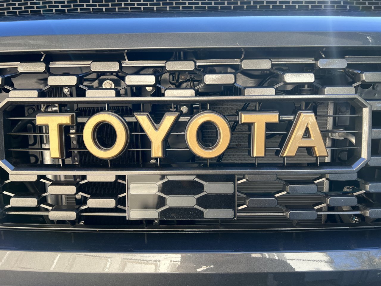

    Finished painting and swapping out the honeycomb pro insert from MC auto parts today. I painted the honeycomb itself body color and the TOYOTA bronze. 57F95618-312C-44ED-930D-FFC51153061A.jpg63AA0DA9-1452-48B1-8BC9-08DEA2864E8A.jpg

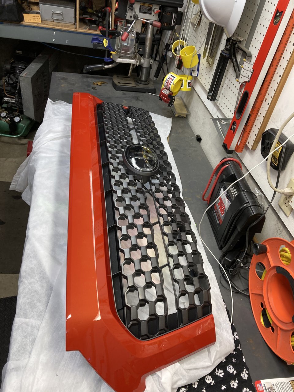

    The center grill insert from MC Auto has the entire “TOYOTA” part assembled but separate from the honeycomb grill. I was hoping the letters would be separate so I could just spray them separate from the black plastic backing they are on. Instead I had to tape off every individual letter. Prep is key so I took my time and it took about 2 hours to tape off all the letters. Still a little overspray on the black plastic part but that was removed with toothpicks and rubbing alcohol. I’ll try to dig up some pictures soon.
  11. Nov 8, 2021 at 11:37 AM
    #41
    TunsofFon
    TunsofFon New Member
    Jun 26, 2021
    #64793
    461
    Pacific NW
    2021 MGM Platinum
    Don’t mind the filthy garage:D
