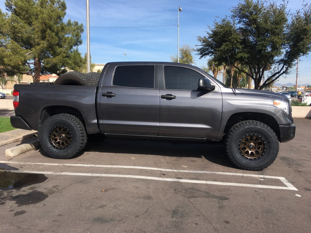

    @nowayout I really like your setup and the bronze SCS wheels. I have a MGM as well and I am thinking about getting the bronze. Quick question on your suspension. What did you add to the rear besides the +2 CB shackle? Anything?

    Teaser. 3/1.75" lift with 37x13.5 tires.

    Bilstein 5100 shocks. Definitely get the bronze

    Looks awesome, I would definitely have to regear if I went 37's even though I live on an island. I sometimes feel the need to regear with the 295's

    Both going with 5.29 soon!
