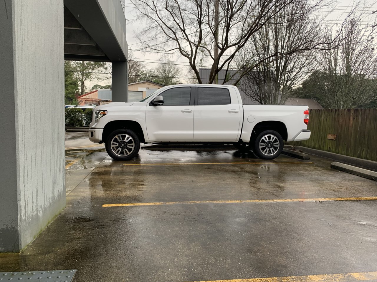

  8. Feb 4, 2019 at 6:11 PM
    #188
    redryder
    redryder New Member
    Nov 8, 2018
    #21482
    203
    Ryder
    Louisiana
    2018 Limited Cement CM
  9. Feb 4, 2019 at 6:58 PM
    #189
    neirbot
    neirbot New Member
    Dec 10, 2018
    #22825
    161
    This is essentially the kit I ordered, and from the same company -- Boss4x4s. Ordering was easy and delivered quickly. Most importantly though, Darren has provided outstanding support prior to purchase when I had a ton of questions, and afterwards as I had questions about install and other things. He's a really patient and knowledgeable guy. Buy with confidence.
