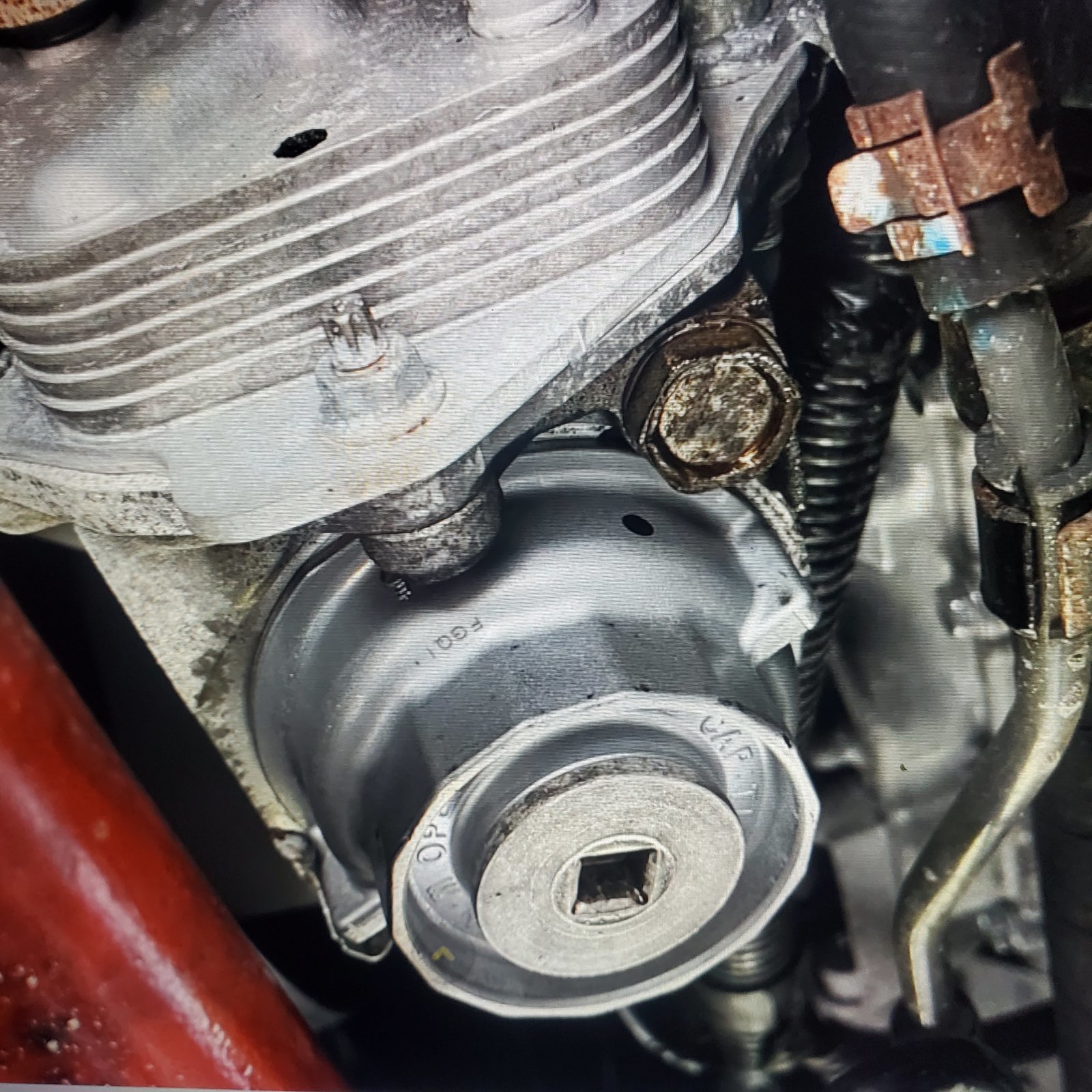

    Thanks...Thinking a simple fix however just wanted to be sure if there is anything under the bolt if removed besides a washer..

    Sorry I don't know never taken it out. Would be interesting to see if anything is behind it. Waiting to see

    Use brake clean and clean it up and see if it comes back. Could be from the last oil change or could be higher up and running down.

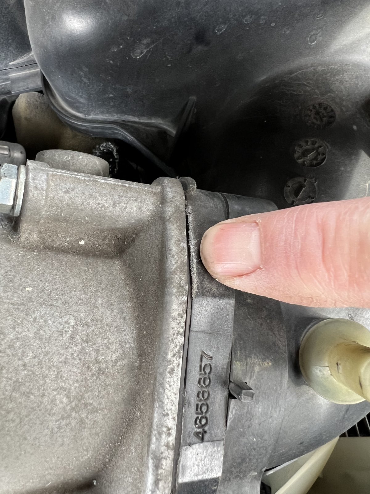

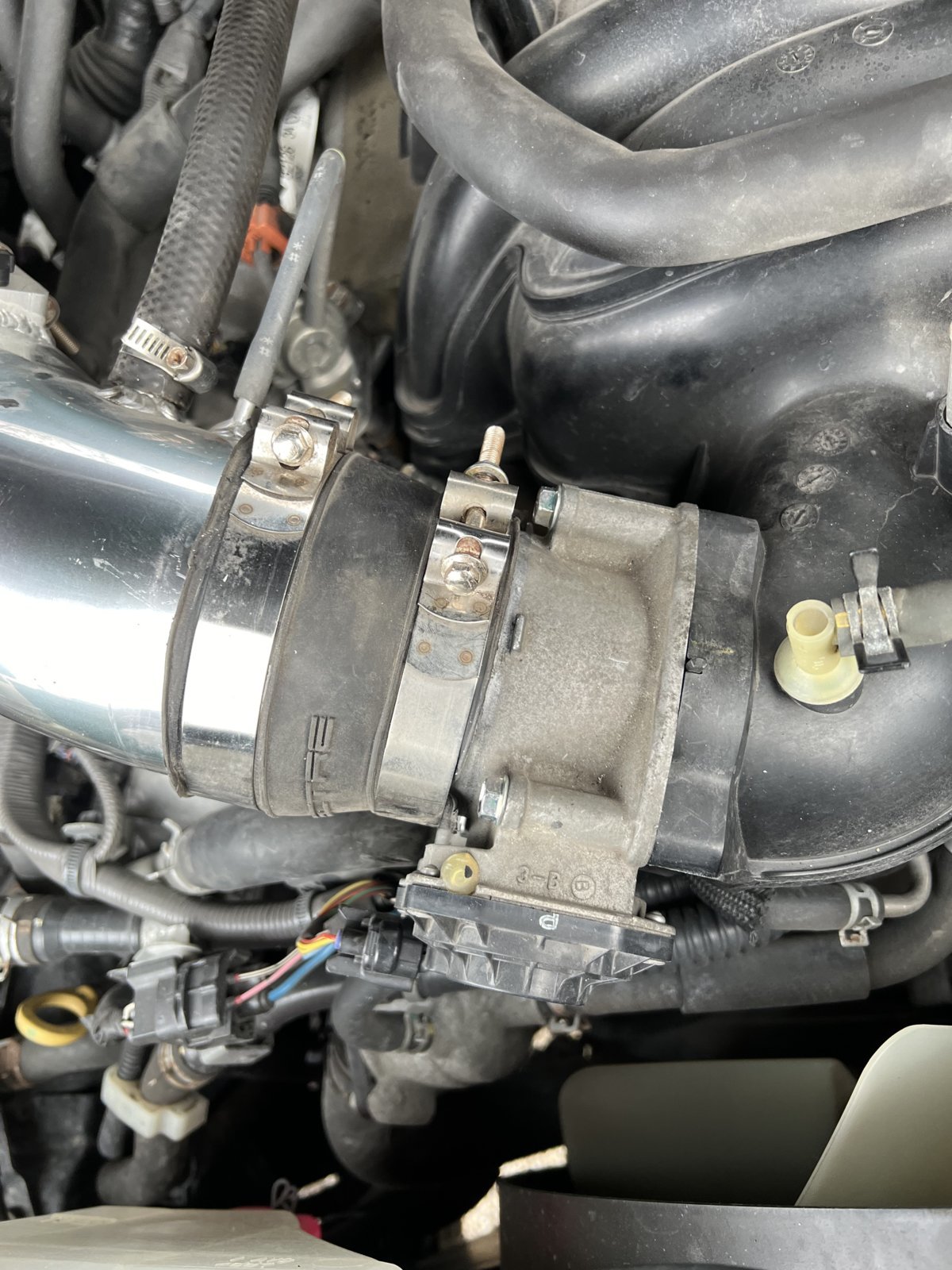

    Update on my check engine light.
    I was at a lost because I put a new MAF sensor on and a new vacuum line on that was cracked. The light was still on. I read it takes 20-50 miles for MAF to reprogram itself. Couple of hundred miles later, still on. Took it to the dealership and he found a gasket leak from the throttle body spacer. So I got a new throttle body gasket and threw away the spacer. It really didn’t make a difference. Now the check engine light is still on. I’ll drive it a little to see if it goes off. IMG_5823.jpg IMG_5825.jpg IMG_5824.jpg

    Can you clear codes? Maybe go back to autozone and have them clear it or invest in a cheap scanner just ro clear codes. If it does come back on put the stock air box back on, clear the codes and see if it comes back. If it does then your looking for another vacuum leak or the MAF is still dirty.

    I put a new MAF sensor on. I would think it is clean. I don’t have the stock air box. Auto Zone said they won’t clear it because of liability concerns. I’ll wait awhile to see if it clears after I drive it some more. I may get a scanner to clear codes.

    If the sensor is new then its clean. Did you use a Toyota MAF? The aftermarket sensors don't play well. If it is a Toyota MAF then start checking for other vacuum leaks.

    Got it at Auto Zone. I’ll check for more leaks for probably the 10th time. Who knows, maybe I’ll find it this time.

    Where is the old MAF? Can you clean it and try it? Likely there was nothing wrong with it. It's pretty rare that they fail.

    I did clean it and tried it again. Nothing. It’s already been replaced and old one thrown away. It was probably good because afterwards the dealership guy found a leak from the throttle body spacer gasket.

    If you have access to a scan tool that shows live data, you may want to look at the fuel trims. In the event there was another leak somewhere the fuel trims would help to show that. A cheap OBDII code reader is worth buying. I have a more advanced one that keeps me busy with helping friends, it was a good investment.

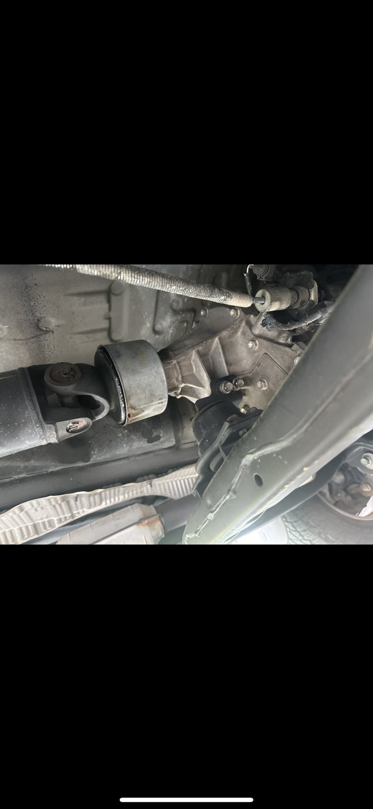

    i just got transmission done , and there a lil fluid dripped everyday , is it normal ? should i worry ? tia

    Not normal. Could have been over filled. Could be bad seal.

    That's the transmission tail shaft seal leaking, so no, not normal. What did you have done to the Trans?

    Tailshaft seal is cheap and easy replacement.
