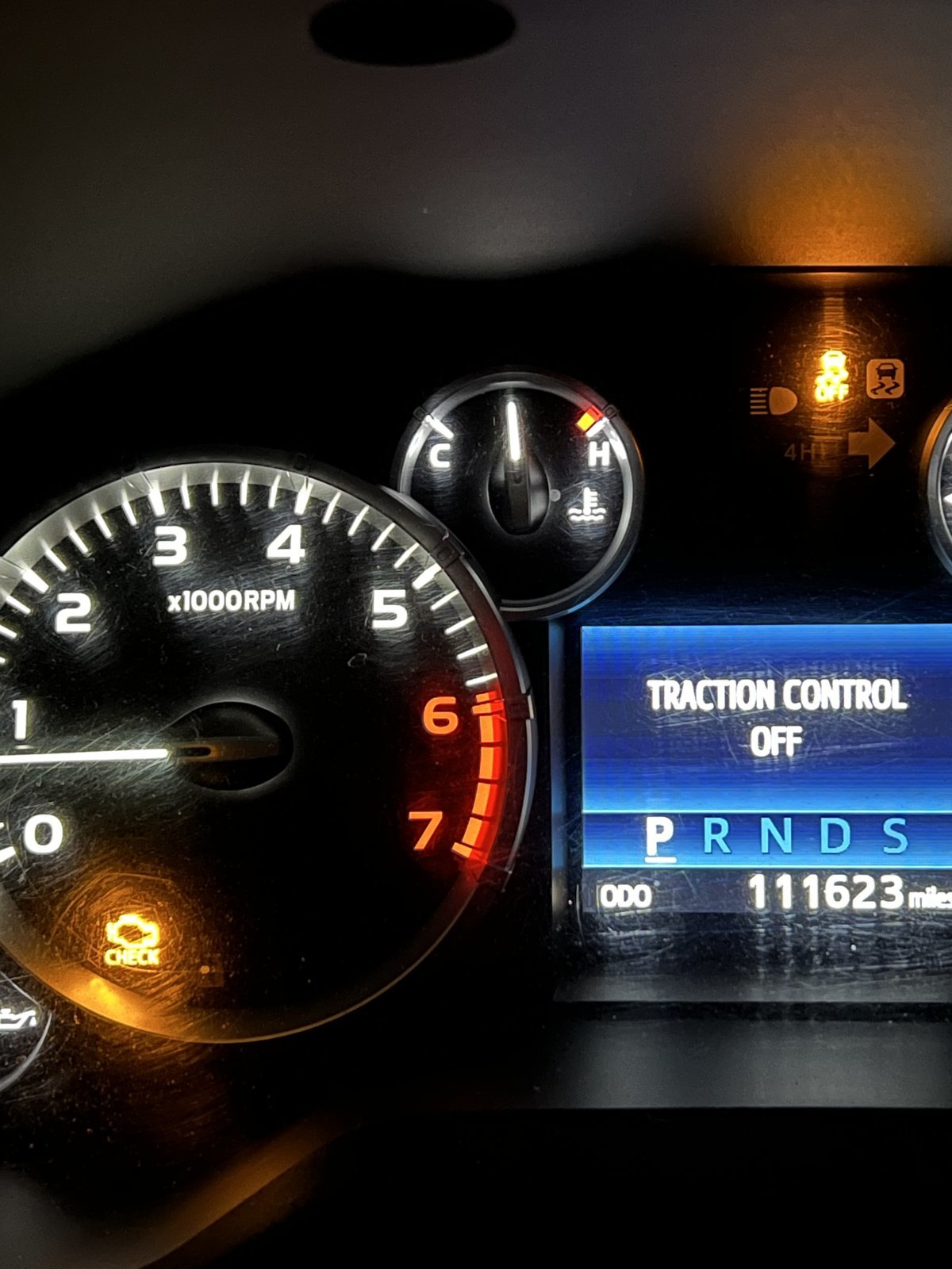

    Got a ? for the mechanic. This popped up on my dash. Truck runs normal. I can also turn the traction control button on and off. Which the indicator shows above the large words. But the large “traction control off” words stay on all the time as well as the check engine light. I’m thinking a sensor? If so, any idea as to where the sensor is? Thank you for any help/information you can give.

    Do you have a way to pull engine codes? The traction light will come on for an engine code. Toyota likes to light up multiple lights that are not even related to the issue.

    No. But I heard/read somewhere Auto Zone will do that for customers. Tomorrow I’ll go to auto zone to see if they do that.

    Yes sir, when you know the code/codes report back.

    Auto Zone did a code scan for me. Check engine light is pO171, PO174 which they said it’s running too lean. They said I need to replace the Mass Air Flow Sensor. Which I ordered.
    Other code was C1201 which they said was the EV Control System Malfunction. They said they’re 4 different possible problems. I need to get it a more detailed scan. It’s really odd that both came on the same time.

    I would look for a vaccum leak before I’d swap out the mass air sensor. You can also do a visual inspection of the mass air sensor for any buildup or debris on the small wires inside. They sell a specific cleaner just for it.

    As already mentioned, check for a vacuum leak. Google how to find a vacuum leak. If you are leak free then clean the mass air flow sensor. Becarefull when you clean it and follow fhe instructions (youtube). Are you running an oiled air filter? They can contaminate the sensor. Remember that the parts store is always going to want to sell you a part.

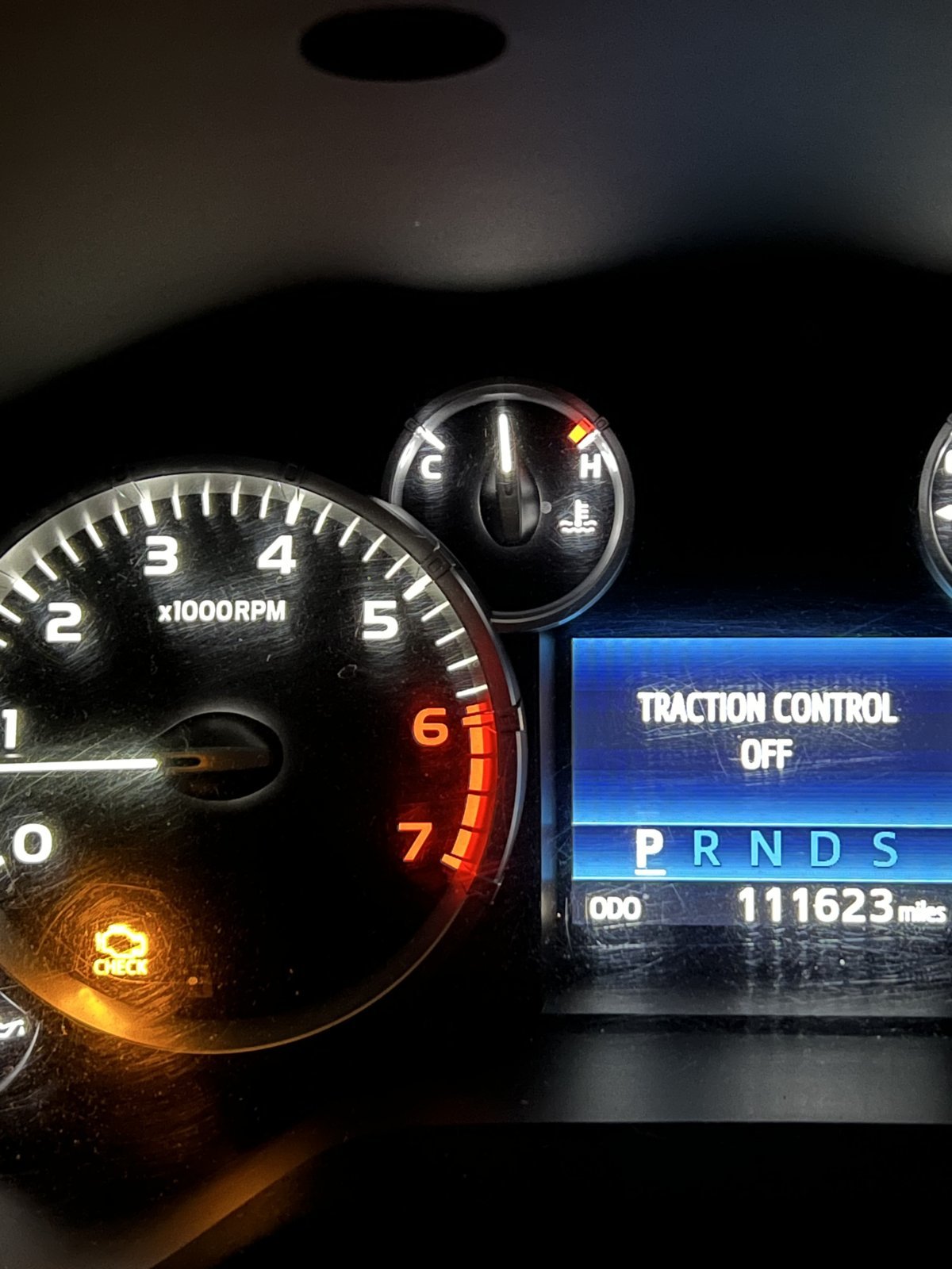

    Check engine light and large words of traction control off was on going to work this morning. When I started the truck up to go to work after our meeting, they didn’t come on. Started truck multiple times and they still didn’t come on. I went to auto zone to get my money back. And got some cleaners for the MAF sensor and throttle body. But, it’s strange that two codes came on the same time and went off the same time.

    Clean the MAF and hopefully it doesn't come back. Are you using an oiled air filter (K&N)?

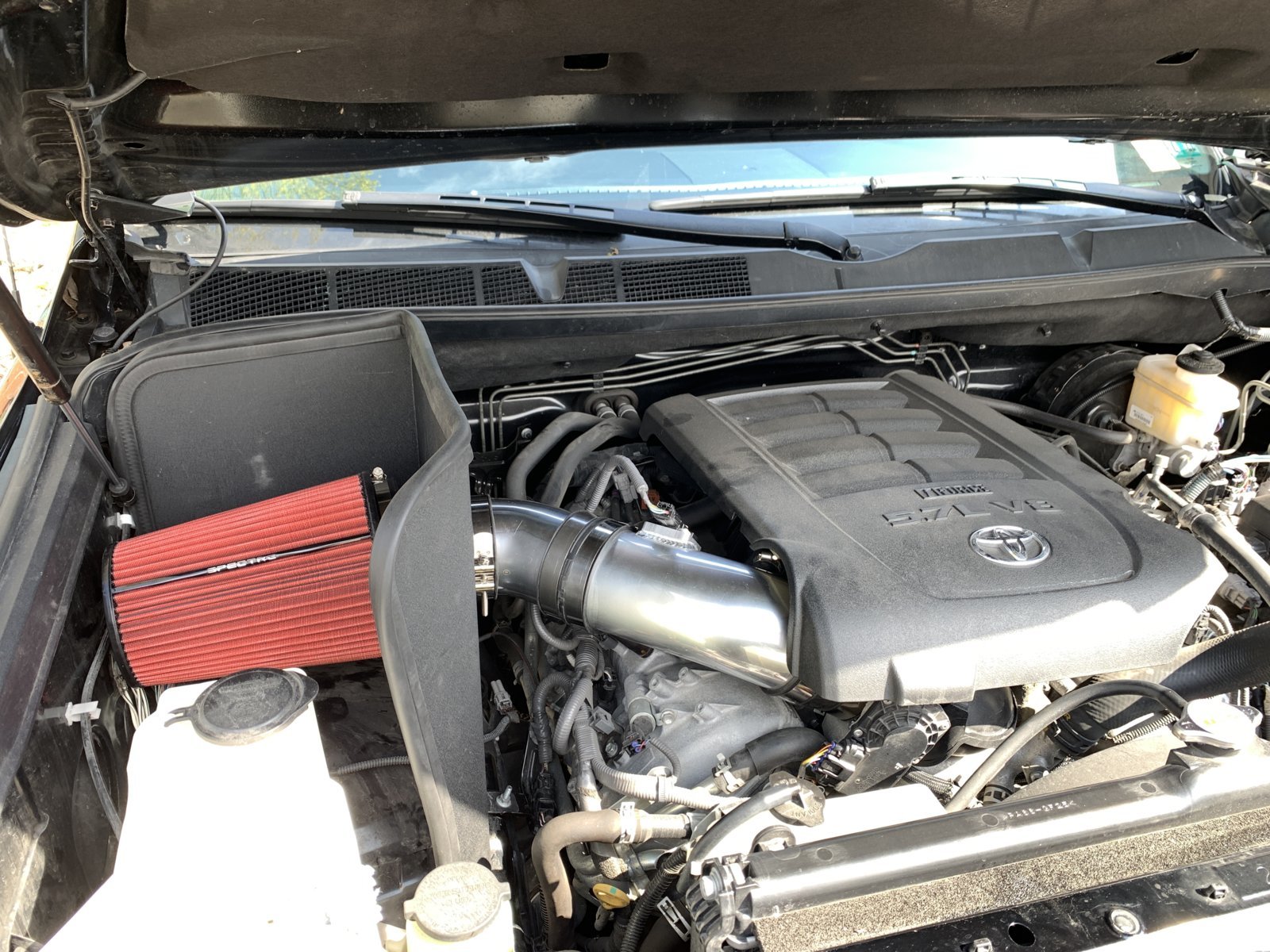

    Should be fine then. On the oiled filters, some of the oil could come off the filter and coat the MAF sensor and would result in a lean condition.

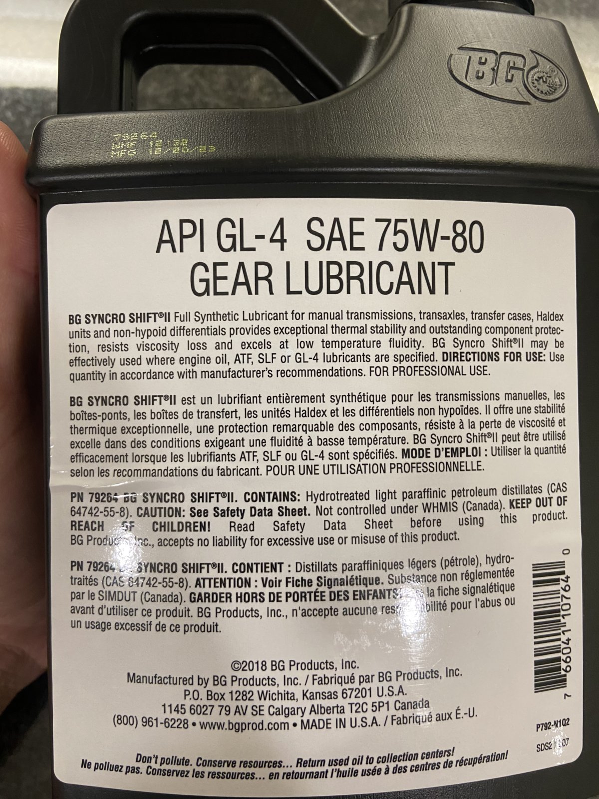

    Can I use this transfer case oil for my 2019 Tundra? My local Toyota dealer sold it to me as he said this is the oil they use for the transfer case. FB51D308-2938-4C76-85D1-458B36776B0A.jpg33E693BB-680A-4FE3-A03F-9C579AE2FE45.jpg

    It should be fine. The transfer case calls for a GL4 oil which this is but also calls for a 75W oil. The oil you are showing is a 75W80 so going into 4WD may be slightly slower engaging if you live in a cold climate.

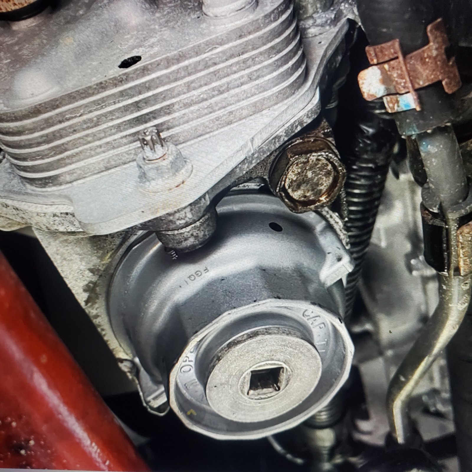

    What is this hex bolt on the oil filter housing, that's leaking ? Can't find it in parts diagrams. 2016 & 2021 Tundra, 5.7. Thanks
