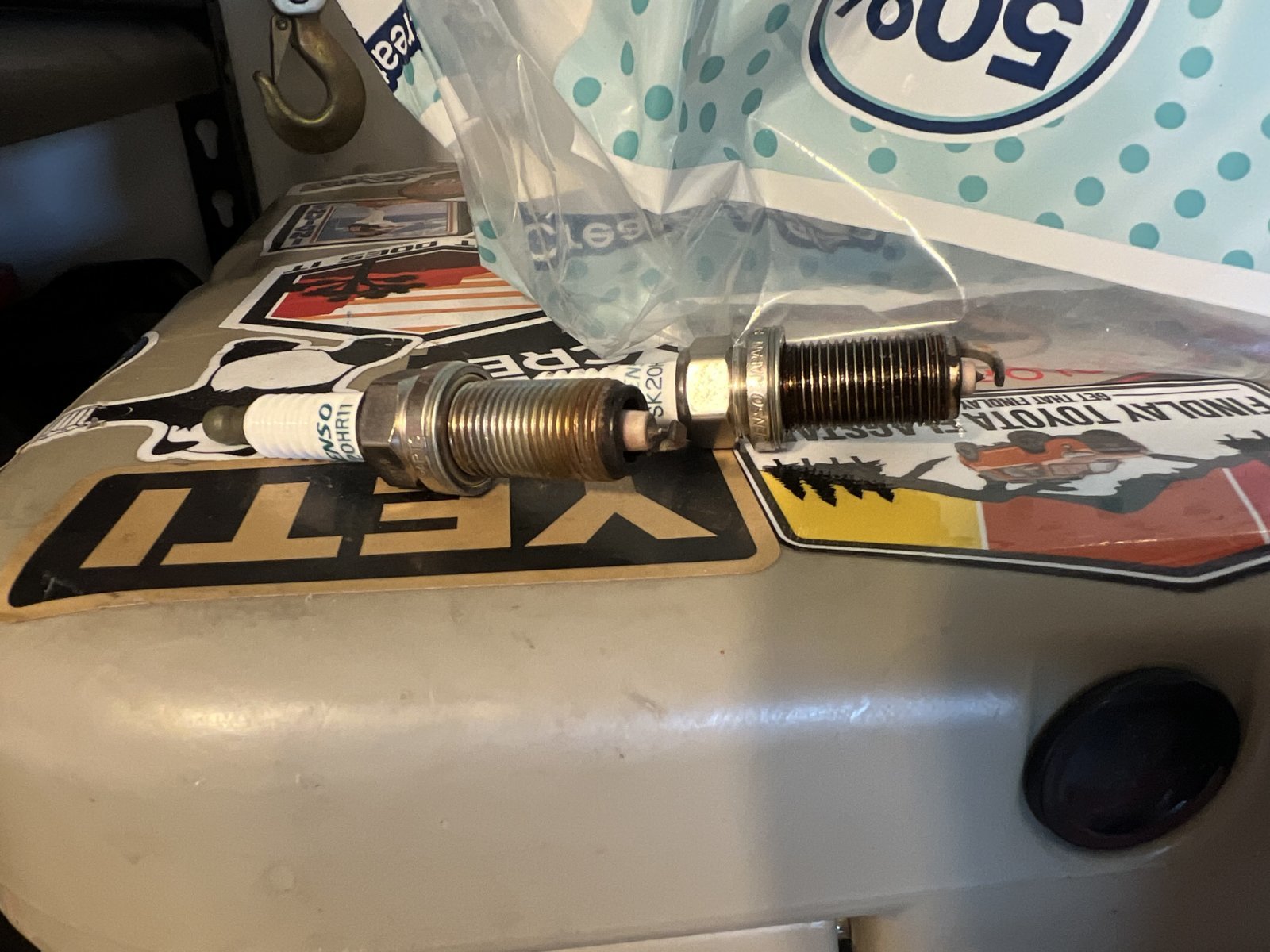

    AZBoatHauler
    Aug 13, 2019
    #34576
    9,203
    So.Arizona
    @Ruggybuggy - you ever come across this with the 5.7? Changing spark plugs on the LandCruiser and found the plug in the #7 cylinder with oil coating the threads. The test seemed normal. 103k miles and no symptoms…
  5. Dec 7, 2023 at 9:15 PM
    #2885
    Ruggybuggy
    Ruggybuggy Seasoned Veteran
    Sep 23, 2019
    #36508
    3,747
    Dave
    NW ON, CANADA
    2016 Tundra OR
    Did you look in the tube and see if it was dry? Are they the original plugs?
    AZBoatHauler[QUOTED] likes this.
  6. Dec 7, 2023 at 9:44 PM
    #2886
    AZBoatHauler
    Aug 13, 2019
    #34576
    9,203
    So.Arizona
    Yes, original plugs. Tubed looked clean from what I could see.
  7. Dec 7, 2023 at 10:30 PM
    #2887
    Ruggybuggy
    Sep 23, 2019
    #36508
    3,747
    Dave
    NW ON, CANADA
    2016 Tundra OR
    Either the tube had some oil in it or someone had that one out and put something on the threads. If it was from the combustion chamber the tip should show some evidence of oil burning.

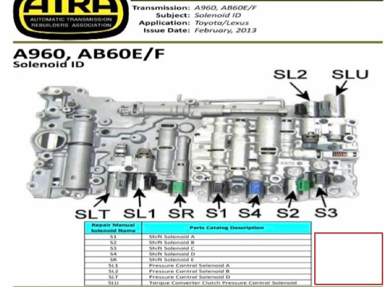

  17. Dec 22, 2023 at 6:10 PM
    #2897
    c24680
    c24680 New Member
    Apr 22, 2023
    #95871
    55
    Craig
    KY
    08 Silver Tundra Crew
    I am either not googling correctly or not smart enough to figure out the parts numbers for the AB60F Solenoids. Is it possible for someone to get the parts code to order? In the picture maybe in the red box to the right?
    main thing for me is S4 and maybe SL2
  18. Dec 22, 2023 at 10:36 PM
    #2898
    Bigsew22
    Bigsew22 New Member
    Dec 20, 2023
    #108766
    5
    Wes
    Tundra 2012
    Toyota will not give you part numbers. You have to go up to parts department and pull up the diagram on there computer and cross reference. It was difficult for me as well. I am replacing SLT, S4, S3 and SR. They are not cheap either. Those 4 solenoids cost me $1,500. If you replace all of them it will cost you around $3,000. A OH transmission from Toyota costs $3,500 - $4,000. However, the transmissions are on back order and have been for over a year. The parts department in Houston showed 108 customers are waiting on back order. Toyota charges around $6000-$7000 installed.
