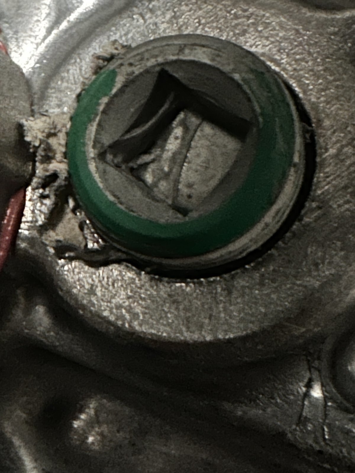

    I dont know about previous gen, but from how the pictures are, looking at it on the truck, looks to me to be the plug type.

    The reason I mentioned am the previous gen is because they are pipe tread. If the 3rd gen used a pipe thread aluminum plug I could see replacing. If your regular plugs with gasket is made from steel I couldn’t see any reason you would need to replace.

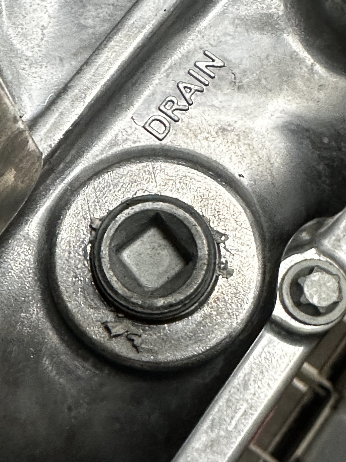

    Here are the plugs, look aluminum

    That's pipe thread. Did you try a magnet to confirm it's aluminum?

    It is magnetic, so one would think you can reuse, just wonder why Toyota says to install a new one.

    Theory: Toyota normally installs them so tightly that they usually get messed up upon removal. Replacing them enables the next person to actually remove the plug the following service.:rofl:

    Then I would just reuse the old plugs. It's the exact same design as the previous gen and the plug are reusable. Make sure to use thread sealer on the plugs are don't over tighten (pipe thread).

    The problem is people forget these plugs only need to be snug not ugga-dugga tight
