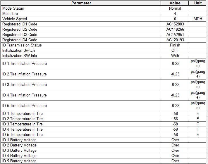

    Anyways, my question:
    My TPMS light has been illuminated ever since I went to 2014 Limited Wheels.
    I have replaced the antenna and all (4) TPMS sensors in each wheel. I have reprogrammed the TPMS via Techstream an unhealthy amount of times.
    Where do I go from here?

    Use Techstream to read the error codes in the TMPS Ecu.
    Use Techstream to look at the live data in the TMPS Ecu, are your sensor actually sending in good data to the ECU?

    I'm not entirely sure where the the TPMS ECU error menu is. I'll look when I get home.
    As far as the live data, that is what is odd. It only sends (2) TPMS sensors to the ECU. I can swap them around by adding them in different order, but it will never send all 4. Just 2 at a time with correct pressures. The others stay dead.
    The odd thing is, this only happened after I swapped out my 2007 TSS Chrome wheels. Everything worked great up until then. I should have swapped sensors, but figured new ones would work.

    Just getting in on this but let's keep everything simple. Do you have Techstream? If you do then you will see a tpms module listed. Do you have the ID numbers from the tire sensors? You need those numbers if you plan to program your sensors to the tpms module. Also tpms sensors need to be "woken up" by let air put or adding air to the tires.
  16. Nov 18, 2023 at 6:36 AM
    #2836
    minter66
    minter66 2007 TSS CrewMax
    Jan 29, 2019
    #25273
    522
    I have techstream and each modules ID.
    What I didn’t know is that each module had to be “woken up” prior to programming. I’ll let about 5 psi air out and then try to program each one.
    I have programmed these a million times it feels like, but usually only two make it into the ECU

    How did you find the tpms sensor IDs? Open up techstream and look at the live data for the tpms module. Air down one tire and a time and see which tire on the live data is responding. You will find out which tpms sensors are not responding. The only reasons a sensor will not respond is because the 1) the tpms sensor ID number does not match the tpms module ID number 2) the battery is dead in the tpms sensor 3) the tpms sensor has been damaged or doesn't exist 4) the tpms sensor is a different frequency (Toyota used different frequency tpms sensors).

    I bought brand new sensors and wrote down the ids before putting them on the wheels.
    Currently, I’m trying to remember, but I think even with the correct IDs they read negative tire pressure. When I get home I’ll hook up my laptop and get a screenshot
    Do you know the part number by chance? Is it different from 2007 to 2014?

    So when you saw the ID numbers in techstream did they match the ID numbers that you wrote down? Where did you buy the tpms sensors?
    I believe they are different part numbers from 07 and 14 but check on any Toyota website that sells parts.

    the part numbers I wrote down are what I entered in techstream. So they matched.
    I bought these : TOYOTA OEM Tire Pressure Monitoring System (TPMS) Transmitter (FCC ID: GQ4-45T, P/N: 42607-0C070) https://www.amazon.com/dp/B01E612UBK
    They are the same part for 2007 as 2014

    -0.23 on all sensors. I just updated to Techstream 18 and re-input all sensor ID's

    2016 Tundra OR
    What happens when you let air out of the tires? If nothing then the sensors are at fault. Personally I wouldn't buy any toyota parts off Amazon. There are so many counterfeit parts being sold on ebay and Amazon. The only way to know for sure that your buying genuine Toyota parts is from the dealer.

    #25273
    522
    If these are fake, then I am impressed. Even Discount Tire could read them with their TPMs wireless reader.
  27. Nov 18, 2023 at 5:39 PM
    #2847
    Ruggybuggy
    Ruggybuggy Seasoned Veteran
    Sep 23, 2019
    #36508
    3,692
    Dave
    NW ON, CANADA
    2016 Tundra OR
    How could Discount Tire read them but you can't read them on Techstream? If they used a hand held tpms reader that they read the the sensor information, it doesn't mean that they would still work on your truck. If the IDs are correct in Techstream then the tpms module would be able to read them unless they are not correct for your application.
