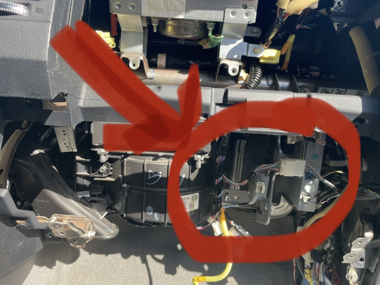

    Does anyone know where the IJ4 joining wire harness is located? I can find IJ1, 2, and 3. But not 4.

    Hi folks,
    Love my Tundra and Toyotas in general. Currently attempting to replace Body Control Module (part number 896700C011).
    Have removed everything on the dash and can’t find this part on my truck. Seems crazy. It should where I identified on the picture.
    Symptoms are intermittent door lock issues (EXCEPT drivers side door which always works) very quick battery drain. Power is good to master swish on drivers side door.
    11 Tundra 5.7L Platinum RWD
