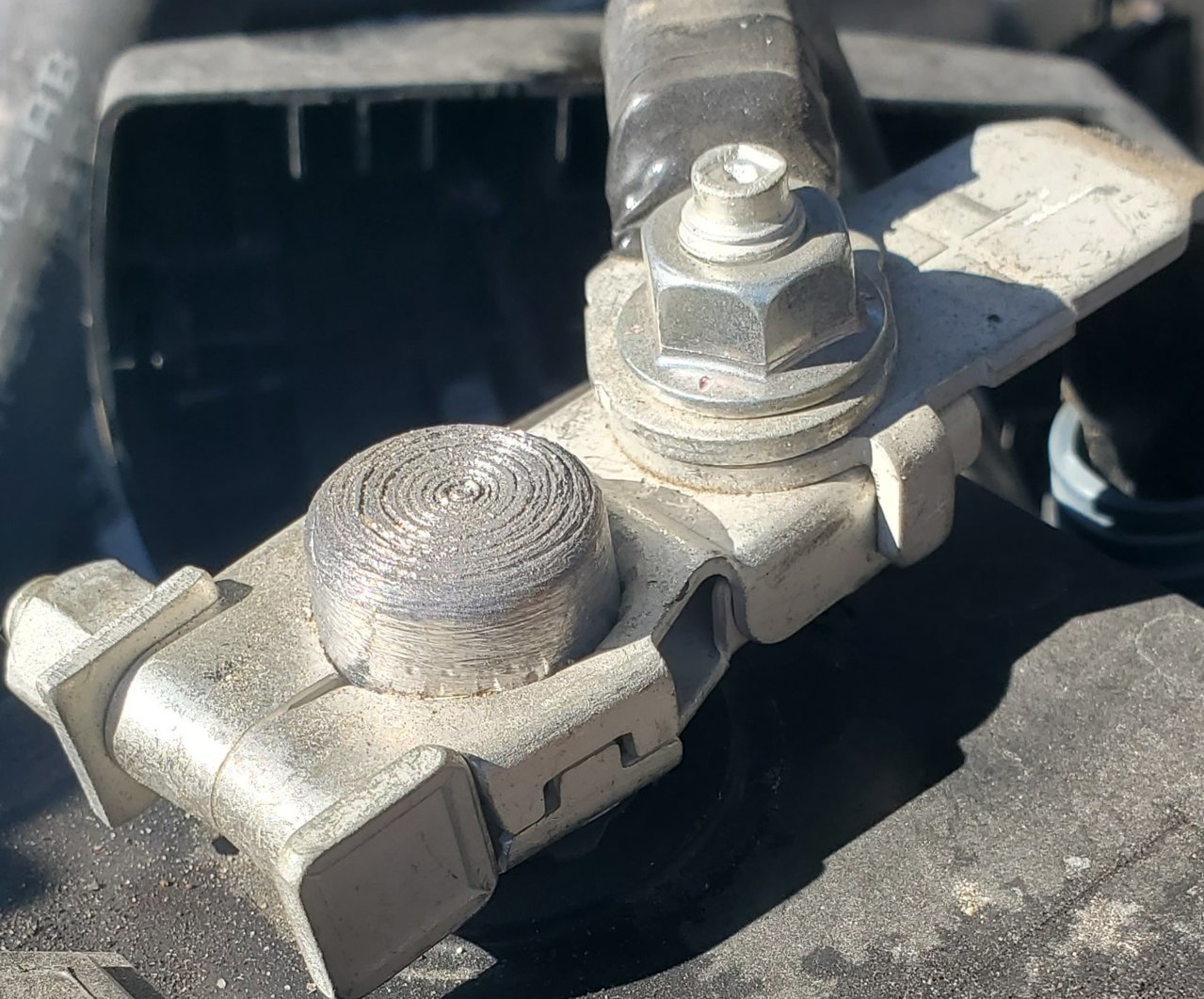

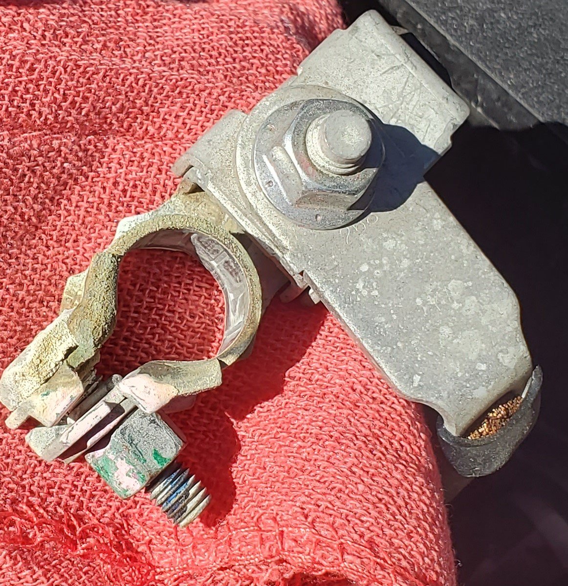

    battery terminals looked pretty good. positive was clean and I didn't take it off. brushed the negative terminal and clamp. after disconnecting the battery and starting it normally (twice), remote start seems not to be working.

    Why don't you just take it in? You have warranty left.

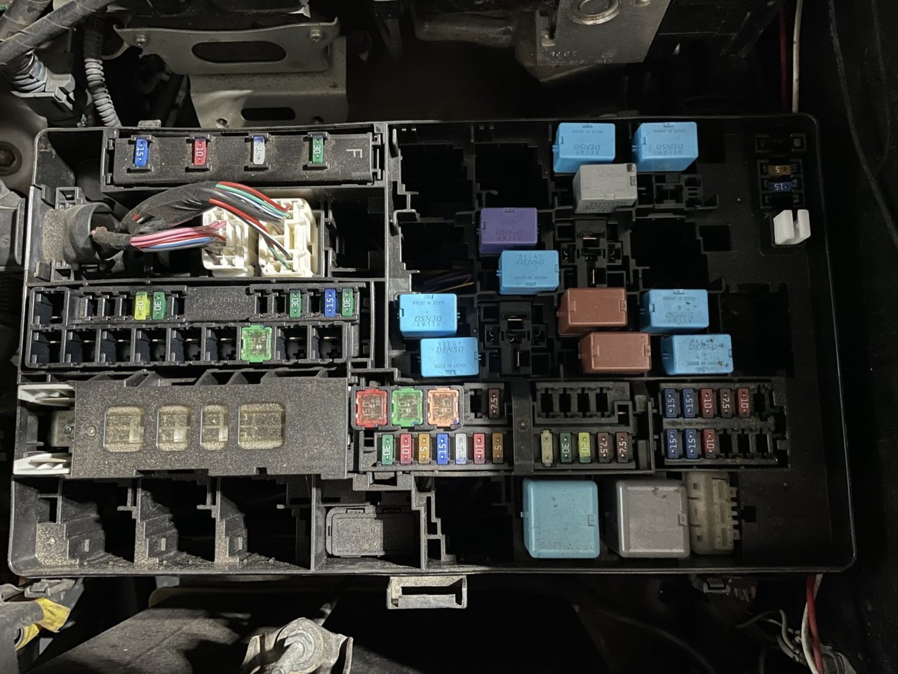

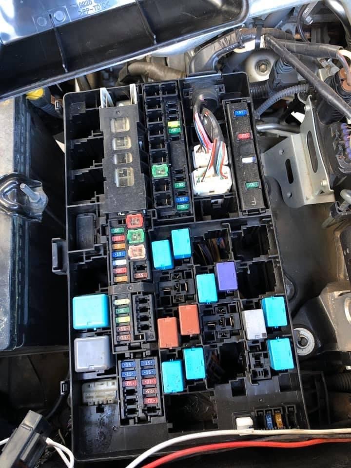

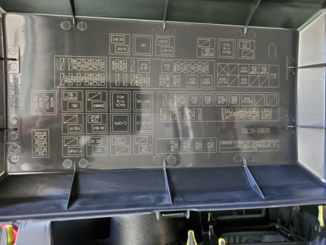

    So I’m trying to install Fog Lights in to my SR.
    I’ve got the Fog lights in and am now trying to put in a Relay so I can than put the new light/fog light switch.
    I’m using this forum post as an example: https://www.tundras.com/threads/adding-fog-lights-on-tundras-without-them.5098/#post-73034
    But the issue I’m having is there is no place to put the relay in into the fuse box.
    I know i can technically hard wire the fogs into an empty slot on dash, but would really like to control it from the column.
    Anyone have any experience with this? It’s a 2014 SR 4.0 V6 DC

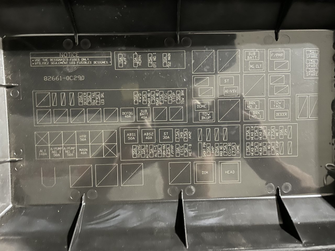

    It doesnt appear to be the same power distribution center. I no longer have access to Toyota wiring diagrams so I'll rely on you. :D

    Here’s a better look at the fuse box and cover
  16. Jan 20, 2022 at 12:27 PM

    i am not sure if that really answers my question… my truck has the wiring for the fogs at the bumper, but where is it going to in the fuse box? I’ve found the OEM relay diagrams and there’s supposed to be a fog slot right around the “Sub batt“ and “MG CLT” for the relay, but my truck doesn’t have it. Are the wires just tucked somewhere under the fuse box?
    would they be going under the dash for any reason to be installed directly to a switch? I havent looked under the dash yet
    The truck was bought brand new so there’s no worry that someone did something weird.

    Your going to have to get a wiring diagram for the exterior lights. You can then dig up were the wires go to by color and doing a few continuity tests using an multimeter you should be able to see what's going on.

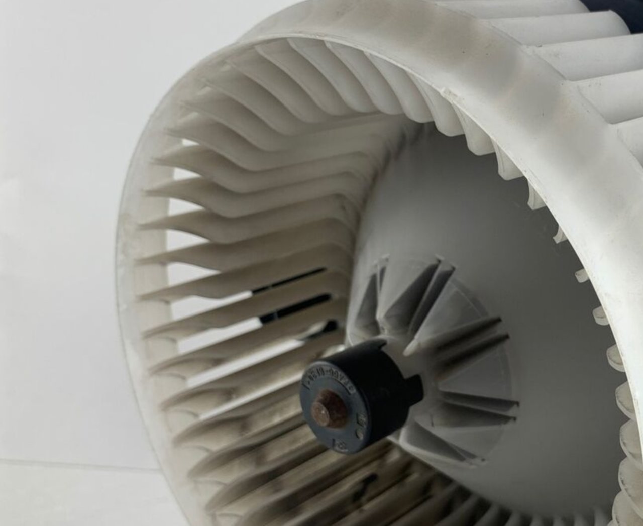

    Is there a particular method to remove the squirrel cage from a Toyota blower motor? This is my first time seeing one with this sort of plastic clip on top. I took it out to clean it and got water on the shaft. I'm pulling it apart to re-grease the bearings. When I was cleaning it I wasn't careful enough and sprayed a bunch of copper colored grease out of the top of the motor (under the squirrel cage). After a few hours of operation it started to make a slight grinding sound.
    Also is there a particular type of grease to use? If I need to replace it, who is the OEM manufacturer? Screen Shot 2022-02-03 at 17.55.51.jpg

    Mine didn’t look like that. When mine quit I checked with Napa but the OEM Toyota part was cheaper and better built. I think it was made by Denso

    When we get the part from Toyota it already has the fan attached. It's considered a non serviceable part. I have take some apart but it take two people. One person holds the fan on the sides with both hand and the second person uses a small punch and hammer to tap on the shaft motor. Make sure the motor false onto something soft.

    Thanks! I used 6 2x4s to build a little stand and tapped it off with a punch and hammer. Cleaned it up and put a drop of gun oil where the shaft hits the plastic on each side and the slight drag noise went away. We'll see how long it lasts, seems like it took care of my previous mistake.
    EDIT: If anyone else does this be careful of the metal tabs that go in the plug spot when taking it apart. Mine were jammed up against a piece of the wood and bent a little.
    EDIT2: @bfunke I think it depends on the generation. When i started pulling it apart I found a Toyota & Denso sticker.
    EDIT3: Well, that didn't last long. It seemed to be fine when i put it in, ran for 20 min on low/medium setting. Turned it to high setting and it burnt out. Ordering a new OEM unit.
