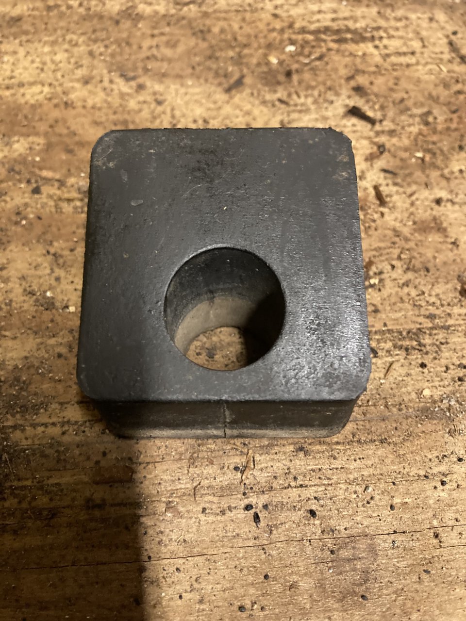

    I’m in MD and my Dad lives in AL
    Yes TOO Dam far to help him out with any issues gets me very frustrated
    He sent me this photo of a hard plastic block that fell out of his RAV4 after backing off his Ramps from an oil change
    He says there are some push pin fasteners missing out of his lower bumper guard to skid plate area
    I believe it could be some kind of isolation block between frame and guards ??
    Any ideas / help with what the part is and were it goes would be GREATLY be APPRECIATED !!

    I would bet he has plastic ramps...There is a plastic foot on the bottom of those that look just like that.

    I don't recognize the part. Hard to see what size it is because there is nothing to reference it to. It's probably not for the vehicle. He noticed the push pins missing and thought and the plastic plate hanging and though that they were related. Those pins go missing all the time. People tend hit the plastics from when backing up and catch the plastics and pull the pins out. Around here it's usually snow banks but I could see a set of ramps catching them.

    That is the grip foot insert for the ramps.

    THX- for the reply’s !

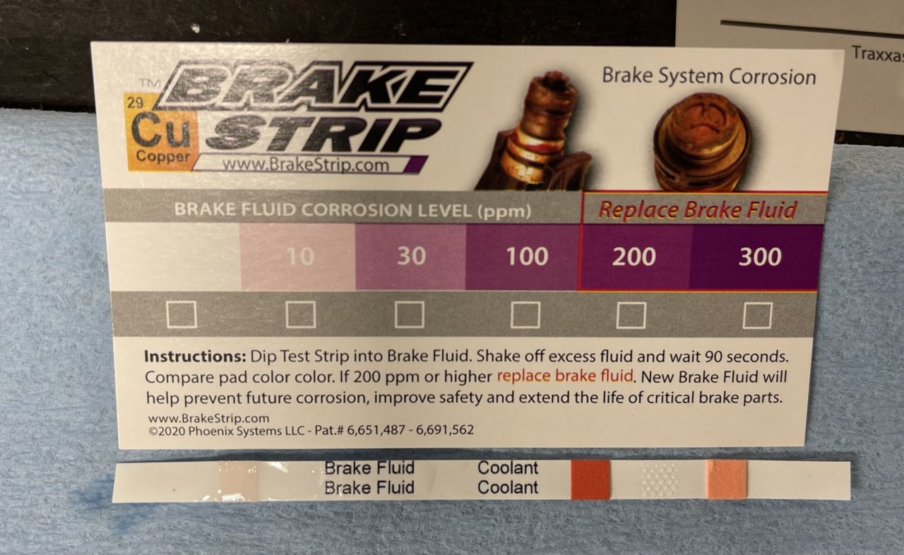

    Although not a mechanic I can tell you changing brake fluid when the color starts to get dark or simply just when your maintenance schedule recommends it is often overlooked. Brake fliud holds moisture and if not changed often enough can cause rust to form on any ferrous metal inside the system.

    Exactly. Most leaks at calipers, wheel cylinders (not Tundra) and master cylinders are caused by water in the system that corrodes the inside wall and allows brake fluid to get by the sealing surface. Using a brake fluid test strips is a good method to show water absorption.

    Do the test strips work well?
    I picked some up off Amazon and tried one last weekend. Since my truck lives outside, I expected the fluid to be more contaminated after 2+ years. 6C662803-9B19-4ED1-A71D-7ABD44A98DB2.jpg

    They do work. Your brake system is a sealed system so after only two years it's unlikely the fluid would be contaminated even with the truck outside. Usually after 5 years I would start testing.

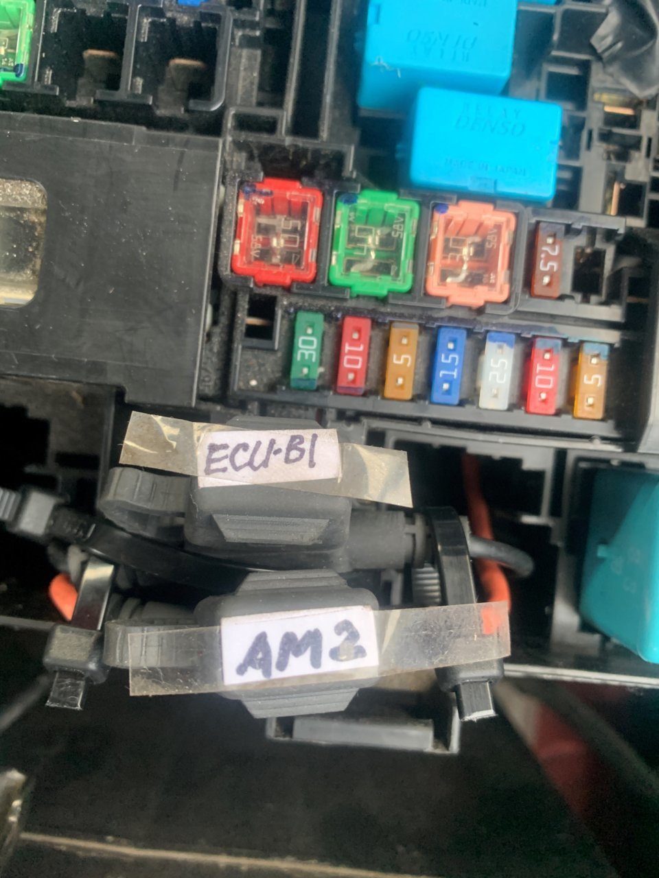

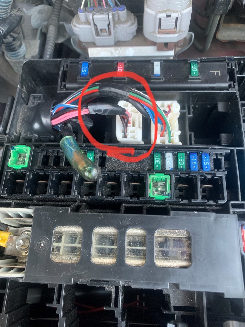

    Hi!
    I've been dealing with ignition start problem since I had my autostart fail.
    When I purchased my truck, I had the dealer install an autostart at the time of purchase. Looking at what they did, it seems that they used an aftermarket autostart and used a "hack" to install it. :(
    When my mechanic opened up the steering column and looked at where the wires connected. My mechanic managed to straighten out the mess there, but we were still getting the intermitten start. When checking the engine compartment main fuse box, it was discovered that the wires for fuse's "ECU-B1" and "AM2" were short. They were not making 100 percent contact with the contacts. Also it seemed the contacts themselves seemed to be damaged at some point. The mechanic added and replaced wire/fuse's. So after that was done, I was still getting the intermitten start. :confused:
    When I mention intermittent start, I'm meaning when the key is inserted and turn to start the truck. I'm not getting any instrument gauge lights. Accesories turn on such as the radio. The engine will crank but no fuel is running. If I jiggle the wire with the connector that I've circled in red in the attached pic. It will eventually allow the instrument cluster lights to turn on allowing me to start the truck. So I'm on my wits end. Would you have any suggestions on how I can fix this? Did I overlook something? Any help would be greatly appreciated!

    If a Toyota dealer did this, they need to be reported to Corporate. That's ridiculous!

    They were reported to corporate for another instance at which point thier license to sell vehicles was pulled for a couple of months.

    It would be really tough for me to diag this on a forum. Since the problem seems to be related to the power distribution box and it's damaged anyways can you find a used one and replace it?
